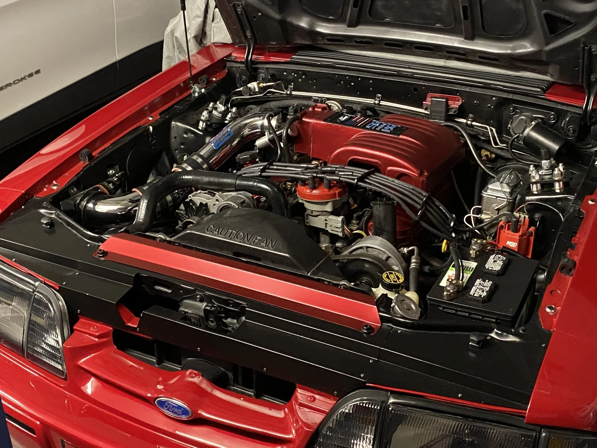

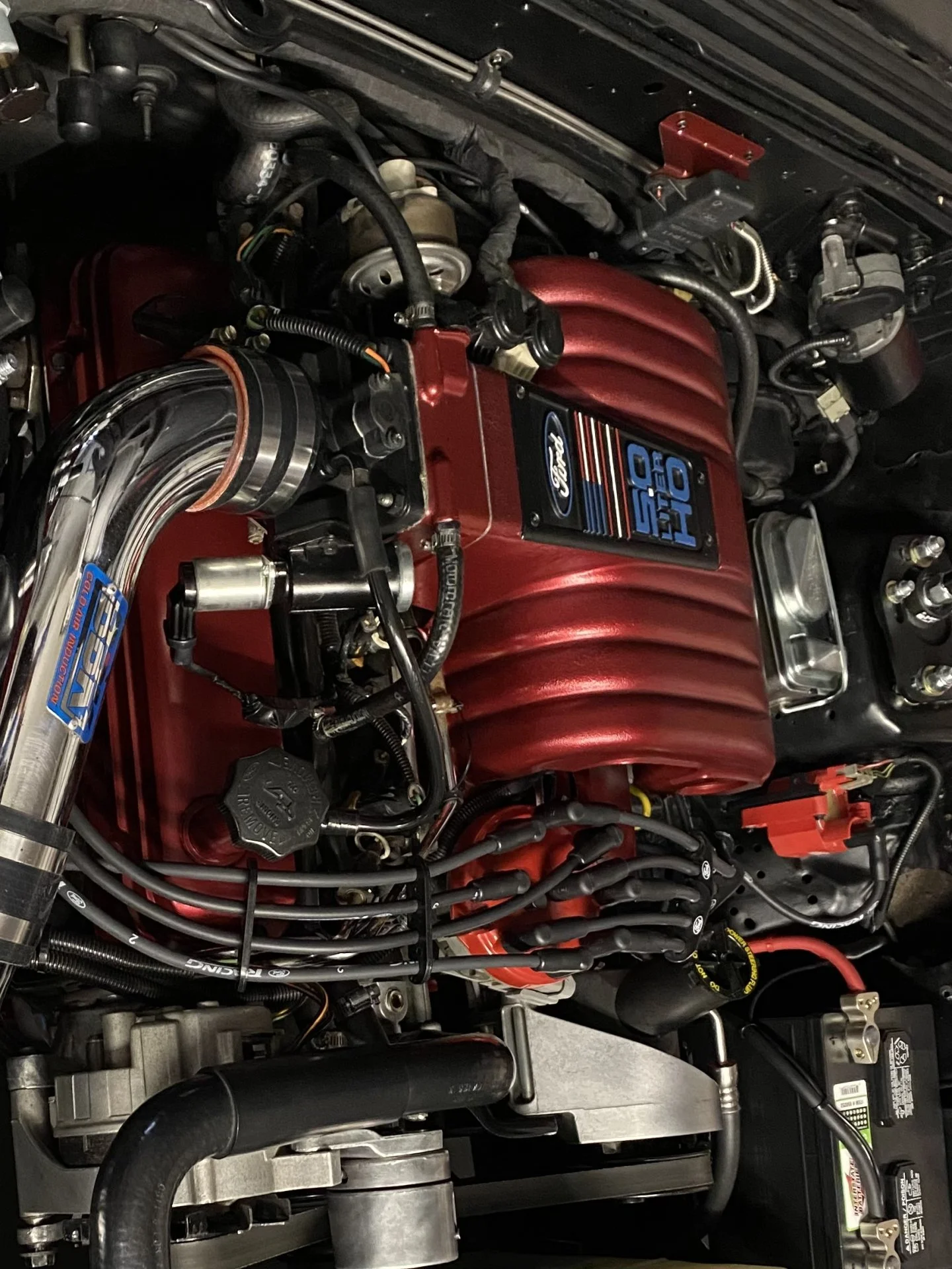

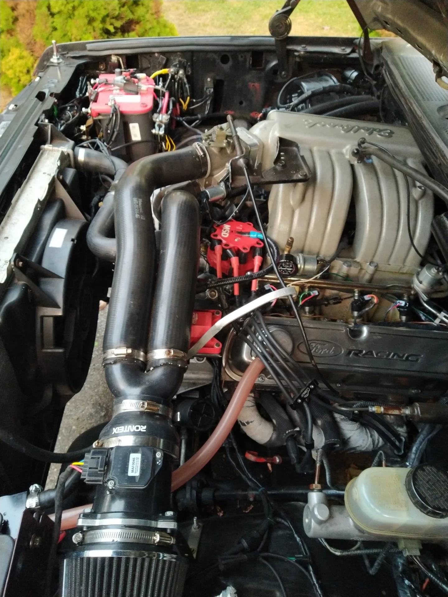

Any pictures here of some nice looms being used???

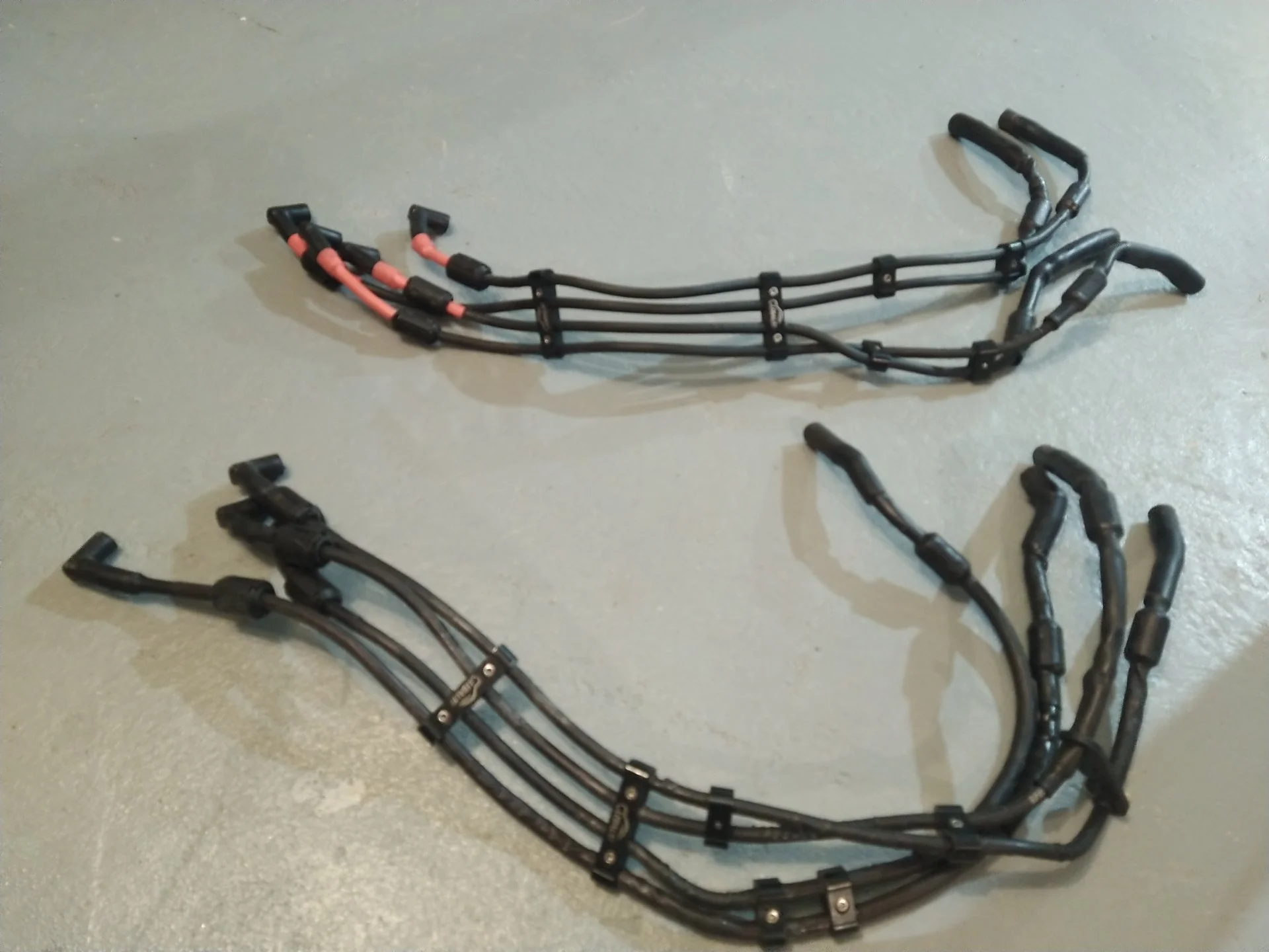

Depends on the headers.... I hate equal length shorties, I've seen so many burned wires from those so boots help there and on turbo set ups. Rest I just us the cheap plastic separaters that bolt to the vale cover.. Taylor, made4you, summit few other brands make them.

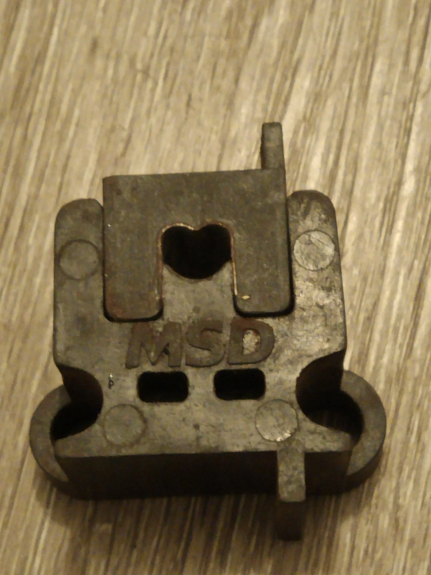

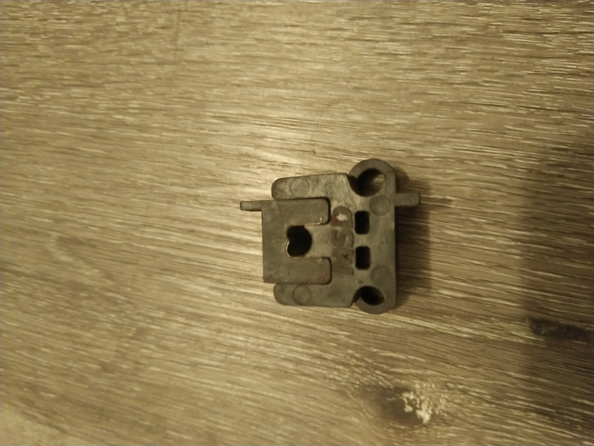

Do these work?

  • Nov 7, 2022
For the most part... But you need to make or recrimp your wires after putting them on.. Most have a ring that the plug boot won't fit threw, I'd look at reviews on them since there is a ton of super cheap China made ones , some are decent some are junk.
I use the Anodized aluminum ones seeings Anodize doesnt conduct electricity plus I wrap my wires and boots with EMI blocker shrink tubing too plus I also cut down on the ignition interference with Ferrite Bead Chokes...
The shrink tubing also blocks out moisture too...........Red boots for Bank 1 and Black boots for Bank 2
I use the simple plastic Ford Racing ones. Effective, and they look nice.

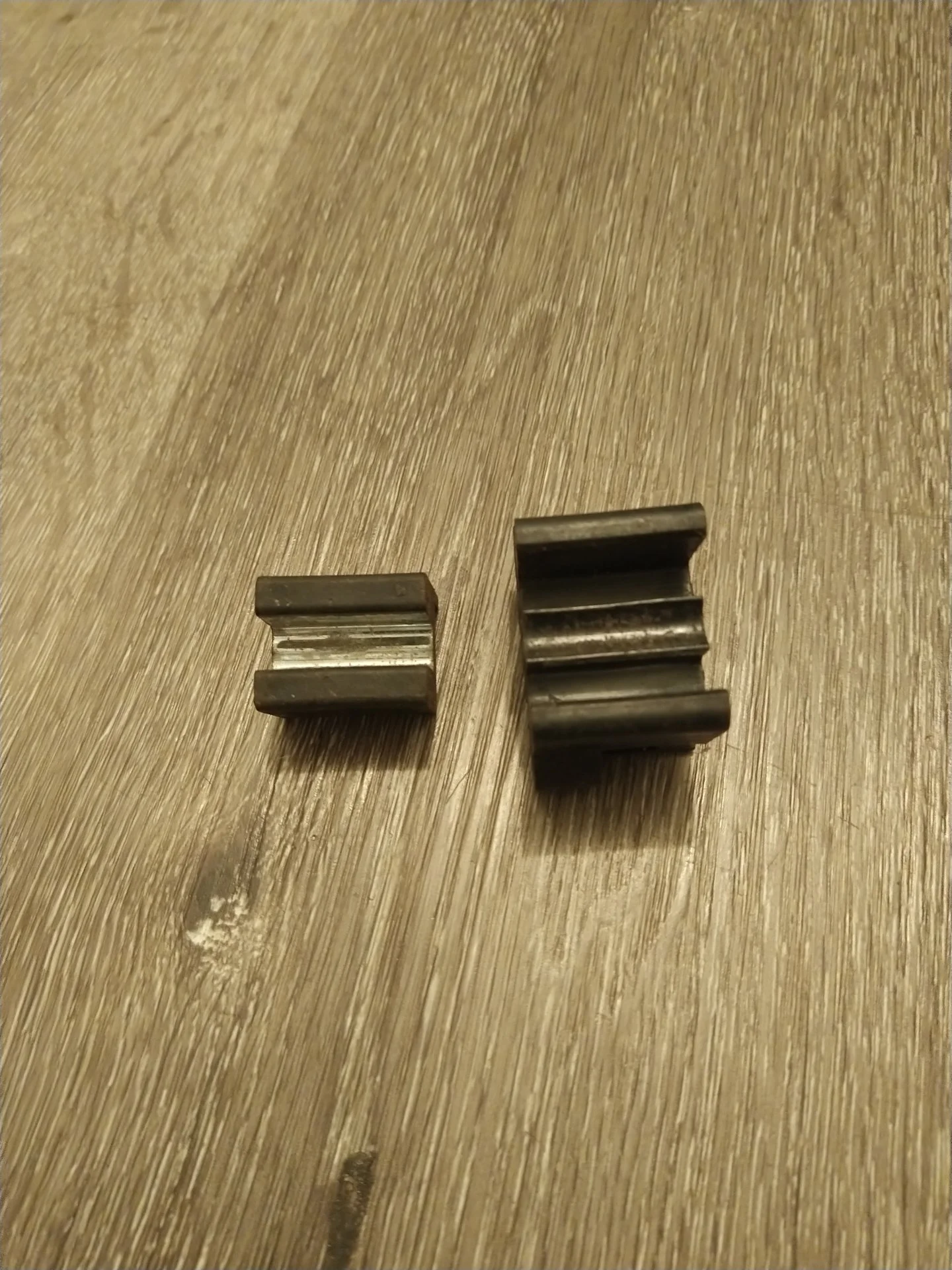

I just pull the boots off and use a teeny tiny dab of Di-Electric grease to reinstall them effortlessly....
If I do have to recrimp the plug ends to the wires I have one of these....It works in a vise ...Makes perfect and tight crimps everytime...
