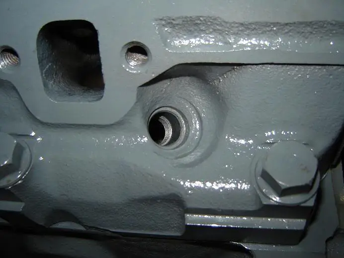

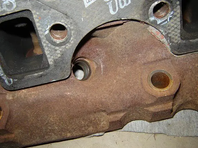

I bought a new long block last weekend that is supposedly the exact same motor for my 87 mustang GT 5.0 HO. I went to kragens the other day and bought new plugs for an 87 mustang gt. I tried to put them in and they dont fit. Its like the threads are too deep. I looked at my old heads and they fit prefectly. The threads are closer to the opening. Whats wrong here!?!?!
New heads
Old Heads
it says 91 on one corner and I think S on the other corner of the heads. I am assuming my old heads were stock and I got the stock plugs and they fit into my old heads so something is wrond with these new heads

Just going off of the picture the new heads look different than the old. Those exhaust ports look tiny in comparison.
If indeed the engine was supposed to be an 87 h.o. longblock and turns out to be otherwise…..I'd ask for my money back.

The guy told me it was an 87 HO GT longblock so I am assuming all the internals are for an HO GT. If the pistons, cam, and the rest of the internals were for an 87, would they work on these 86 heads?
Could someone with these 86 heads tell me what your numbers read on the top corners of the heads and if your valve covers are off the numbers in the top of the heads too?
