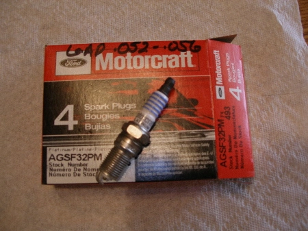

Rocketman said:
Best plug for a N/A Mustang
How do these compare to the AGSF32C's?

Since the beginnings of the Internal Combustion Engine, snake oil spark plugs have been on the market. We have had 100 years or more to develop this part. If multiple electrodes and all these other gimmicks worked, you would have a set of them screwed in at the factory.
The platinum plugs that come in our mod motors are the best that can be put in there. In the case of our mod motors, with their somewhat delicate aluminum plug threads, I HIGHLY recommend that you use the CORRECT Motorcraft platinum plugs, remove the old plugs ONLY when the engine is cold and USE A TORQUE WRENCH on them set to 13 ft./lbs.
Except for a few marginally equivalent, LEGITIMATE replacements that may be CLOSE to as good as the Motorcraft platinums, consider other spark plugs to be snake oil.
My $0.02,
