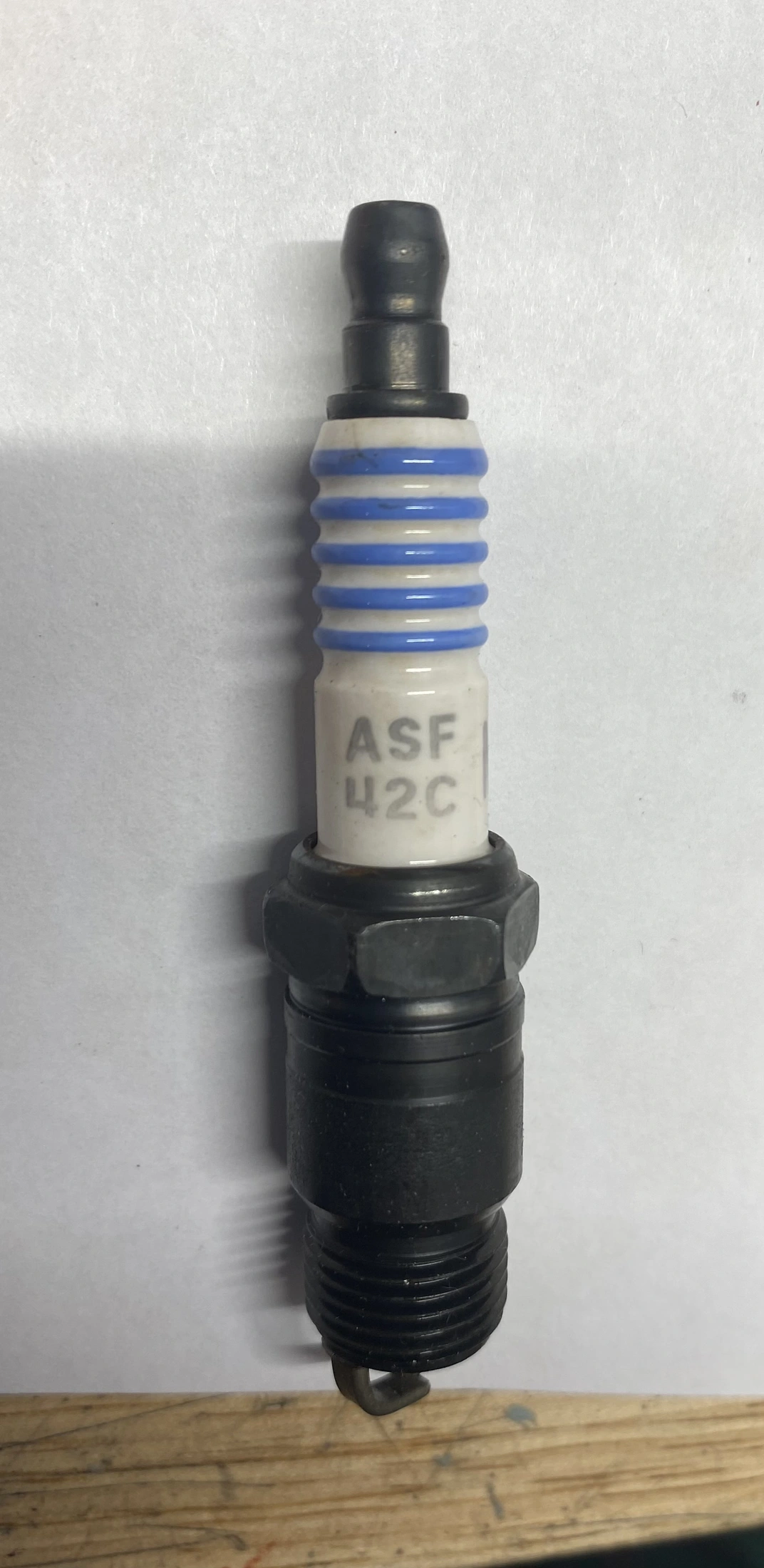

I have a 1991 mustang gt 302 engine what's the best type of sparkplug to use .

I like copper core plugs.

I have a 1991 LX (No Mods) and use Motorcraft Copper ASF-42C plugs as the car calls for with a 0.054 gap.

If the heads are stock then a Motorcraft ASF42C. I run Autolite 3924's on both the Edelbrock and AFR heads in my cars.

Thanks for the information. I ask because I have trouble with my car it starts but rpm dips down and back to about 850 rpm .I tested idel control everything check out good tps is on 98v .checked for vacuum leaks good. Maybe spark plugs I have are no good I have motorcraft sp502x and think they are bad.
