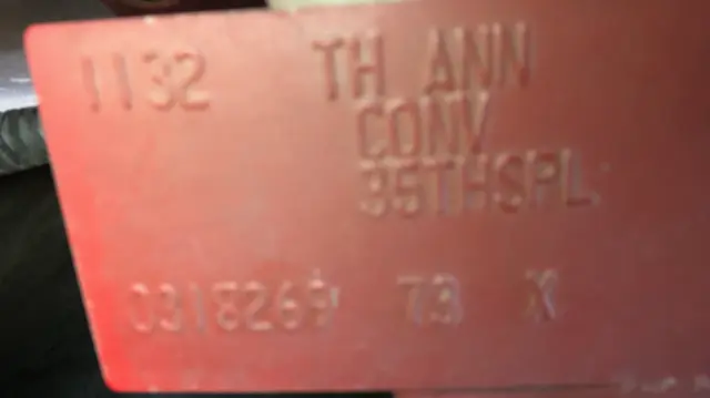

I just found my buc tag does anyone know how to decode
the 73 is 3.27 gears the x is 1999 what is the TH ANN ? and the 1132 and 0318269?
