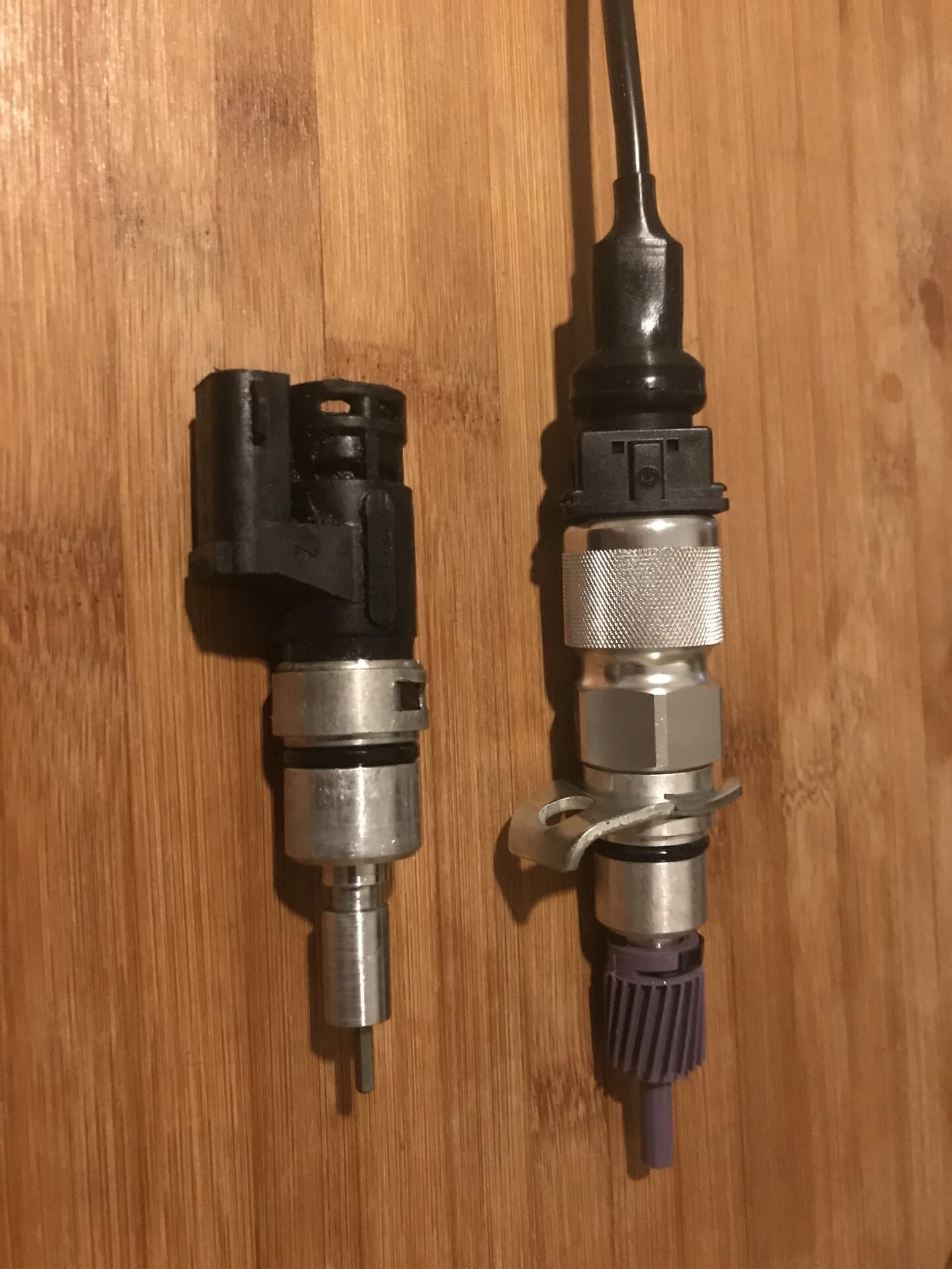

Is the speed sensor required for anything other than cruise control? My new speed trans adapter on the right doesn’t have a connection for that plug

Not 100% sure, but I think the auto computer does use the signal for adjusting idle as you coast to a stop.

The computer uses the input from the speed sensor for the dashpots anti-stall strategy to help prevent the car from cutting off when you are coming to a stop or idling slow in a parking lot. I would recommend sourcing the proper part.

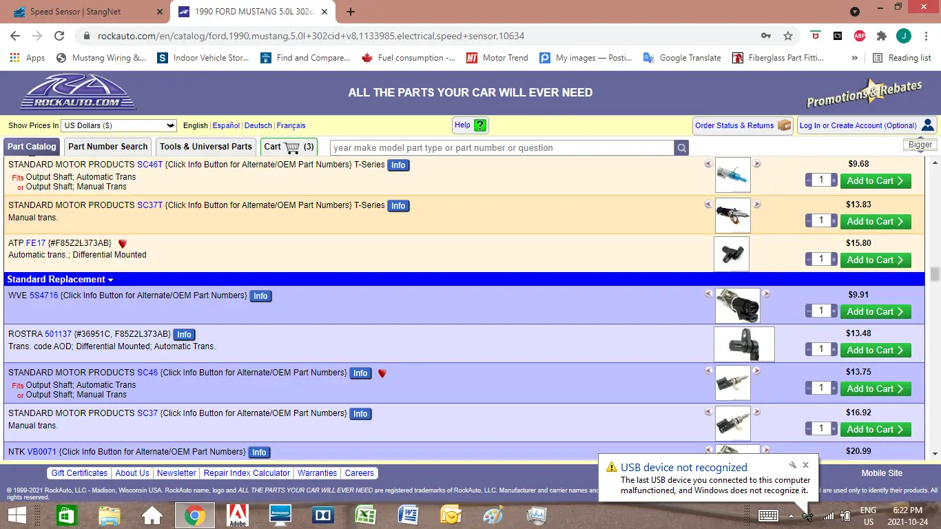

Can't beat that LMR replacement one for $30.

Rockauto, not even close...

Pete said he couldn't find one to save his life,LMR was just an example to see if it was same part he was speaking of.
Plus I usually add a T shirt to any LMR order IF it gets me to qualify for free shipping.Adding $12 shipping to a $15 Rock Auto order is a no go for me unless I have much more to order.

Yes, on the 89+ Mustangs the ECU is monitoring the signal on both auto/manual ecus as it adjusts the idle strategy as your roll to a stop.
Without it, some cars will stall out. Even without cruise control, it should be retained and the computer will spit out a VSS codes if it’s failed
On 86-88 speed density Mustangs it’s only used for cruise control. Non-cruise 86-88 don’t even come woth one installed. You need to add one if converting one of these to MaF
