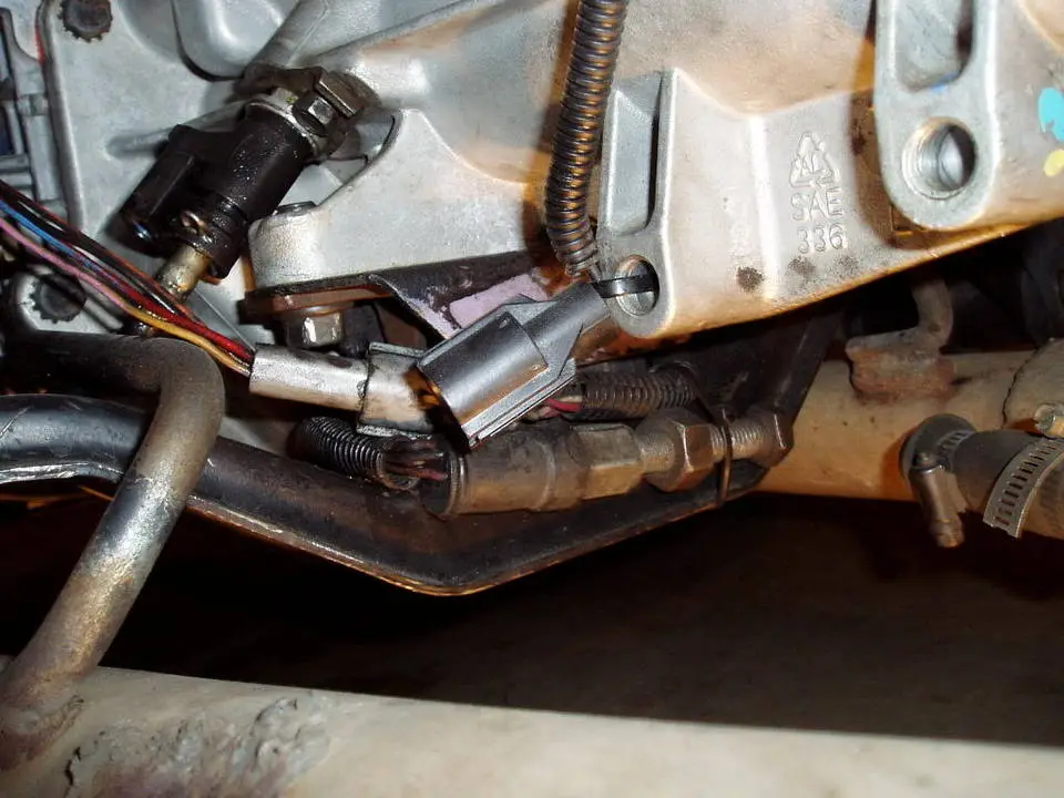

I replaced internals of the speedo cable (lubed) and it was good for about 250 miles. This afternoon it broke again in the same place. It seems that the bend angle between the VSS and the trans mount bracket/exhaust hanger is too extreme for the cable. Is there any other adapter I can use to replace the VSS to lessen the angle? (the vss is not in use) The only other solution I can think of is to drill an angled hole through the trans mount and come up through that, but the the speedo cable will suffer from heat exposure to the exhaust.
I used the cable for the cruise control as that is what was in there already even though I don't have cruise? It's a TKO 500.

I replaced the entire cable and it was a ****** trying to get the cable into the VSS. It is currently working and no bouncing this time. Will see if it holds up.
