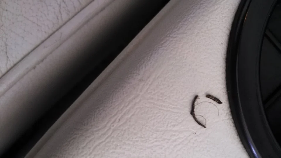

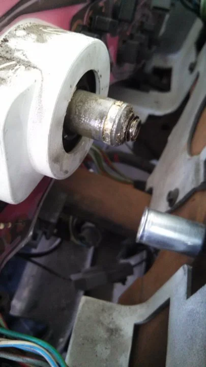

After having my speedometer cable replaced on my '90 7-UP, it soon began bouncing around then making horrendous squealing noises. I disconnected the cable & found some wire debris. Should I just clean off the old grease an relube? I have a feeling the metal debris may be pointing to a bigger problem....
Pic of the cable end and the debris that came off when cable was disconnected. It looks like it may have been a ring of some kind?

Since I always reach under the dash to remove/replace the cable I can't recall exactly what the setup is but yup that's the retaining clip that holds the cable in place.Take it back to whoever did the shoddy install and have them pony up.
Did they at least remove the new cable from the sheath and lube it before installing it in the car?
Hopefully it's just a clip replacement(Will need to pull one from another cluster) and not much else is buggered up.
