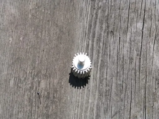

Adam is right. The white gear is not a Ford part and doesn't fit right. I got my red gear from Ford and haven't had any trouble with it other than some speedo inaccuracy. The speedo gears probably still work when you're going fast because they will turn at speed and skip over the part without teeth to a part with teeth.
White gear:
I went through a few 23's... If they go bad, they can also cause your cruise control to stop working... Also, a 23 tooth gear on 94-95's (with their 8 tooth trans gear) are not dead on, it's still off some. To properly fix this, you need to replace the gear in the transmission. Replace it with a 6 or 7. This isn't easy though... I went with the 6 and 18 for dead on 3.73 readings.
