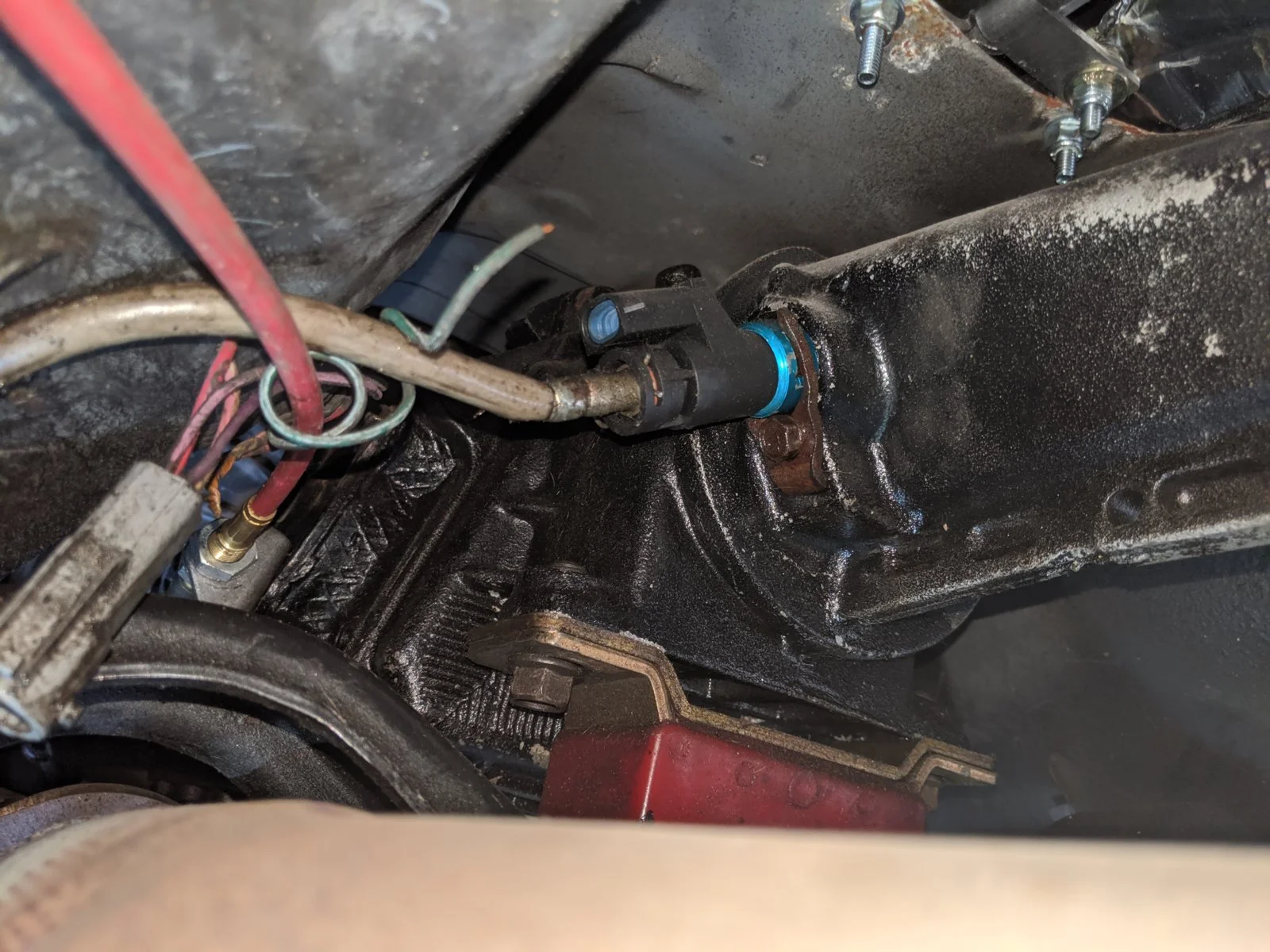

Hello, I recently got a 89 convertible with a 331 track heat intake, afr heads, 70mm tb, c4 reverse valve body. I'm not sure of the rear gears without looking or trying to rotate tires and counting drives haft revolutions. The speedometer is about 15mph fast. Any ideas what gears I may have, or should I pop a cover.

You’ll want to pull the VSS sensor out and see what gear is currently on there. Also you can figure out the rear end gesring by marking and counting rotations.
Also, the wire that normally plugs into the VSS sensor is not present. You’ll want to locate it and plug it in. Without that signal to the ECU, the engine can sometimes stall when coming to a stop
In the picture of the transmission there is a plug hanging to the left in the foreground. Could that be the VSS? It looks like some wires have been cut. At least the green wire with the white stripe.
