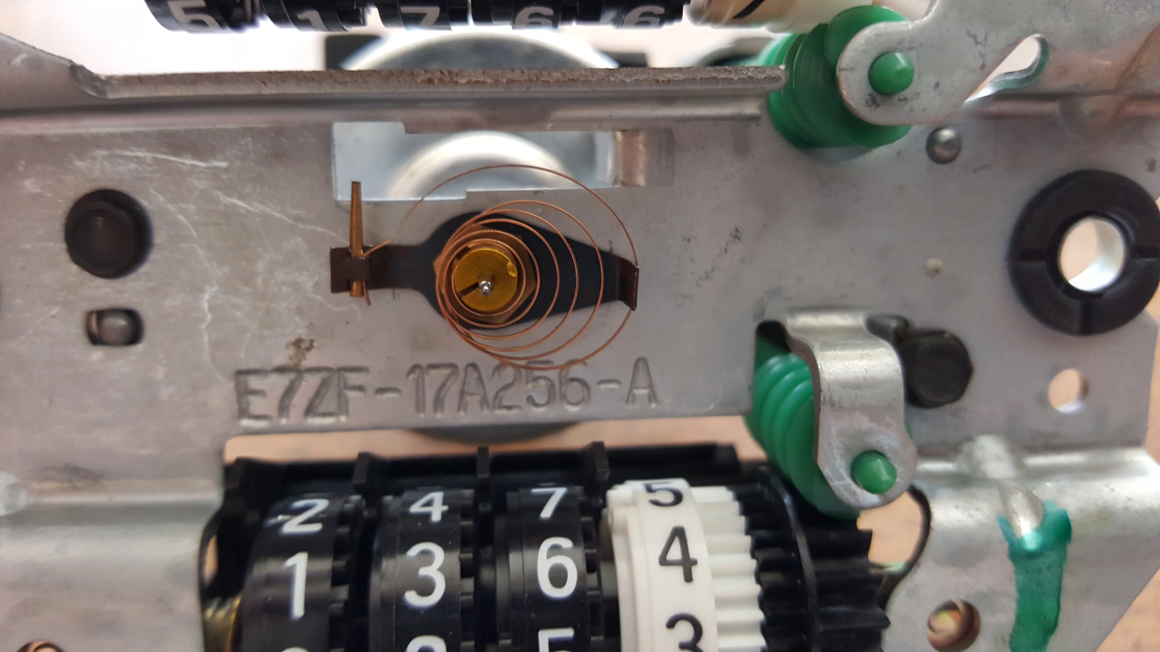

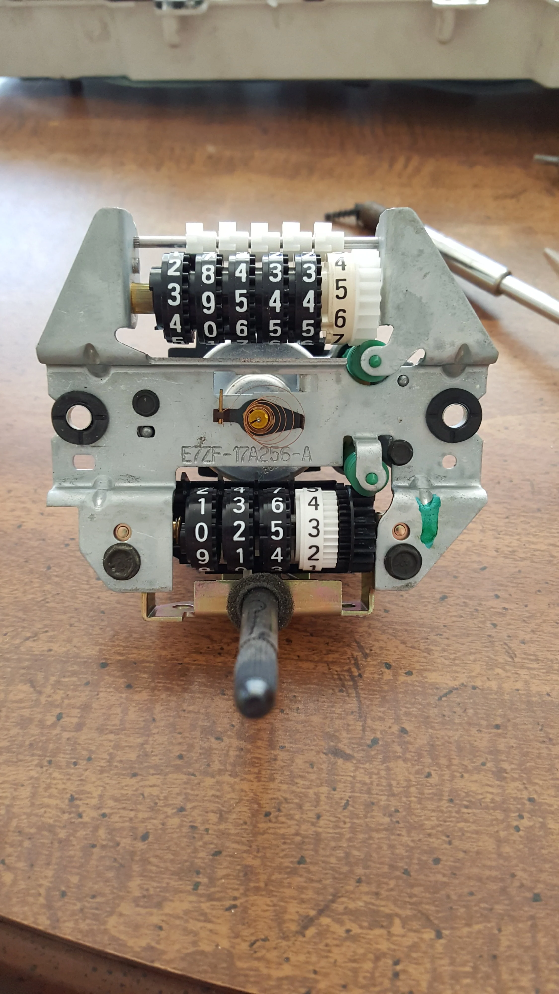

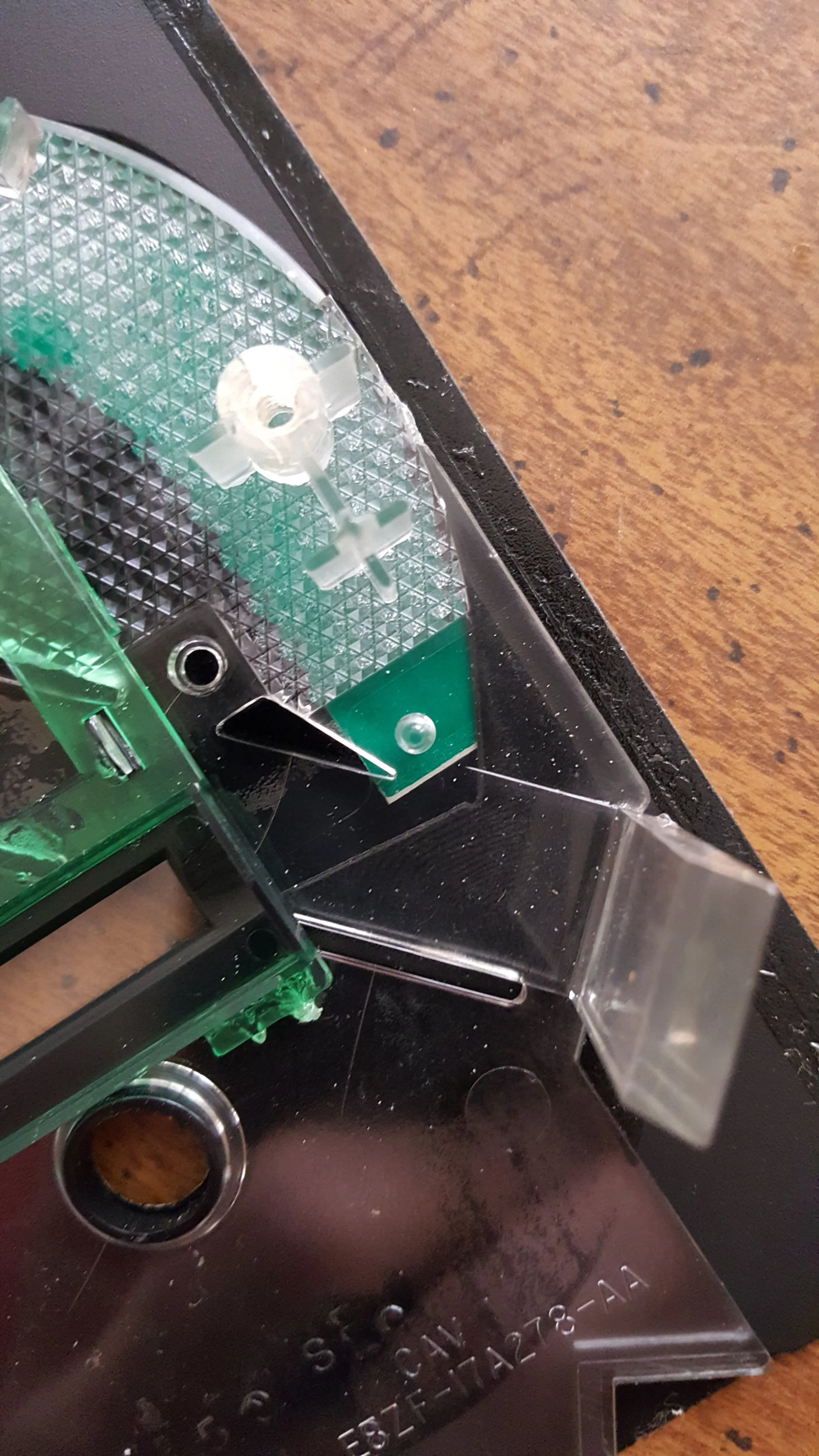

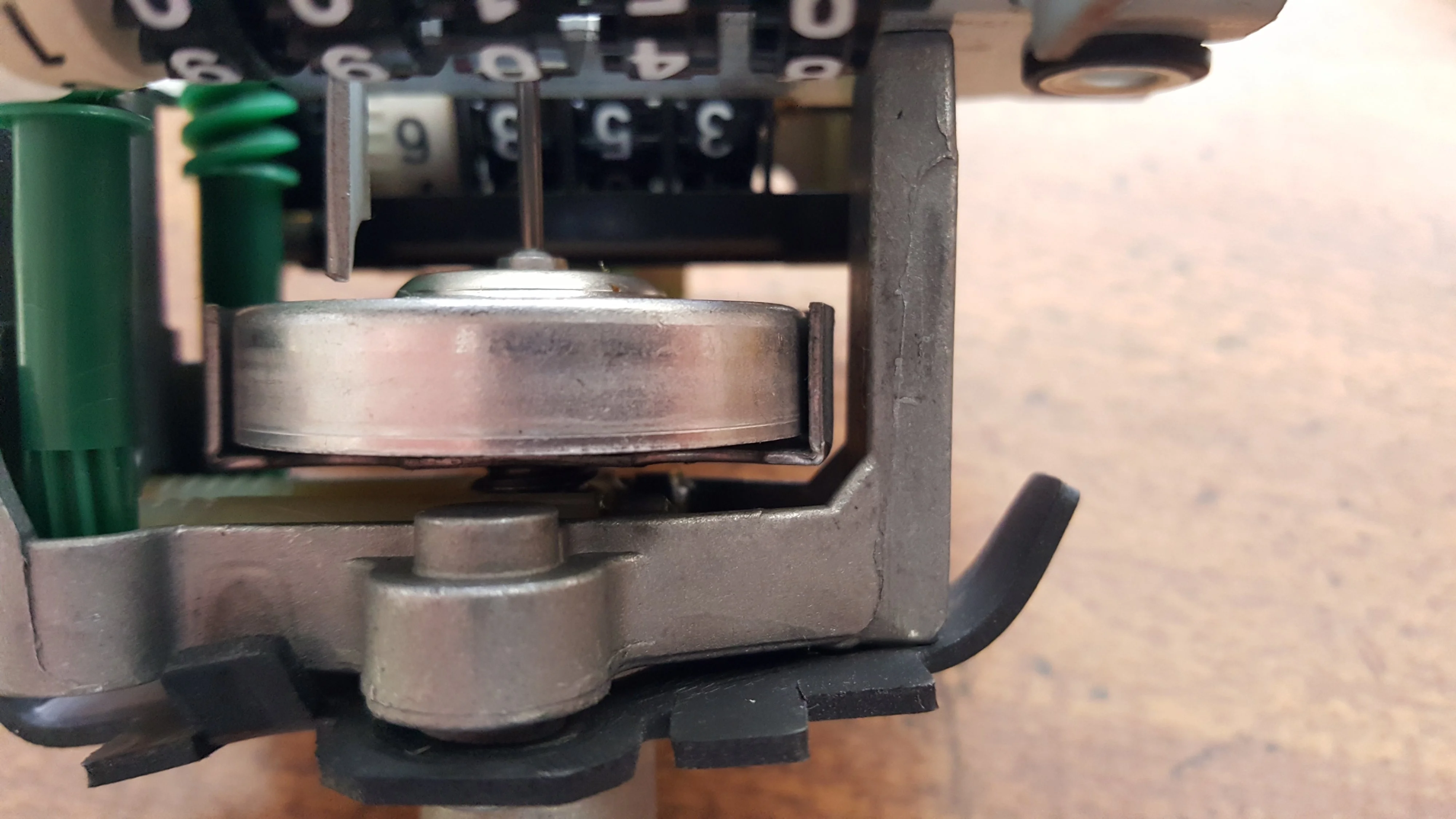

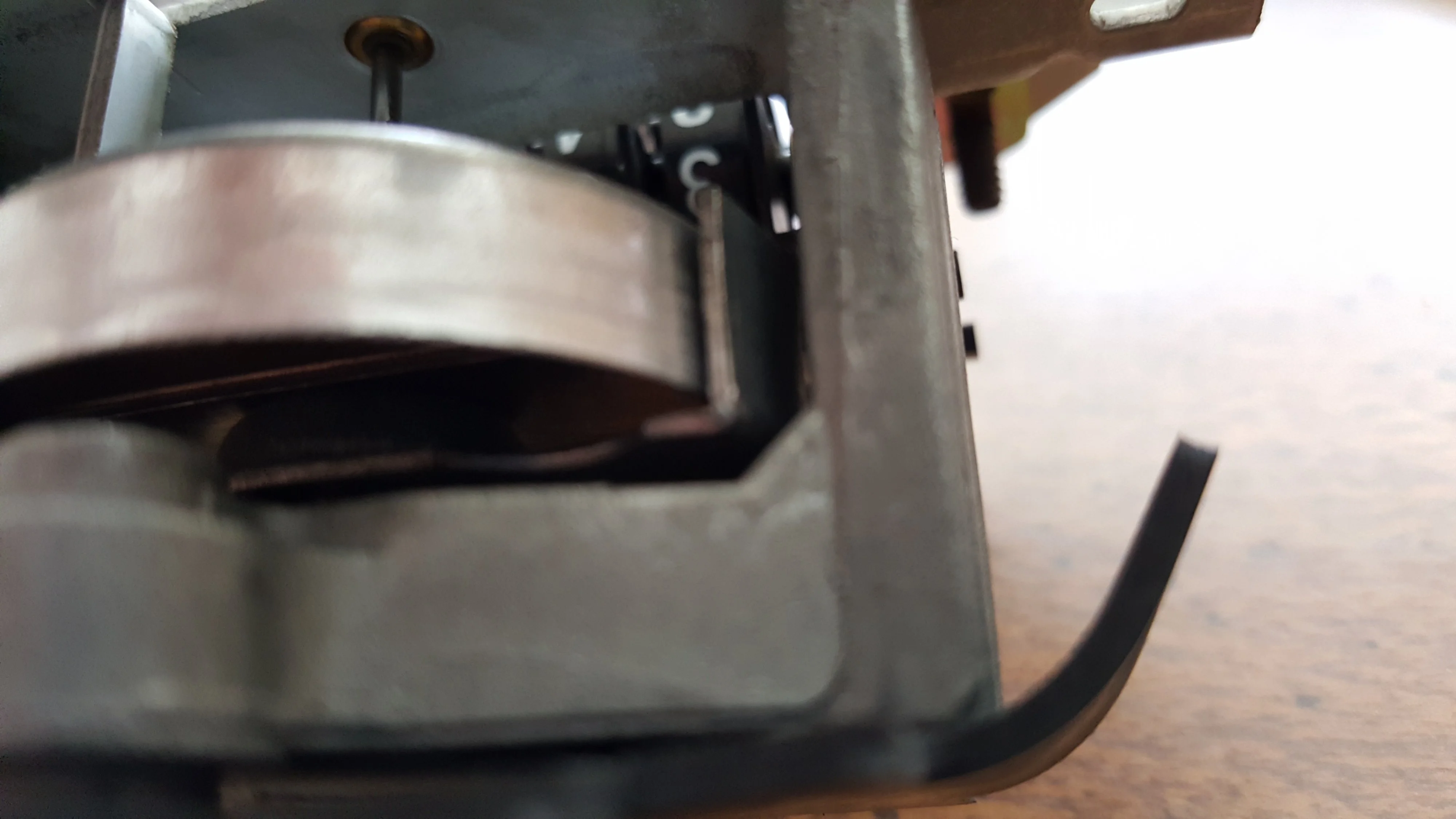

Ok, finally got around to taking it all apart and checking things out... ;)
I don't see anything obviously wrong. Attaching pics to see if anyone else sees something I don't. The rotating assembly stuff in the back of the housing seems to spin fine. I can spin the inner part and it spins the needle; doesn't seem to be binding or have any kind of resistance. What stops the needle from just falling down?

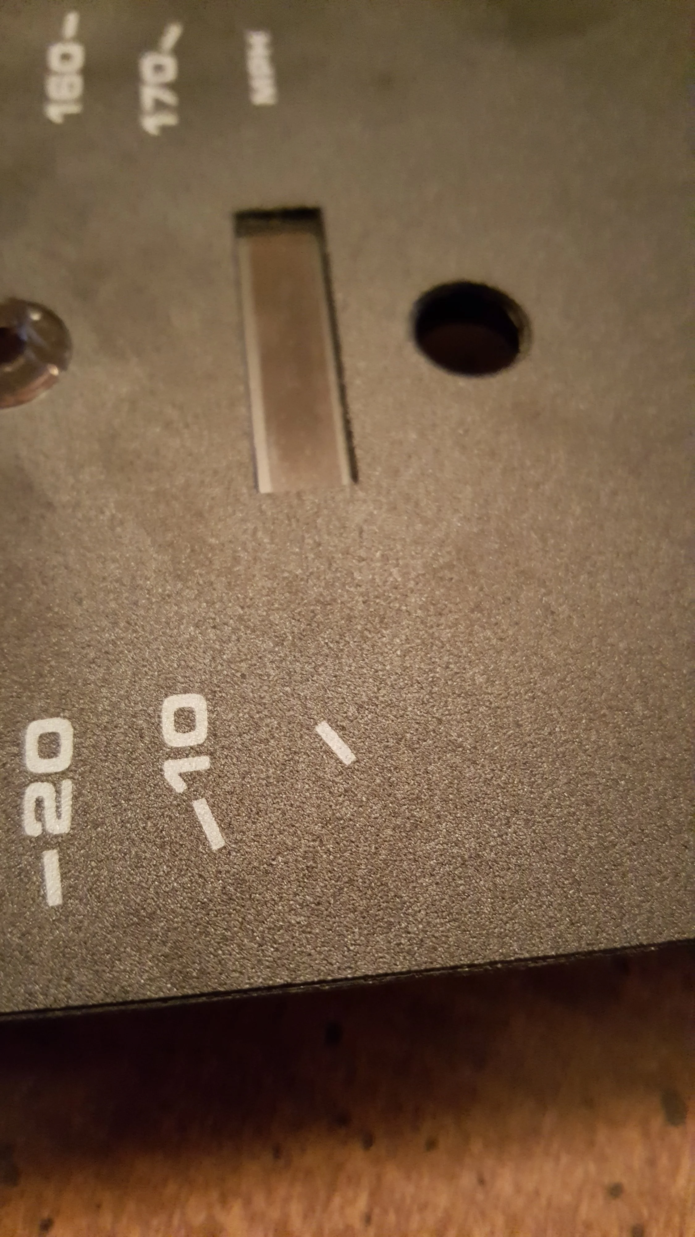

There is a little post that the needle rests on to keep it from going below 0 on the face, is that what your talking about?
I took a look through some google images and found one that looks to be the same as yours with the needle in the proper position and didn't see a post to stop the needle from going below 0, I would think there has to be a stop :shrug:
Since you have yours apart look on the back of the face (sounds funny I know) and see if there is a hole about half way between the center and the 0, like I said, the two saleen speedo's I found online don't appear to have the stop
Perhaps you can contact the company for more info

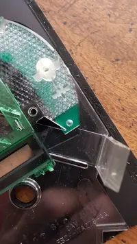

So there IS a little peg on the back of the face of the speedometer right where the zero is. In the picture its the small peg next to the triangle shaped plastic thing.... does that help point to a solution?
Little update... I reset the needle on the shaft to point mostly at zero and then put it back in the car. I drove around the neighborhood and it seems to be okay. I don't think it was the most accurate (kinda bounced between 10 and 30 the whole time) but being in the neighborhood I couldn't really go above that speed. Got it back in the driveway and the needle is staying put around the zero mark. So I dunno? I am going to replace the cable. I looked in the end that goes to the speedometer and I can see grease stuff coming up in there, so I am going to lube the new one up according to jrichker's instructions.
