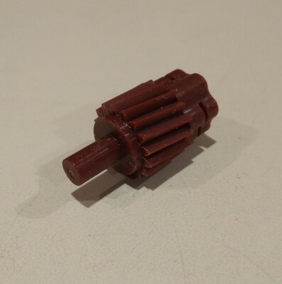

16 tooth gear here.
Looking for the 15 tooth. I’d have to imagine tons of folks have them setting in their tool boxes as they swapped from 2.73s to better gears. I still have the gear for my AOD with 2.73s.
Everything I’ve found suggests the 2.73 manual cars with the 7-tooth came with a 16 tooth gear. Let me dig a bit more
Here’s a 16 tooth on eBay. I see plenty of them.
Cannot find a 15 tooth at all. I can find references to it in some of the classic mustang forums, but cannot find a single one for sale.
Chart doesn’t show a 15 tooth
