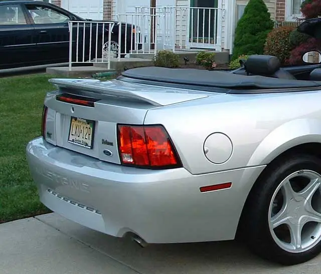

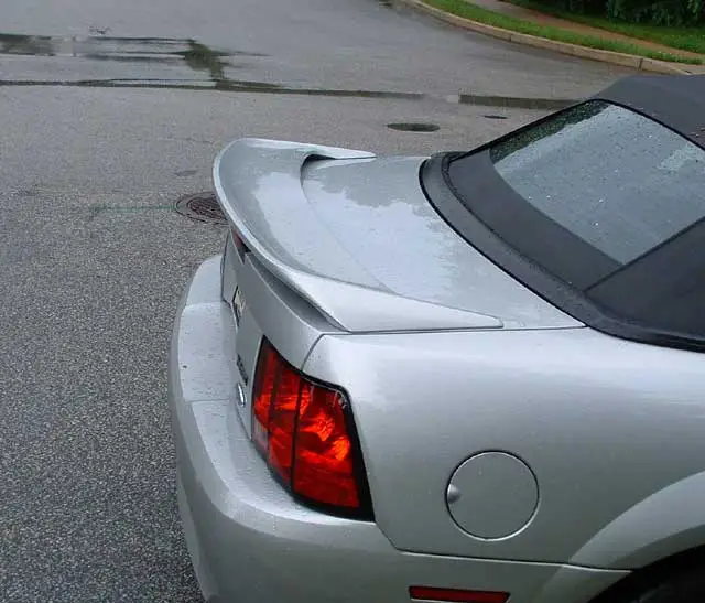

Attached 2 Images, one showing the stock position of the spoiler and the other showing the new moved back position. I used two of the original holes and drilled 4 more, total move is about 2 inches or so.

nice dude how far back is it? what u use to fill the old spoiler holes w/?
the holes that arent re-used are covered by the tips of the wing. silicone can be used on the holes inside the trunk for extra protection.

Yeah, I like it alot, I didnt fill in the old holes doesnt seem to be much of a problem, it just rained and no water got in the trunk. I think i netted like 10 rwhp from this mod and that should be doubled when i put the flowmaster stickers on too.
Why??
You drill new holes through a plastic composite deck lid. There's nothing to rust and any water that runs through the old holes just runs into the same channel that water off the back window runs out of.
I did this mod and ran my car through 3 NY winters to boot. With absolutely ZERO issues of any kind. Just drill new holes so the wing still covers the old holes and forget about the original holes. Mo water can get into the trunk from the original holes.
This is an easy no money mod that significantly improves the look of the car.
