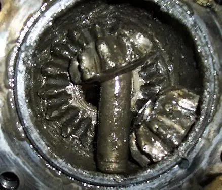

steel1212 said:
302 never, thought of that. Would everything else stay the same? I've never rebuilt a center and was going to have a local shop do it for me. Is everything there in the pic that I would need?
ooops, thats another way, if you get the rear rebuilt, put 31 spline spiders and then get 31 spline hardened axles, but get everything done at once.
yep, everything else would stay the same, at least to my knowledge. You can still buy all that stuff (shafts, block, spiders) new if you're worried about used parts, but for $8 the ebay stuff is worth the risk.
This is what my diff looked like last summer. Bought a mini spool for $27.00CAN and was back on the street again after a total of about 2 hrs work (not including solvent tanking everthing). I chop a U'ey almost everday on my street when I get home and the inside wheel chirps a bit, but nothing I can't live with for awhile.
