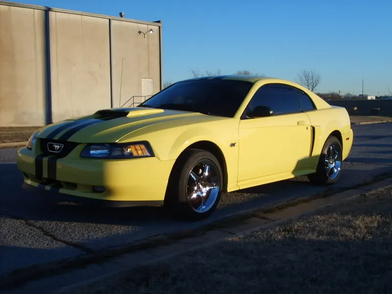

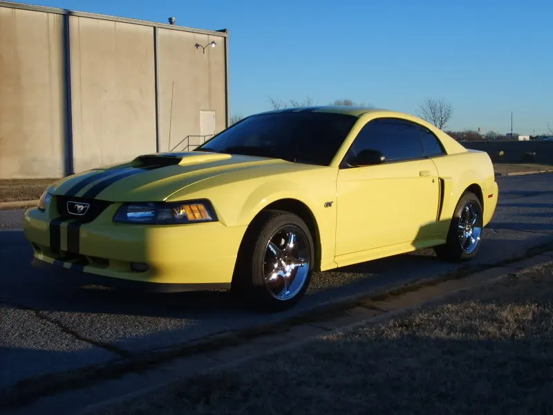

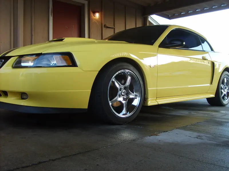

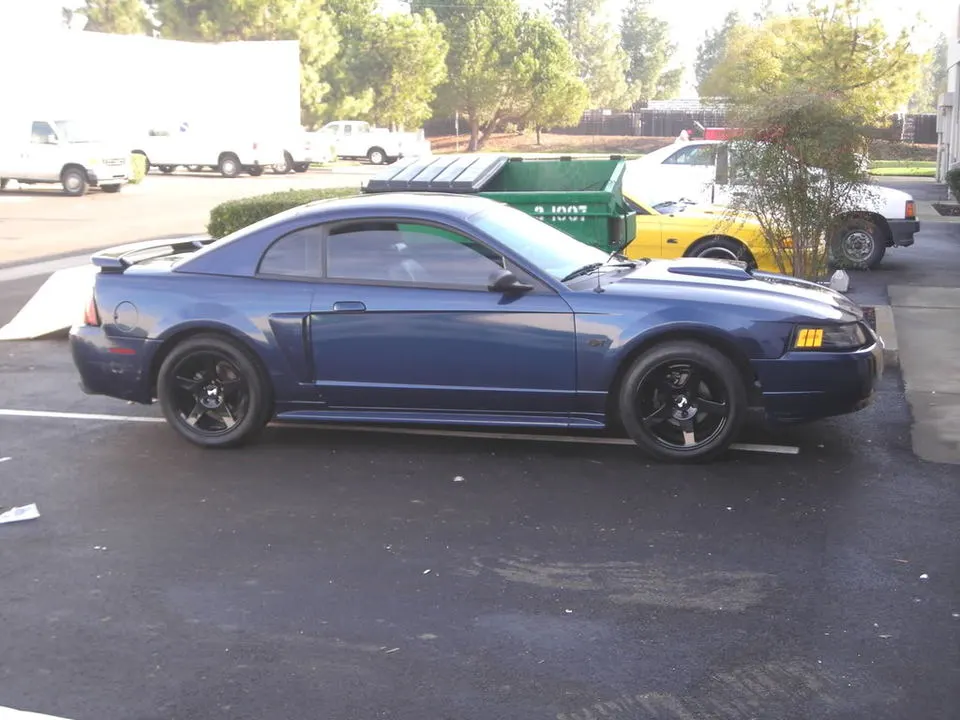

I have C-Springs with all isos right now on a 17 inch rim with 255-40 tire. Thinking about getting Sportlines and using no isos. What is your opinion. I get them cheap. I like the look of a lowered car and just want others opinions.
Before...
After...

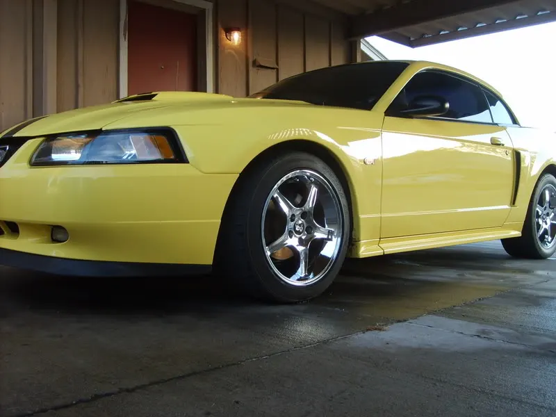

Sportlines seem to drop every car differently. I have seen cars running sportlines & they looked totally dumped, but my buddy put sportlines on his 02 GT, & they looked like a pro kit to me. It actually looked like the rear sat lower than the front....He fixed this by removing the front iso's & it gave the car the slight rake it needed....
That being said, I want to get rid of my H&R supersports on my 95 because its my dd & I am tired of the harsh ride from the super stiff spring rate of the H&R's (700-760 front & 275-300 rear). The Sportlines actually ride surprisingly smooth because the spring rate (425-630 front & 140-295 rear) is relatively soft for how low the are supposed to drop the car....H&R's handle better though....Sportlines feel like a better daily driver spring....

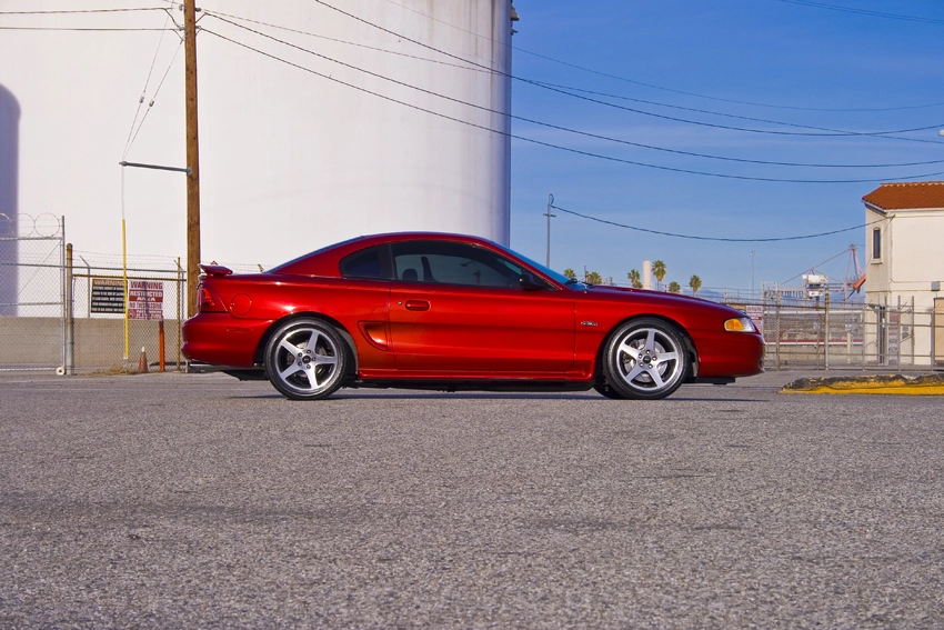

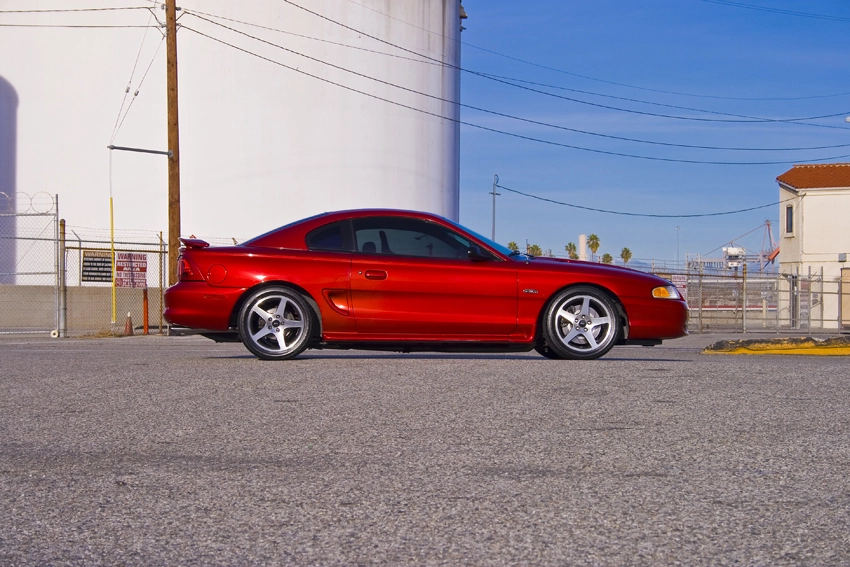

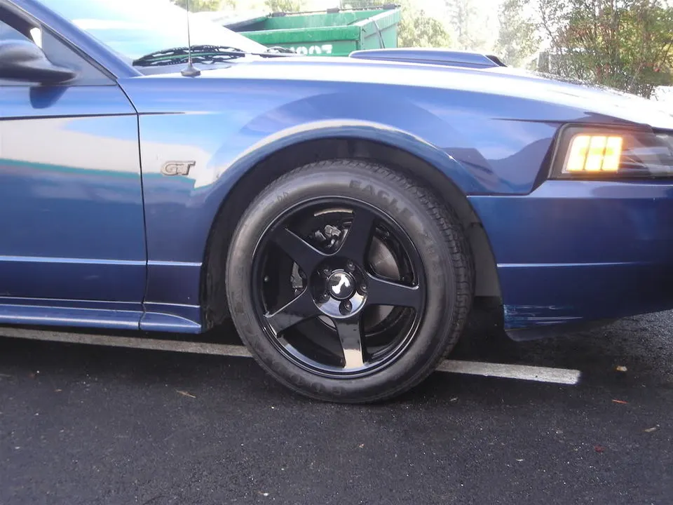

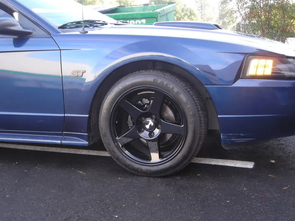

Here is a pic of the car b4 the isos were removed....Not a very nice stance imo, & it looks like the car has a reverse rake,but SRT's car looks bad@$$ & ha the perfect stance....

I agree about the ride quality being better, but the stance seems to be hit or miss with the eibachs..yours looks sick, but it probably wouldnt look as good without removing the front Iso's, & the adjustable lca's probably help with leveling out the rear end....
