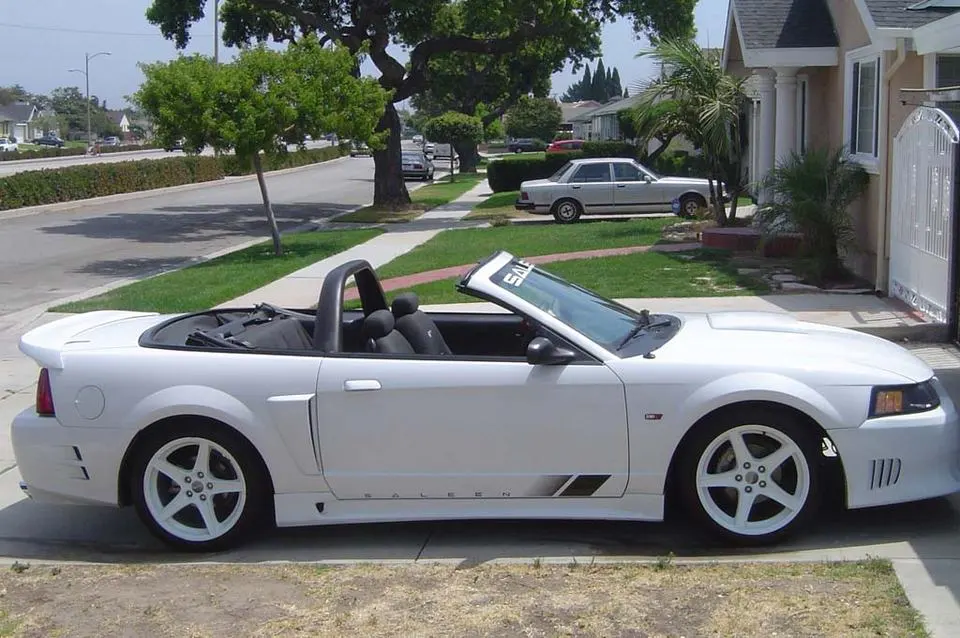

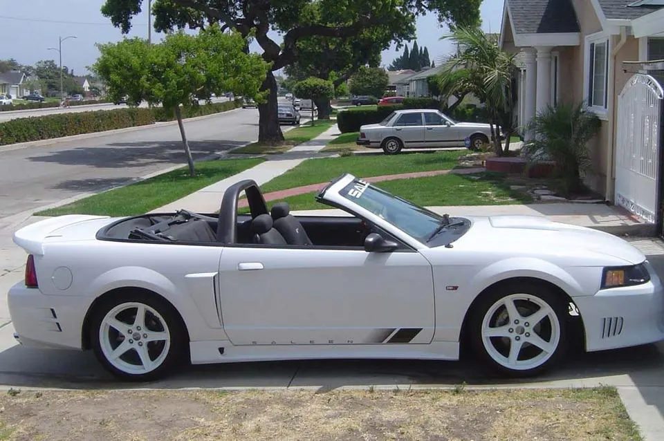

I have H&R Super Sports which have similar drop amounts along with 18X9's. No problem whatsoever.

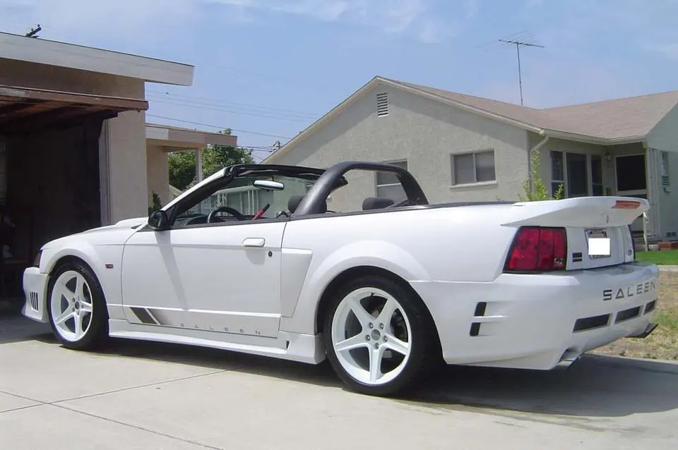

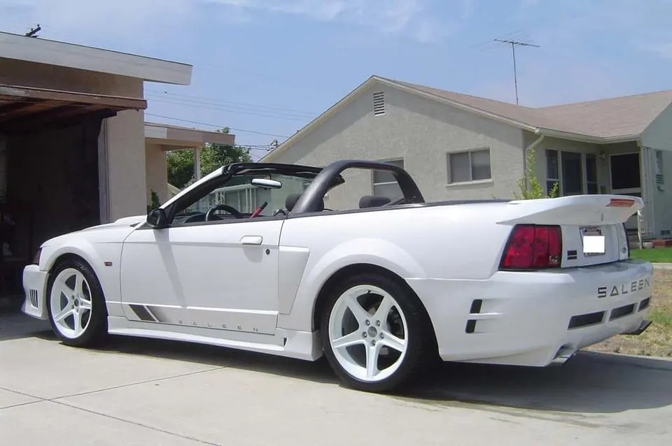

i got 18x10 saleen replicas in back with sportlines and the fenders rubbed bad on my rear tires. tore one of them to shreds and had to buy a new $310 tire with less than 75 miles on it. The saleen replicas sit really far out in the rear tho. a little bit more than 18x10 bullitts. i rolled my fenders and switched my rear springs.
VERY UNHAPPY with my sportlines cuz they sit lower in back than in front so i swapped the rears for roush springs...
this is with the sportlines... notice how there is very little clearance in back.
