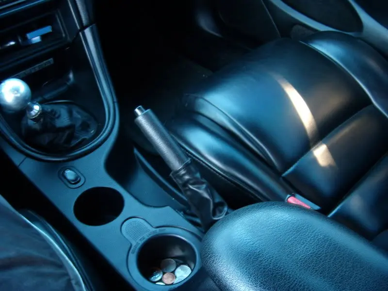

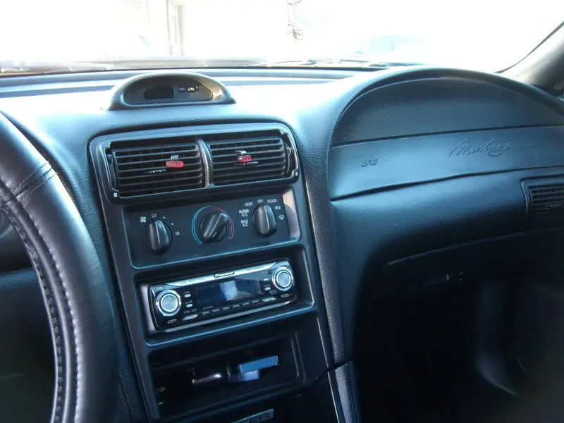

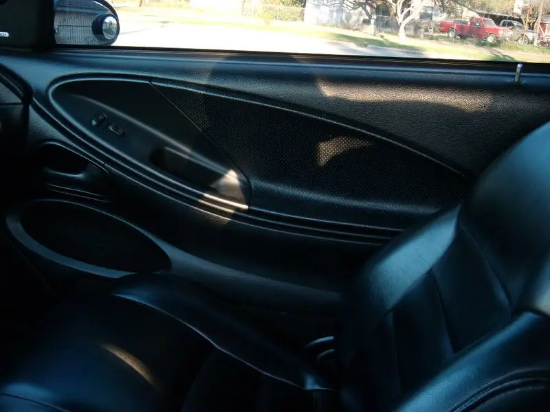

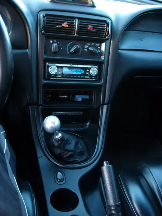

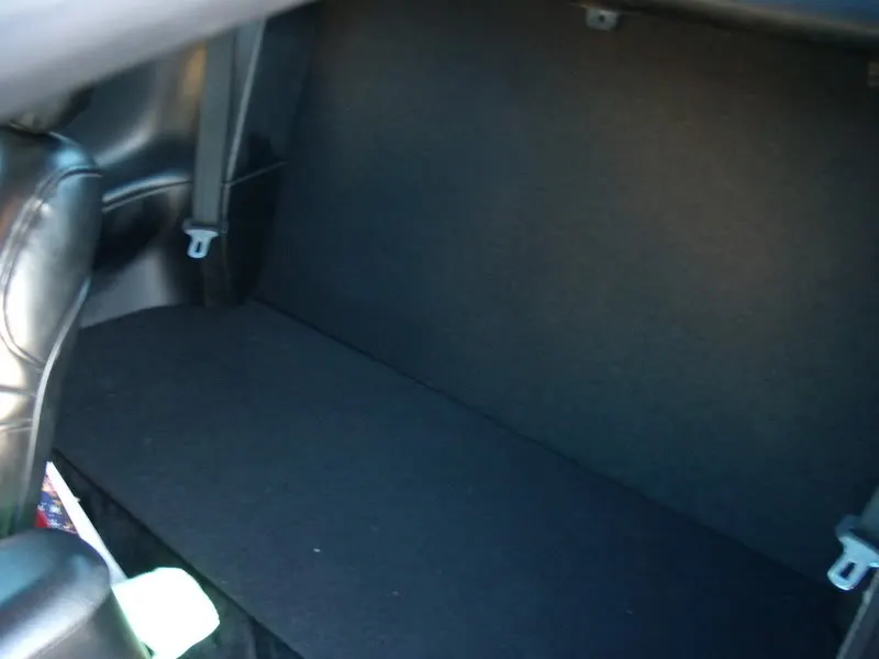

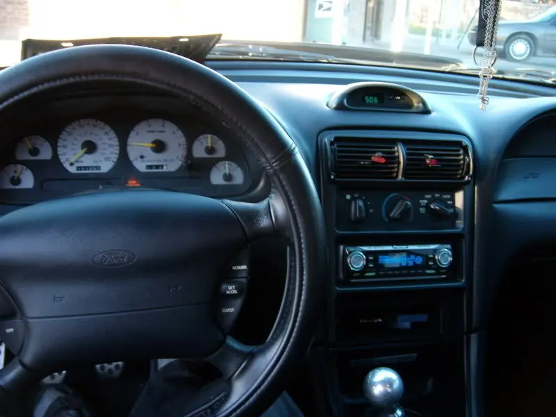

don't have any pics of it before, but it was the black/saddle interior--hate saddle.
after:
DO NOT USE THE LAQUER.
I did mine and the vinyl matches PERFECT. But the laquer that i sprayed the harder surfaces with seems to scratch easier, and has a blue tint to it. use the vinyl all around.
