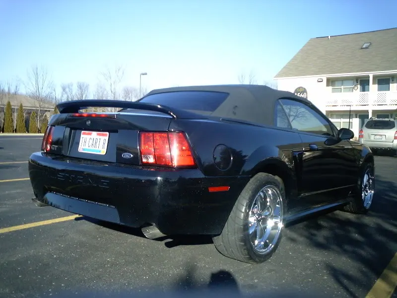

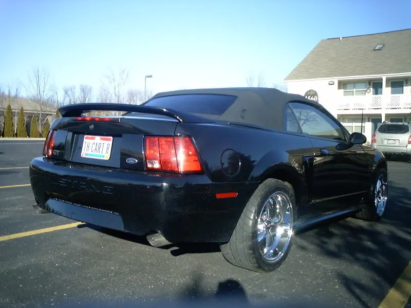

i think people are just suspicious of the ford C springs because they are alot cheaper than steeda eibach, etc. They think that more money means it is better which is not always the case. i looked into it alot and have decided on the ford C springs b/c they have pretty much same rates as steeda and they are ford which i semi trust...not like it is some lamo brand name. lots of ppl like these as well, if i have any issues with rear not dropping enough i will remove isolators, i will be installing tommorow so i will post pics etc in a few weeks
c springs FTW!
sorry for bad pic.

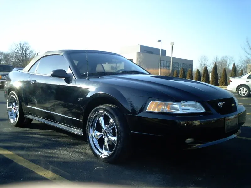

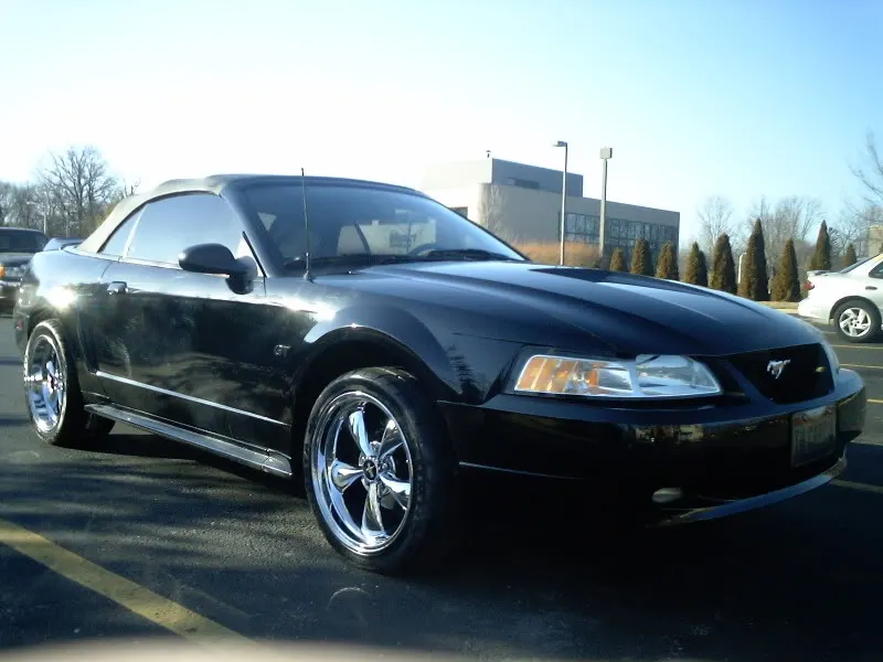

I know my car needs lowered and I keep hearing good things about Ford C Springs. Now, would I need to get CC/plates or anything else? Also, what do you guys think are the drawbacks of lowering it with these springs?
This is my daily driver.
Thanks
Chris
By the looks of it, your car is 99 or 00 right? its 6 year old car at least, so along with C/C plate, new uratehan isorater, and new shocks/struts prolly do you good man

Mity's pretty much dead on with what you "should" get for a car your age. C/C plates aren't really needed unless you drop it more that 1.5 in., but will definately help with alignment.
You may want to consider FRPP "G" springs for your car. They're specially made for 'verts, but usually cost more and are a little harder to find. I've seen pictures of convertibles with "C" springs, though, and they look fine.

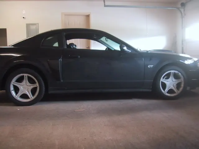

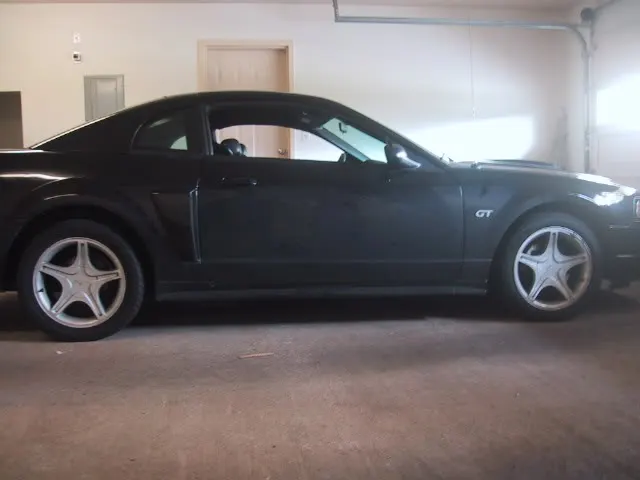

i have the ford racing c springs and didnt need shocks, struts, or cc plates. the front is a perfect drop. the rear is iffy. if u have a full tank of gas its almost perfect, if u run on E alot u will want to cut the dead coil off the rear. the ride isnt harsh at all and i have not bottomed out yet.
after with low tank of gas \/
before pics spring install \/
