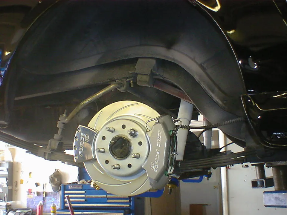

MDJay and Steemin do you have the SVO rear brakes?
Easier to show...
I have used the Lokar cables with my ssbc rear disc kit. The rear calipers are 88' t-bird. I used the original mustang pedal type parking brake actuator.
There is no drag whatsoever. I had to make a custom junction, and mounted it to my subframe connector on the driver side. I am not sure if I took pics, as It was a long and frustrating day! I will take pics, and post them here. Just to set the record straight though. There is absolutely NO Support from SSBC!!!!!
