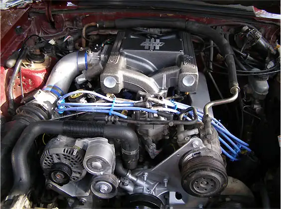

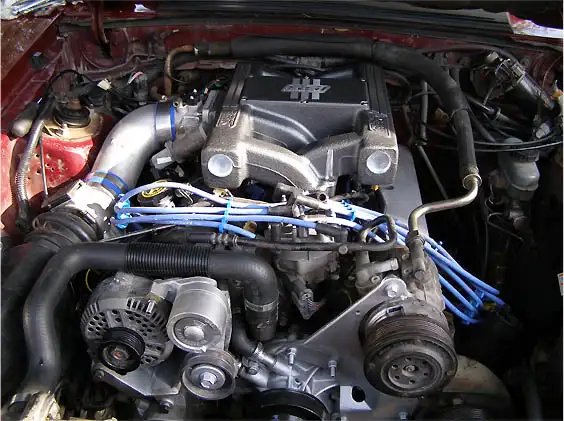

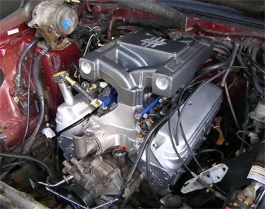

I just installed one,............ get a Trickflow or Edlebrock and save yourself some headaches
not worth the extra money, they look great
but take a bunch of tweaking

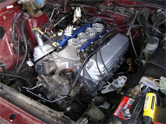

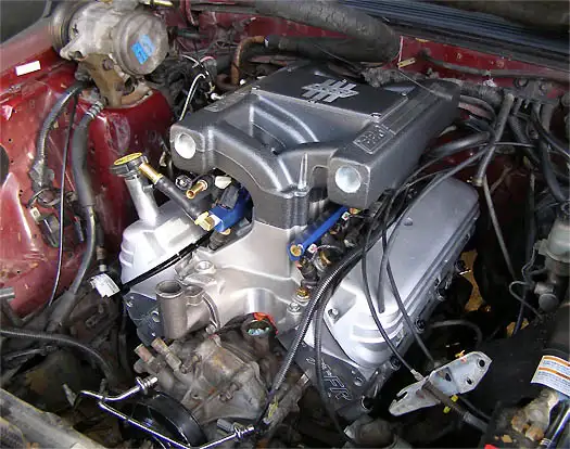

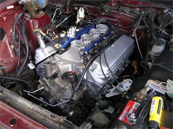

Pros:
looks cool, built in EGR, can access valve covers with upper intake on.
new fuel rail upgrade included
Cons:
expensive, required some grinding to get IAC valve to fit, tight fit along firewal
required some grinding inside upper intake, its heavy (52#'s), it rubs stock hood
really tight fit around fuel rails and egr valve, was missing small needed part
( did come right away from BBK no questions asked )
I'm having serious PCV issues on sucking up tons of oil into uppe intake.
Pros:
Cons:
Get a Steeda PCV oil seperator or make one yourself and it'll solve the oil in the upper intake problem.
