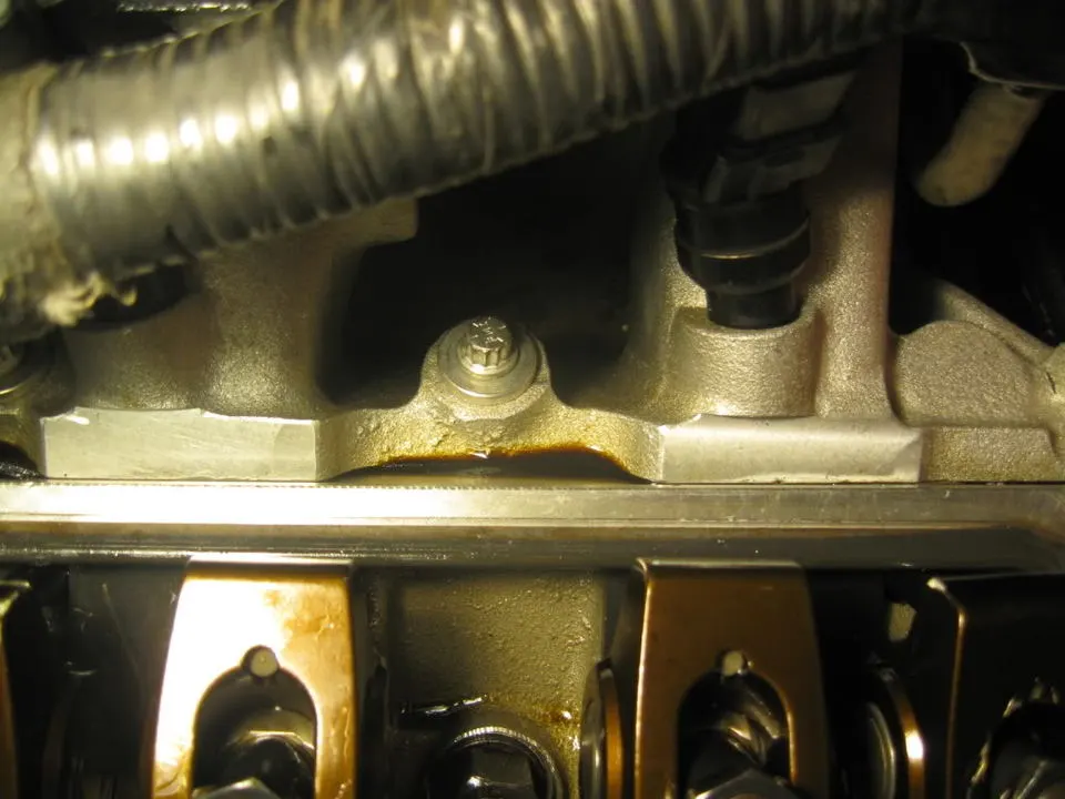

found the source of my oil leak that Ive had for two years now. its the drivers side valve cover. The gasket must not have been good long ago when the cam/TFSR intake were installed. With the edelbrock intake I can see where its coming from on the valve cover, with the TFSR lower you could not see it.
Pretty good chance this is why its leaking from the valve cover. Bought some JB weld to fix it.
Maybe found the leak, it was still leaking after I re did the gaskets last night. Just got done redoing them again and see if anything changes.

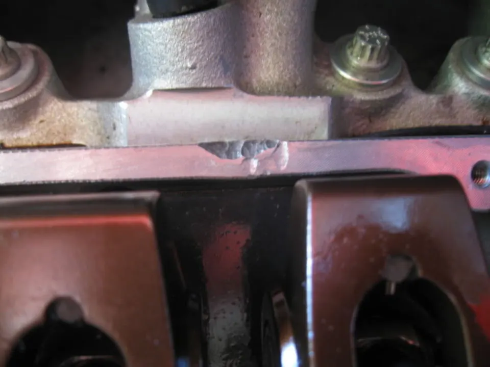

The JB weld worked fine but it still leaks but its not coming through the valve covers. its coming up through the intake on both sides where the heads/intake meet together between the bolt holes.

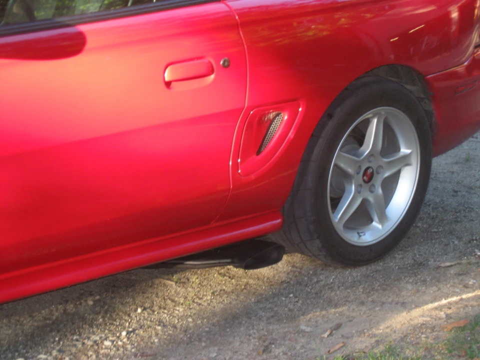

I thought it was leaking through the VC and pooling up in those spots but its actually coming through the intake. I just ordered a new set of gaskets and Im going to use RTV where the intake makes contact in that area of the head. On a side note I finally got around to installing the side exhaust kit. Just need to get a set of side skirts now.

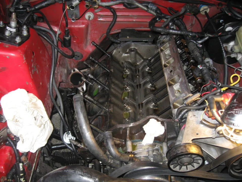

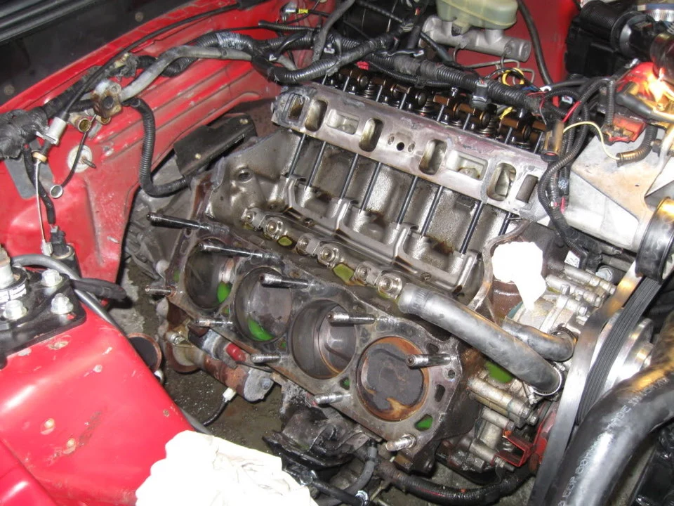

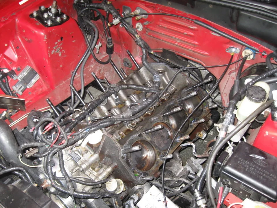

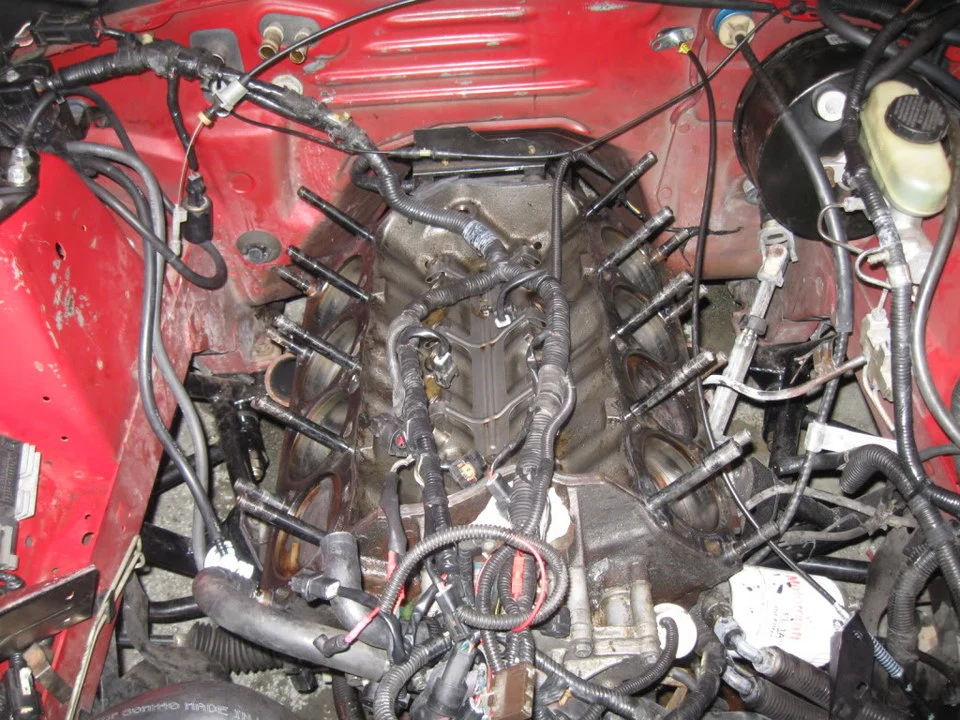

In the process of taking the heads off now. Im getting rid of this oil leak once and for all and that means either fixing the stripped bolt holes (2 of them) in the head where the intake bolts to it or selling them as is and getting a different set. Ive wanted bigger heads for awhile now so these ones are going and Im going to get a set of Trickflow 205CNC heads
well I suspect thats why its been leaking ever since the Cobra intake was taken off. Thats when it became apparent that the bolts were stripped out. After trying every other possible venue its come down to it having to be b/c of those stripped bolts. So Its getting a nice set of upgraded heads to make it a more potent NA set up
