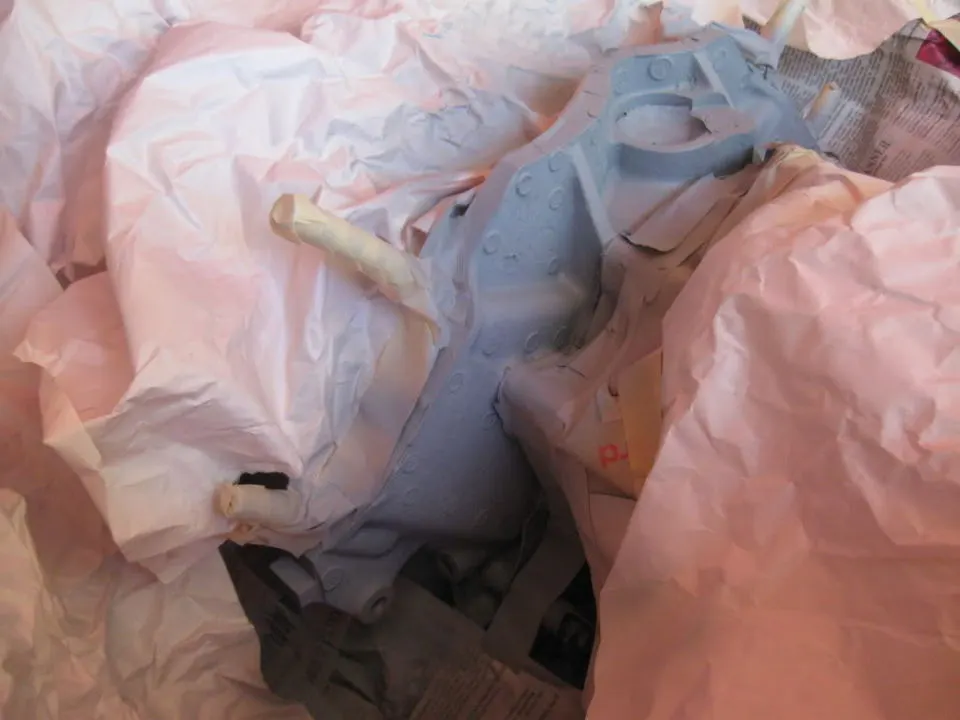

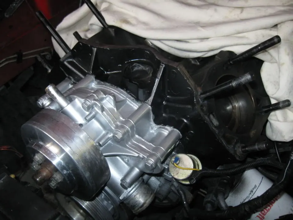

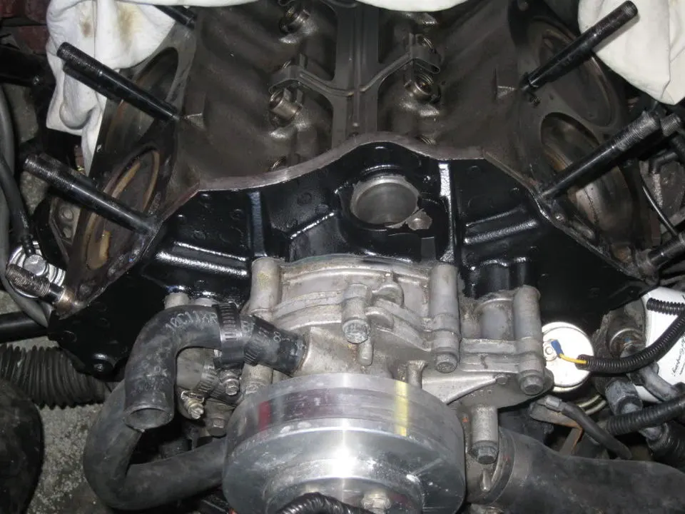

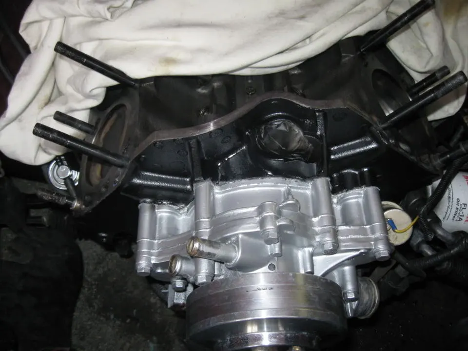

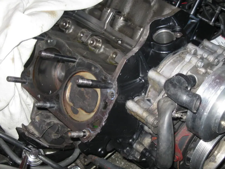

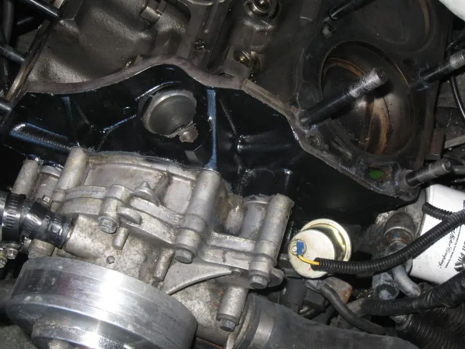

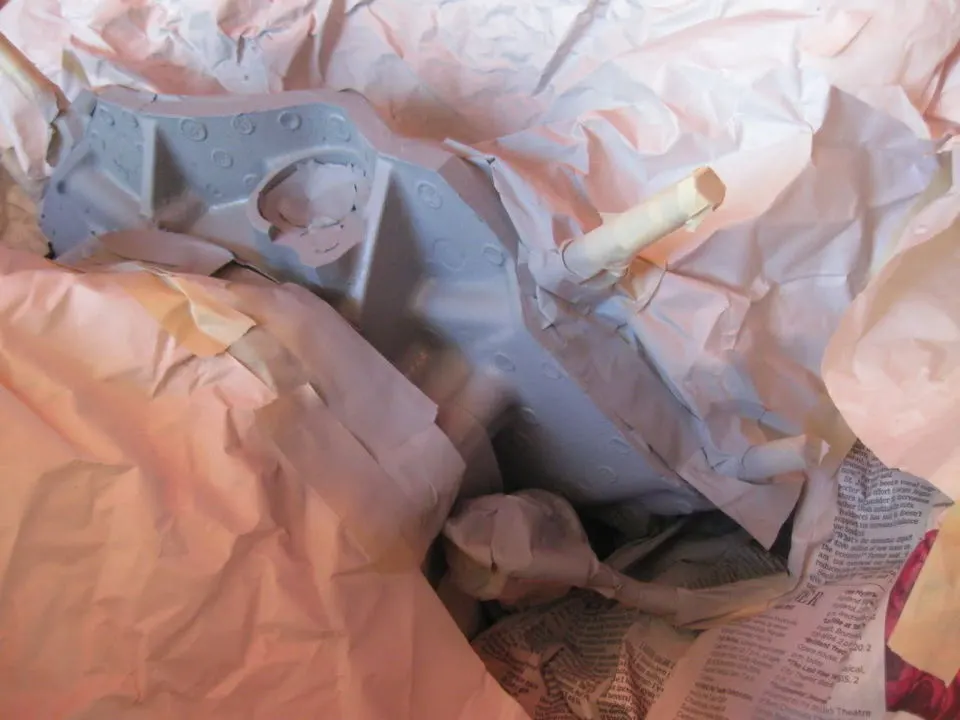

I did get the front of the block painted today though.
Primer
Finished

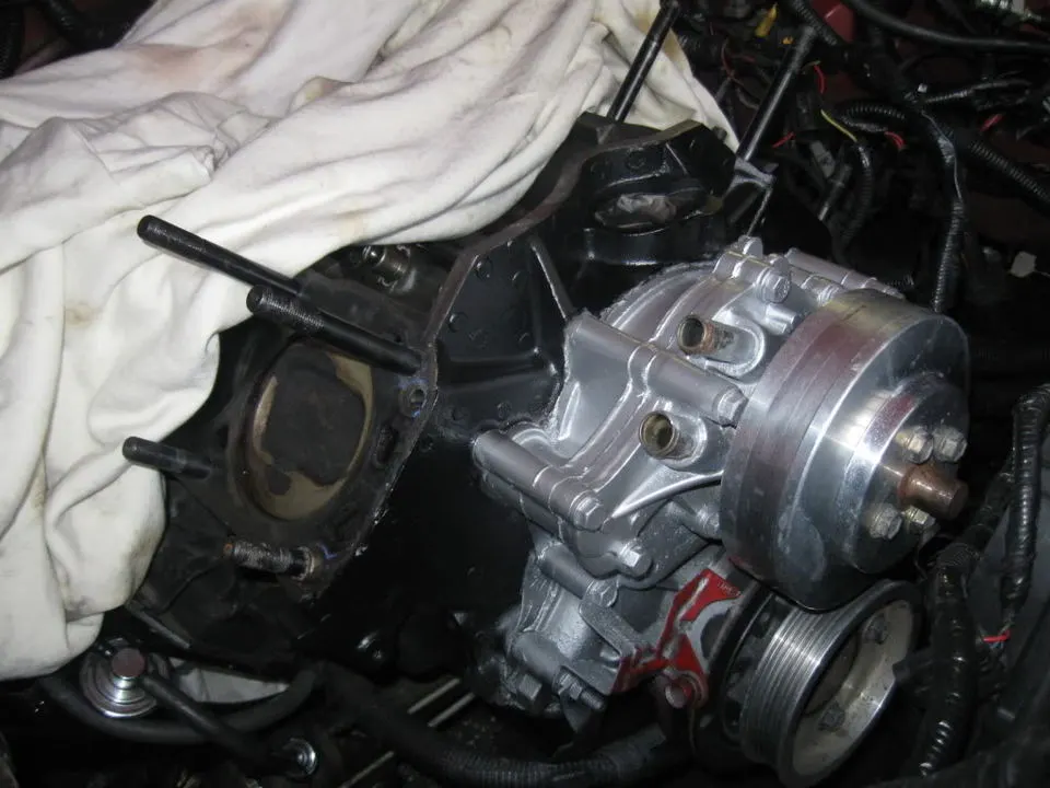

looks good. you've been busy. Is it a PIA to get the driver's side head off with the head studs? Heard it was a pain because the brake booster is right there.
I've been busy here but doing different stuff. I spent last weekend and today putting a floating floor style vinyl tile in the bathroom.
Yeah its a major PITA bryan. It sucked more then I can tell you. All the studs clear the head except for the top stud on the #8 cylinder and as you pull up it hits the brake booster. I had to lift the head up as far as I could and pivot the front of the head around to give the back of the head more room to tilt down and clear the stud. It took awhile but I got it off. When it all goes back together Im doing the drivers side everything first b/c thats where most of my issues came from. Once that side is all done..head..exhaust..the rest will be easy.
