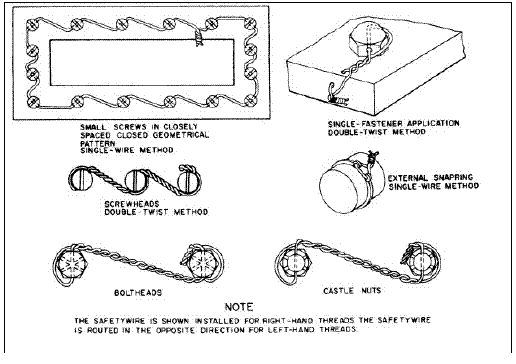

Torque the bolts down and pull off about 12" of .032 stainless steel safety wire. Thread the wire through 2 holes, or just one if the other one is blocked by the header pipe. Pull the wire through until the ends are even. Twist up about 2" with your handy-dandy safety wire twister pliers, making sure that the wire pulls the bolt tighter as it routes across the header pipe. Make sure the twist ends at the wire hole in the next bolt, and that it pulls the bolt in the tightening direction. Thread it through and twist up about 3/4"of wire on the other side of the hole and cut it off evenly. Fold it over about midway so that the sharp end doesn't stick you.
The safety wire takes about 10-15 minutes a header pipe to do right and make it look good. The driver's side is easy, but you have to remove the mass air & smog pump air plumbing on the passenger side to have room to work.
safety-wiring-bolts-gif.55214
