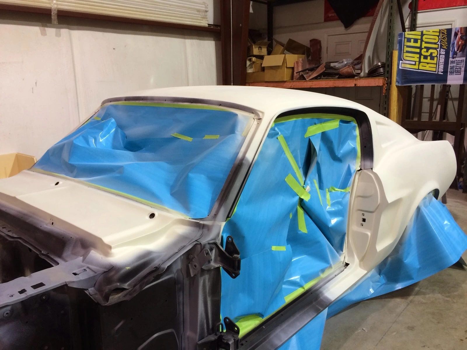

Color is Changin, Reface is on to start blocking #1
We finished getting all the gaps the way we wanted. Fitment has been done and now we have taken her back apart and will start finishing all the surfaces.. we started with UPOL Reface to block it down.
Its nice to finally see it all in one color!
Clean door jams! Removed the body seams and smoothed it out. Lower smooth C's are in too and you can see the clean look it presents.

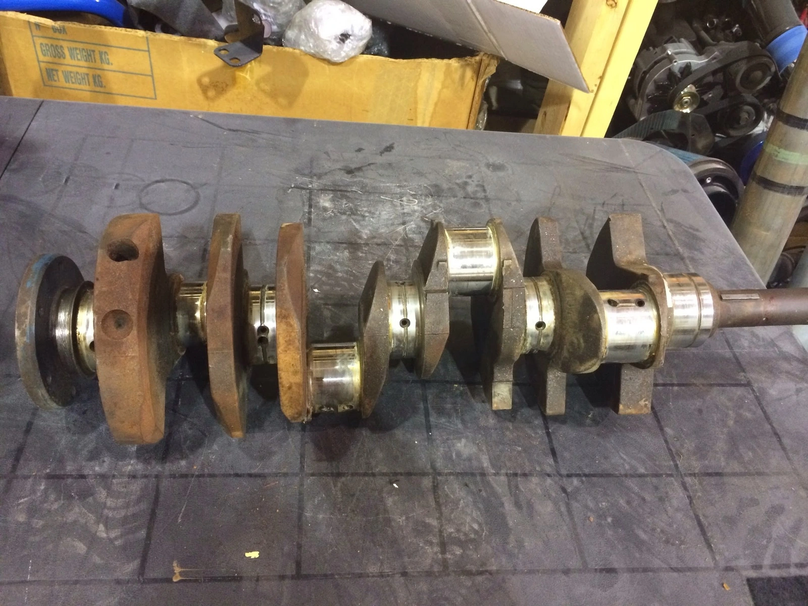

Original 428 Cobra Jet Crank
Yep... have had this for several years stored in the corner, had always thought it was a 390 crank. It's actually a 68 428 CobraJet crank. It mic'd out just fine at 10/20. Gonna have the journals polished and rock and roll. ;)
I've got all the other parts found and needed to build a true FE Iron. An original block, crank and 428 CJ Heads.
Now shopping for the cam.

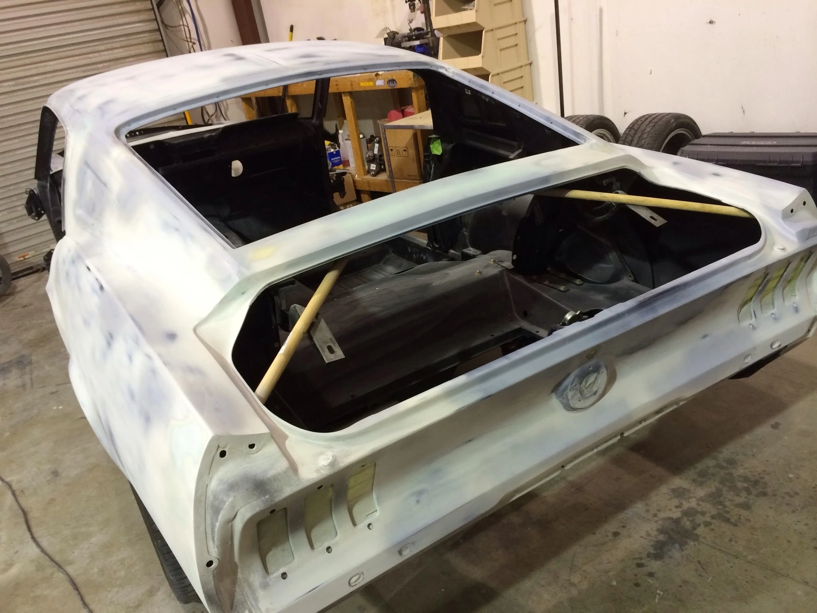

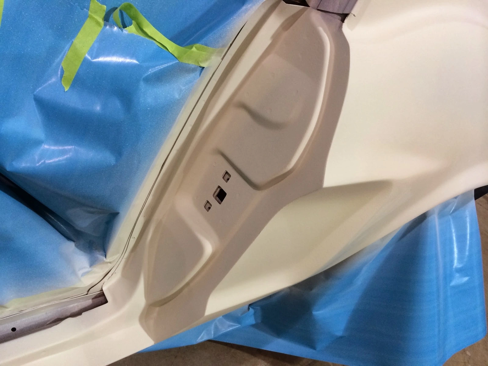

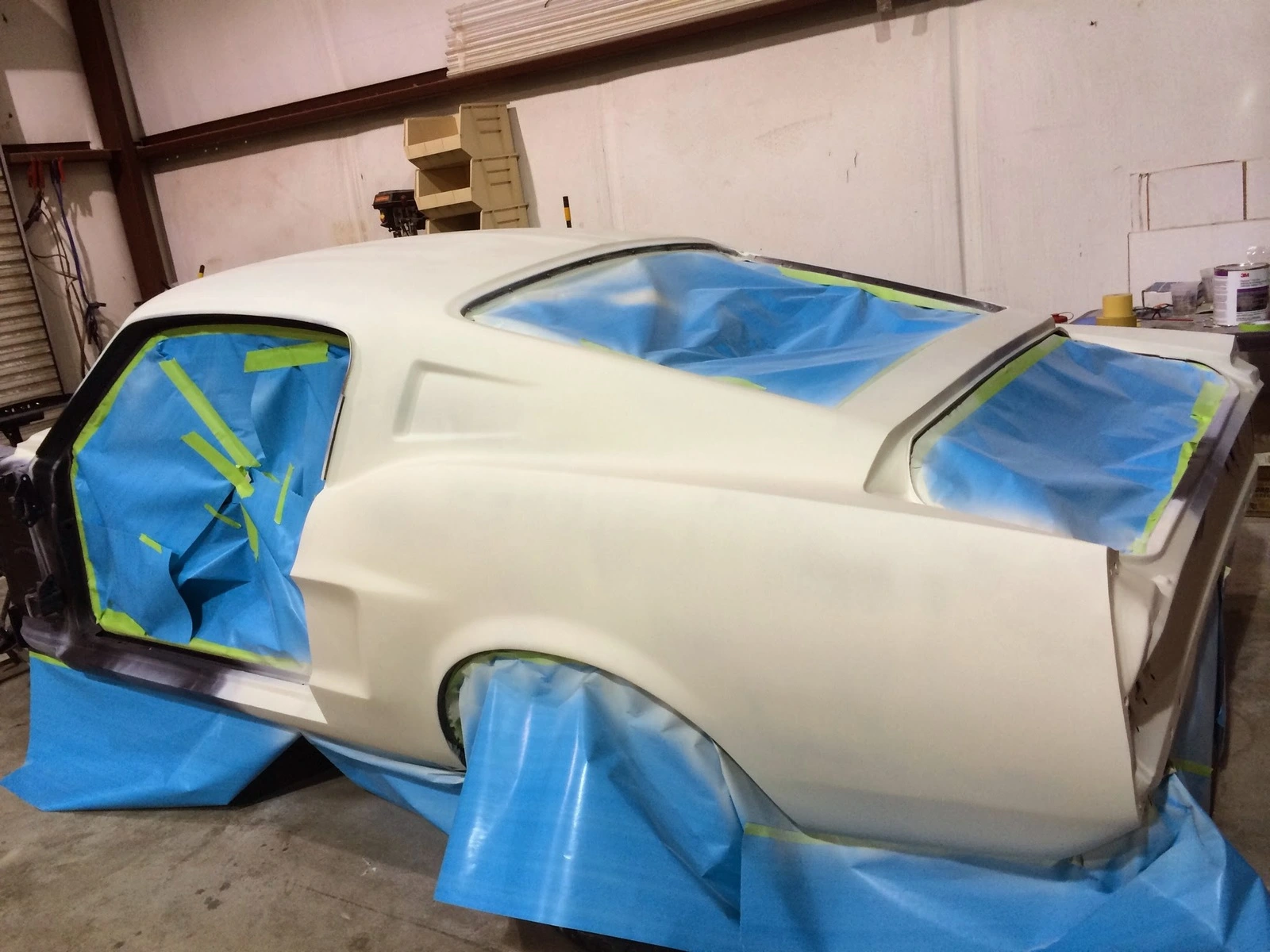

MRaburn updated StangNet's Project 67 with a new update entry:

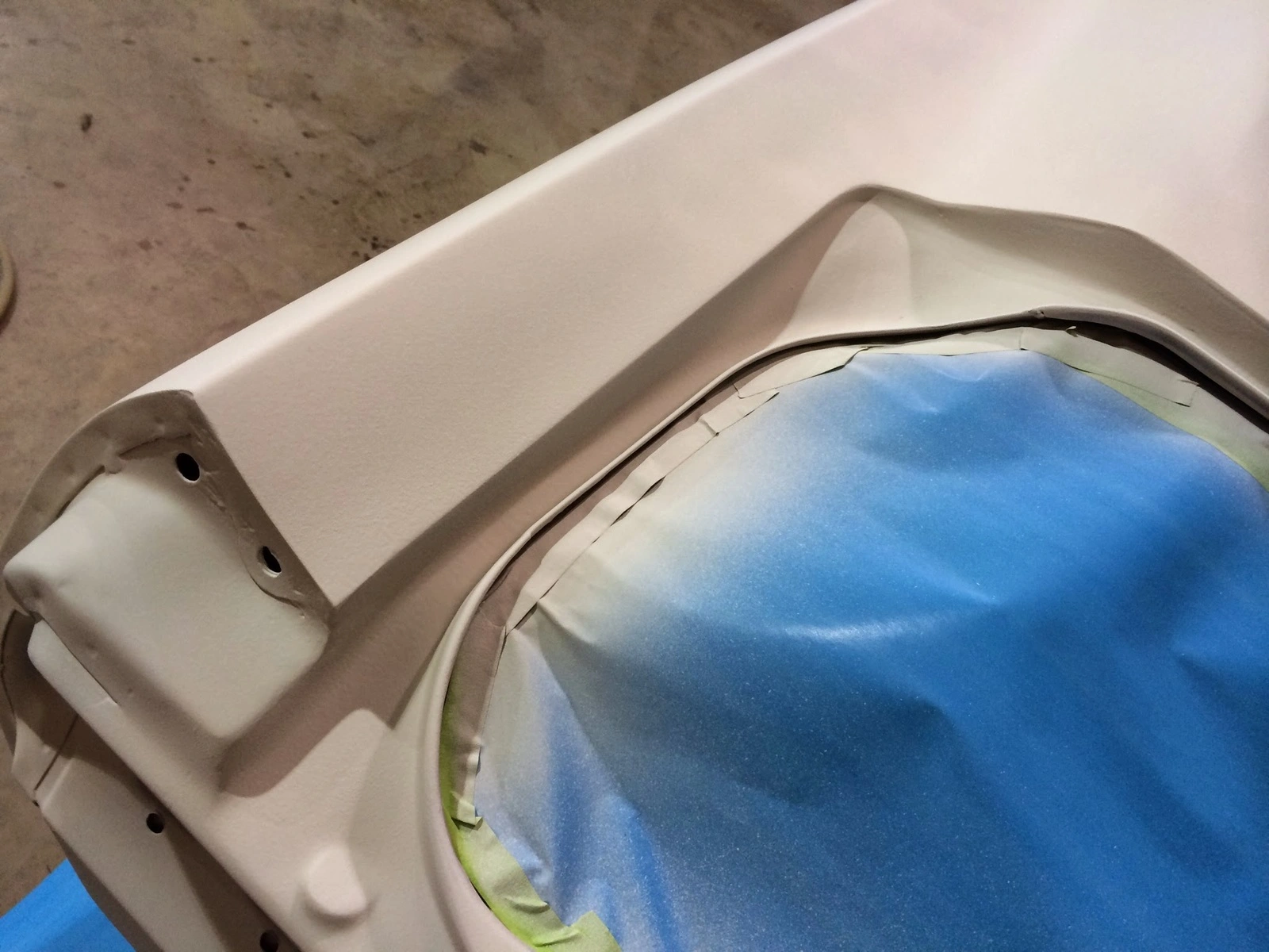

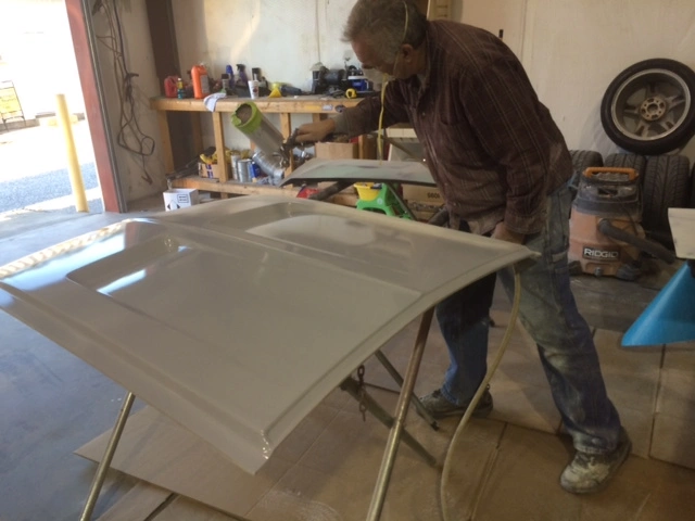

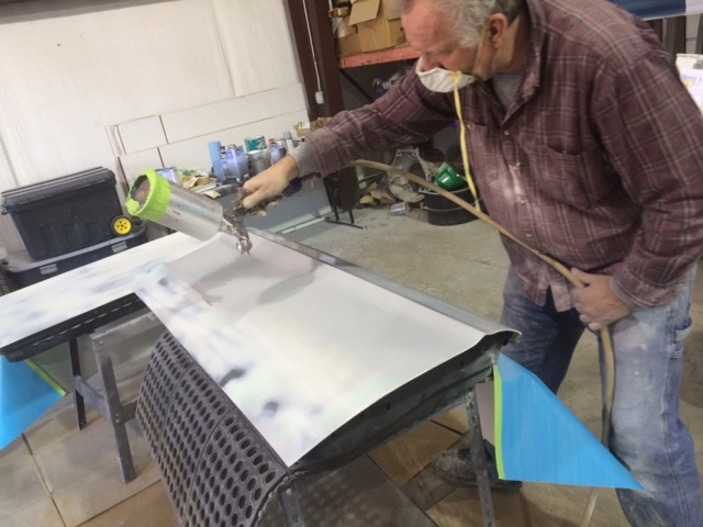

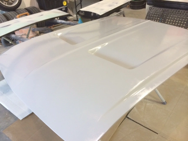

Primer Going On
It's been a bit slow but the Holidays and colder weather has slowed up down.
The intial blocking has been done with Reface and now primer has been applied to the doors, hood and deck lid. These will be wet blocked again to make sure there is no question they are straight.
The body will be going on the rotisserie soon and having the under body done, engine bay painted and jams cut in with paint.
Stay tuned!
photo 1.webp photo 2.webp photo 3.webp ...
Read the rest of this update entry...

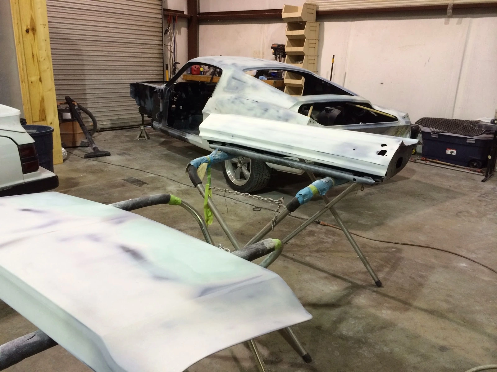

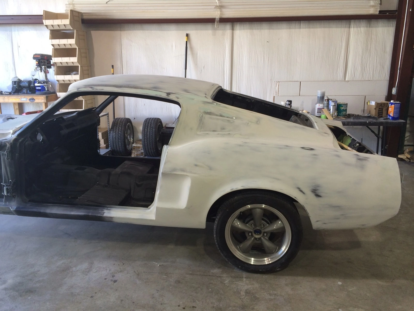

Body In First Primer
Slow and steady! First coat of primer is on. Only 2 more blocking's to go. :) We will then start on the bottom the car, seam sealer, coating and body color. Then we will put the suspension back on and make a roller again.
The car will be painted twice. First round is just to get color on everything and lock it down. We will then build the car out, dings and scratches can fall where they may, and then we will assemble the entire body, sand and paint again to get the metallics the way we...

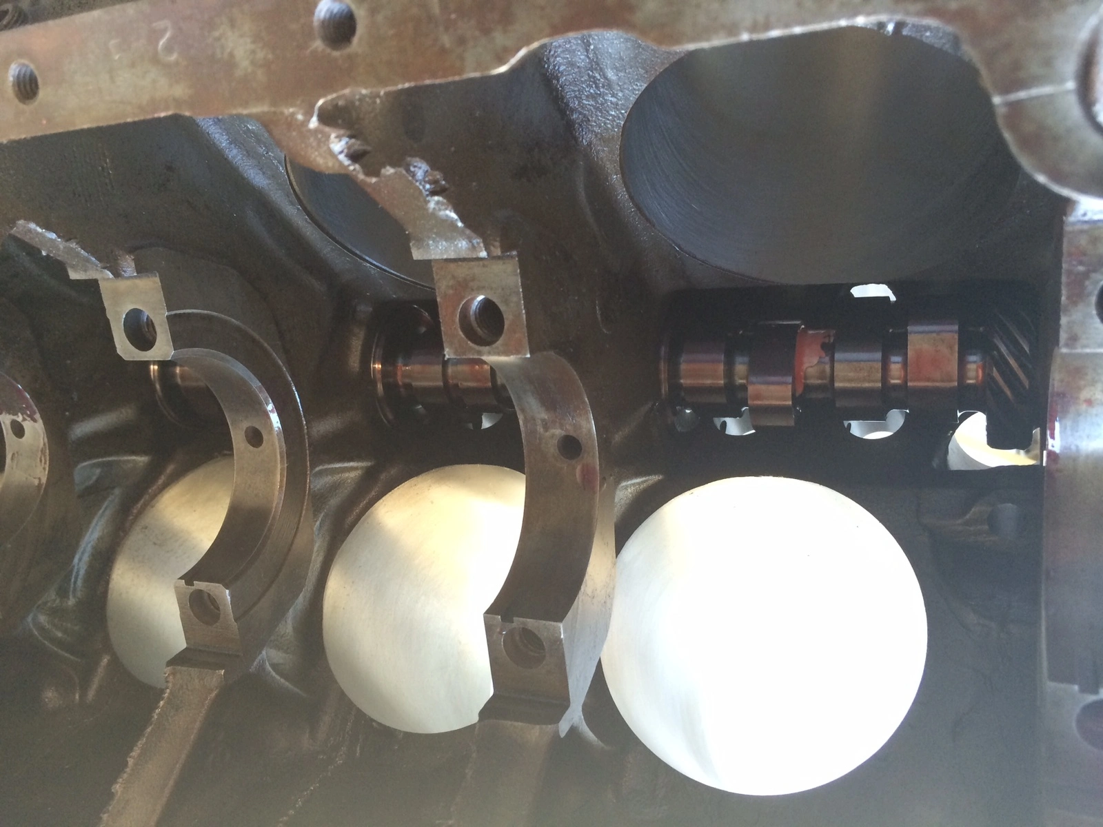

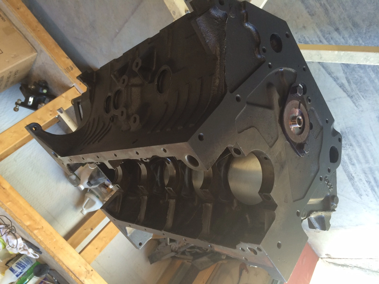

Engine Update

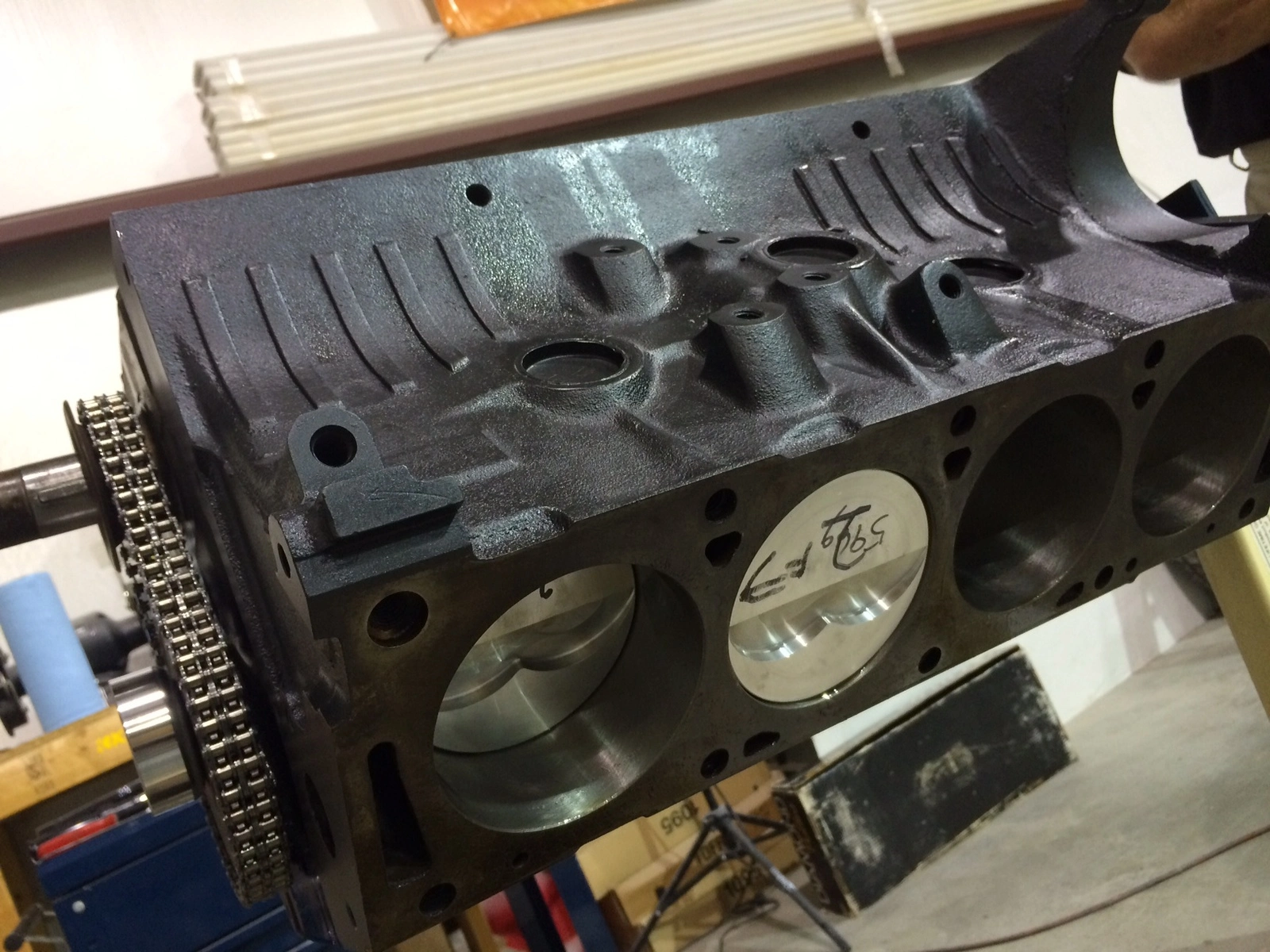

The 428 CJ is coming along.
This is an all Iron (Fe) setup. We have an original 69 428 block, CJ Crank and CJ Heads.
So far...
428 CJ Iron setup
Comp Cams and Rocker Kit
Eagle Rods
Diamond Pistons
Our calculated compression is about 11.5:1.
The block is bored and honed.
The heads have been worked and built.
Crank, Cams, Rods and Pistons installed.
Thanks to Comp Cams for helping...

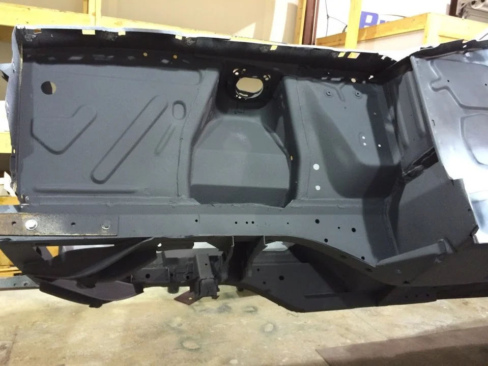

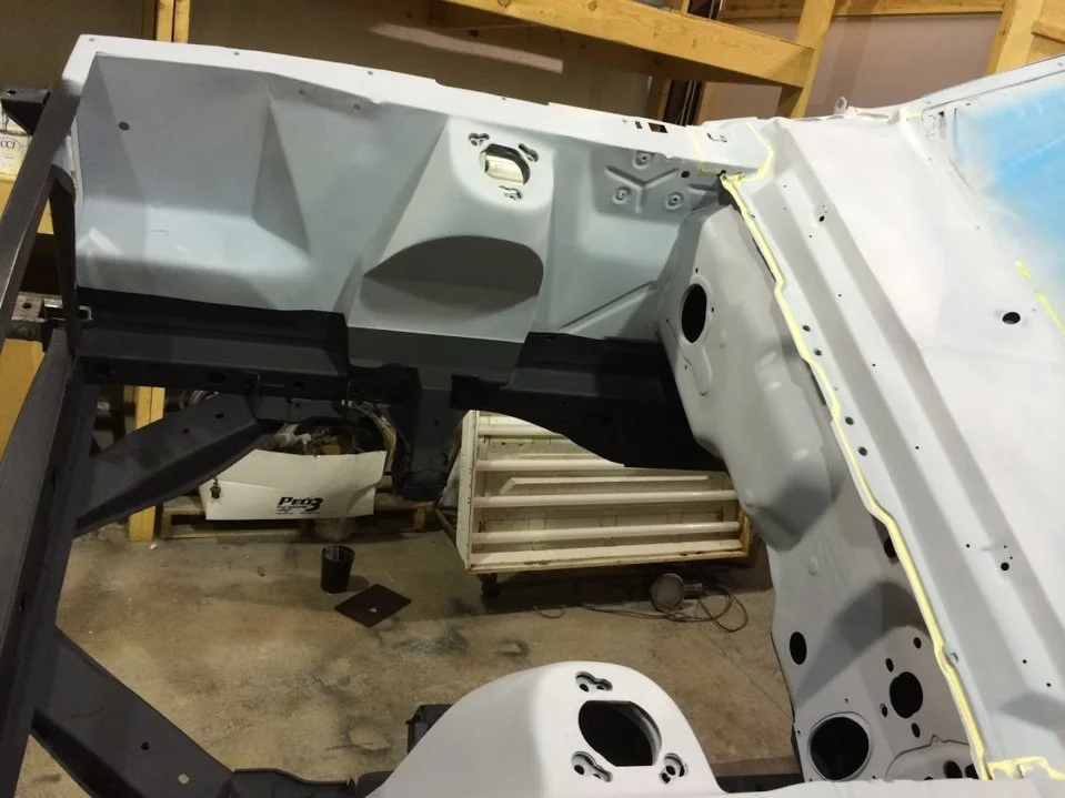

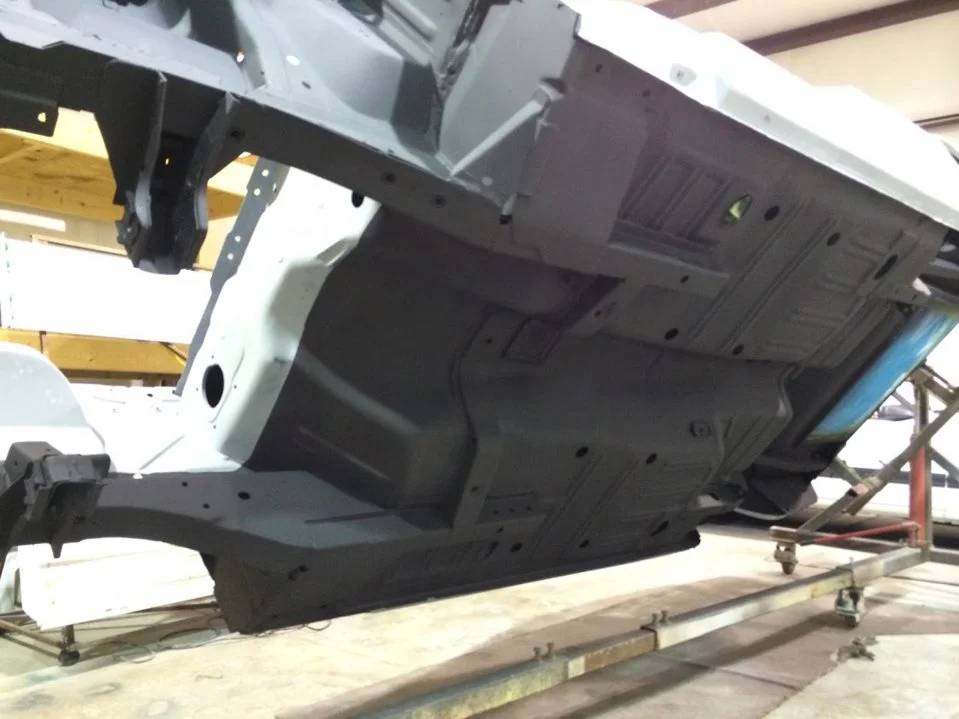

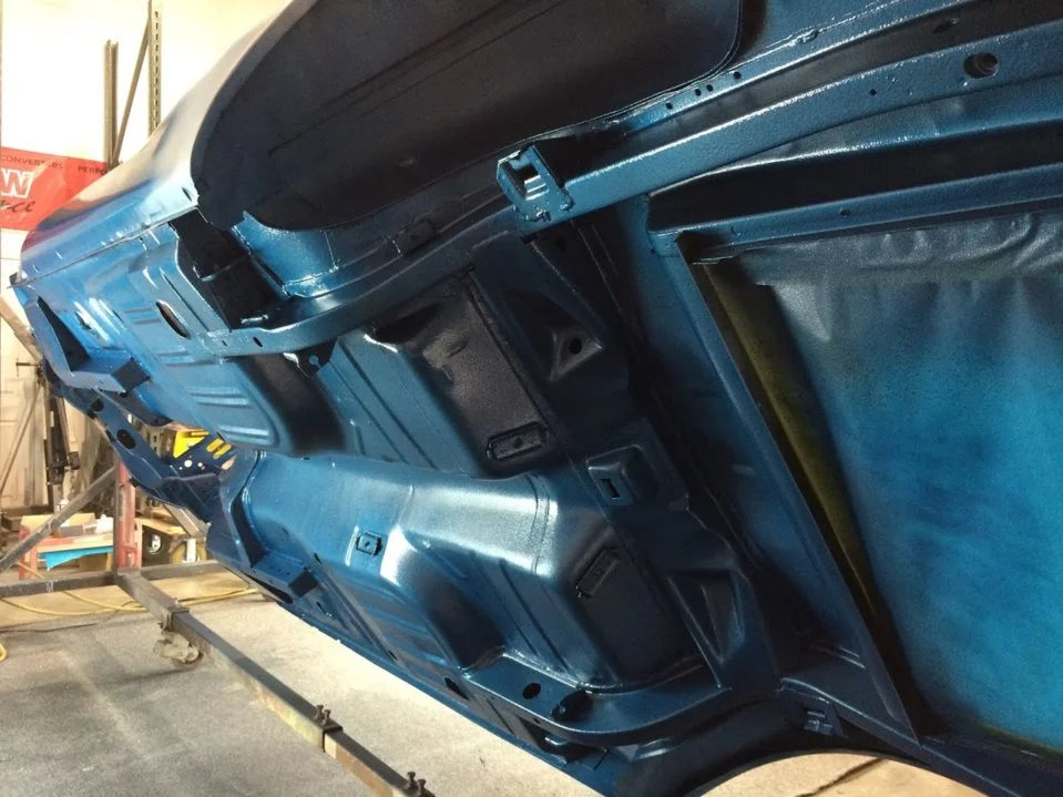

Paint! Cut in the jams, engine bay and underbody
Today we were finally able to get some Guardsman Blue on the 67.
We cut in the door jams, engine bay and underbody.
For the underbody we did a bedliner coating from Gravitex (UPol) and the sprayed on the blue then clear. The suspension, lines and driveline should pop! ;)
Next we will be putting the suspension back on and starting on the engine bay. Stay tuned.
