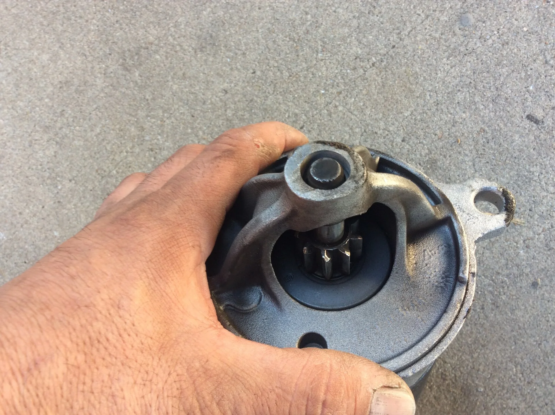

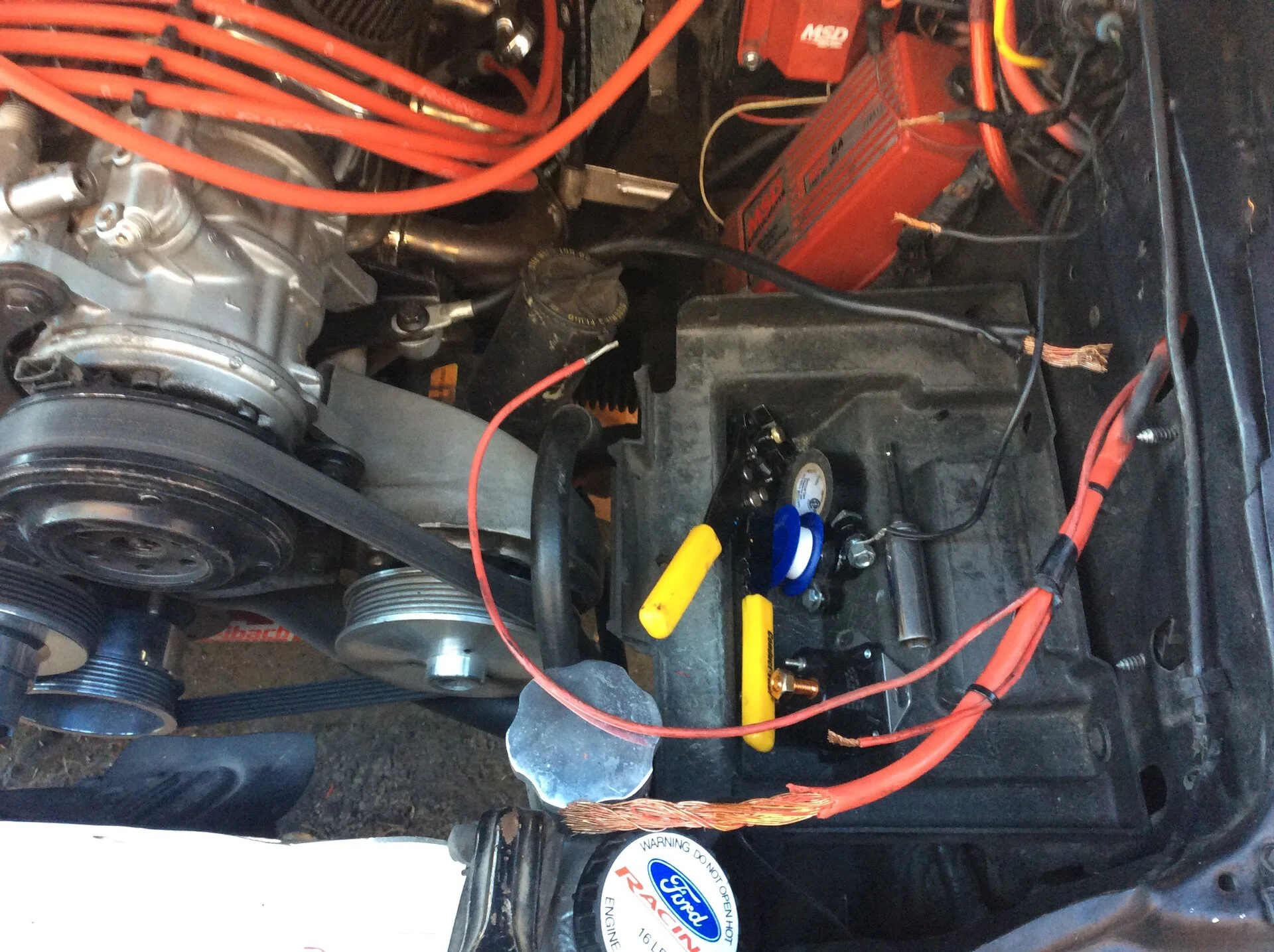

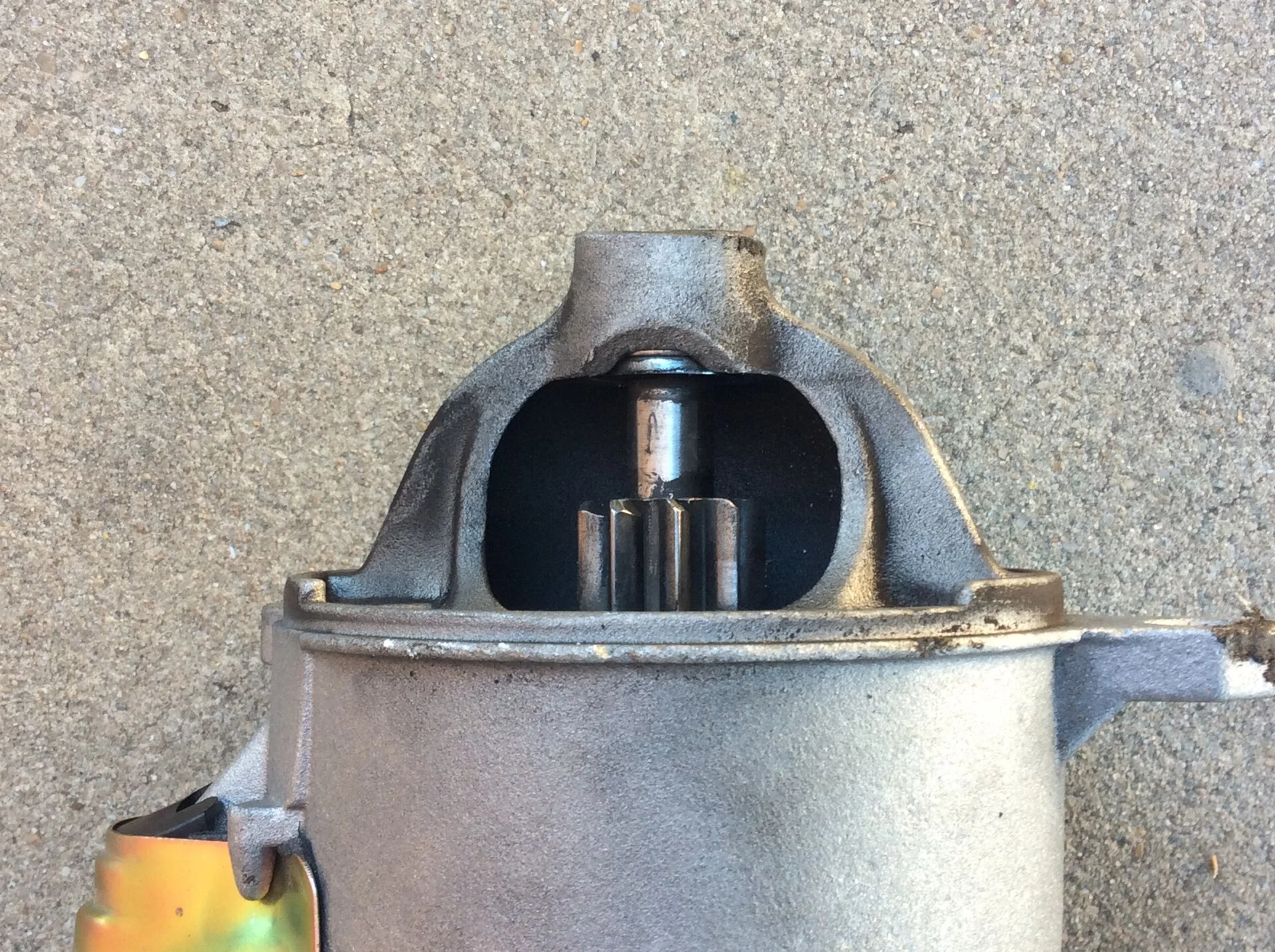

Actually the wires were not corroded I’ve only had them few months. As a matter a fact last week I cleaned all connections on the solonid and added dielectric Greese. I took some pics of the starter. Damm thing looks good. The teeth on there look good. The wires from the battery got hot! The battery terminals the black and red one bent and cracked and cracked a bit. I’m afraid that it “passes” because it did end up starting but like I said sounded clacking something tapping fast in the flywheel area. Sounded crazy. As for the battery do I stIll need to have the battery charged? Reason I ask is because I checked the Voltage with voltmeter and it shows 12v on Anolog one.If it shows good on there doesn’t that mean it’s charged?Good idea to still have it load tested?

@General karthief
Without the car here it is hard to definitively agree or disagree about how the wires are. From the first post, of course the cables got hot. Does that mean stuff got hot enough to burn the insulation? If so, they need replaced, But new cables might immediately cook from the same sticking solenoid/starter relay.
If the insulation got soft but not burned on the cables, like when my last battery was dying at within a month of ten years and the solenoid started to stick, the cables could be fine, but the starter Bendix might be over spun and rattled.
I’m not picturing this is the same situation as the alternator issue car in another post. If it is, that’s different. Any of the smaller wires that are nasty need repaired.
So, an inspection is a good idea.

Yea wire insulation got soft. When it was happening it was smoking slowly from those terminals. I didn’t know what to do so I panicked and just yanked wires with my hands. Burned my fingers a bit

Now you have a better description and pics, @General karthief was right in assuming the worst.

I wouldn't mess with that starter, get a new one,
Those wires look to be ok but I'm not there so use good judgment on wire condition.
