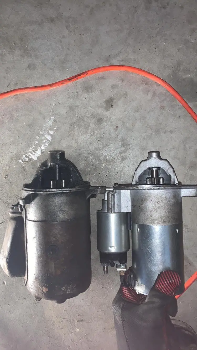

Initial startup with the stock starter worked fine, it struggled to turn the engine but it worked good enough until I could get a PMGR starter delivered.
With the PMGR installed, it made a terrible grinding noise as if the starter and ring gear were not meshing properly. (Still started the car)
Took the PMGR off and out the stock back on until I could try another PMGR (figured it may be faulty)
Stock worked fine until a couple days ago when I tried to start it with 4/8 plug wires connected by accident (oops) and ended up flooding the engine causing a few hard starts and kickbacks on the starter.
All of a sudden the stock starter starts making the same grinding noise the PMGR did, as if the gears arent meshing.
I thought maybe I ruined the stock starter (probably on its way out anyway) so I put a close-to-new stock starter back on and it makes the same exact noise.

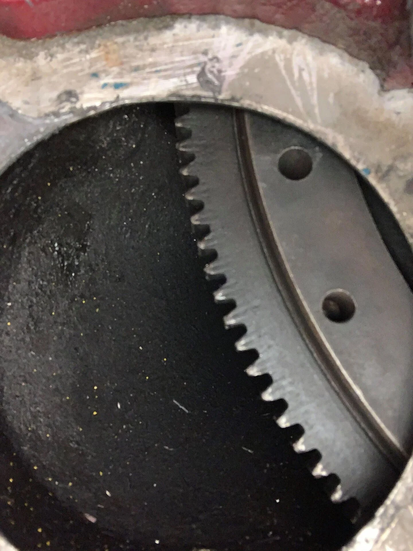

I can see the teeth on the flywheel are a bit chewed up from the Hi torque, but nothing serious. I cant imagine that would cause it not to mesh. Although, it does still start the car.
I am at a loss and really dont want to have to replace the flywheel. Everybody is telling me this issue lies on the ruined ring gear teeth.
