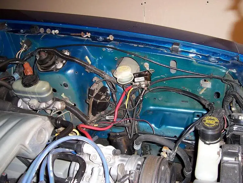

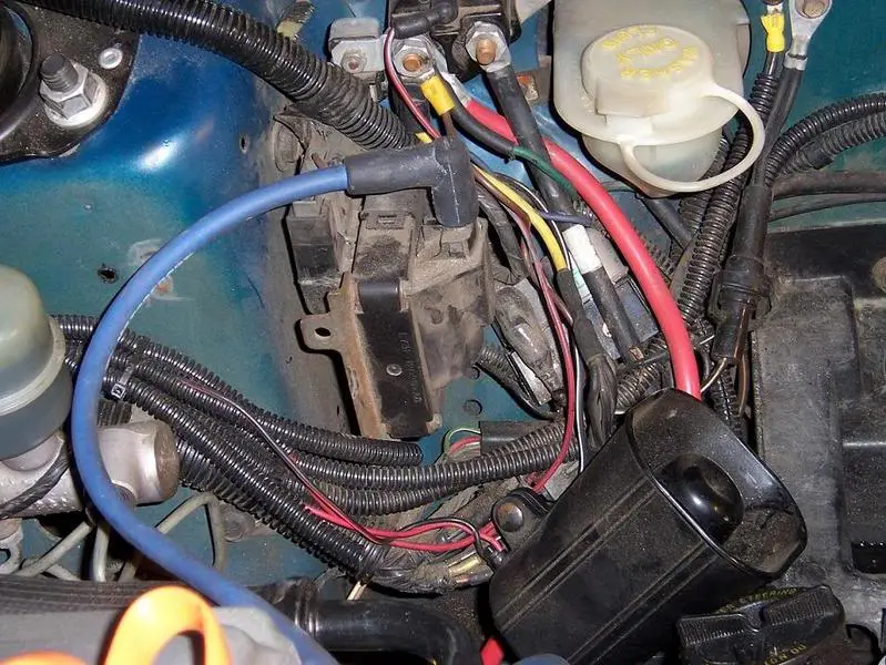

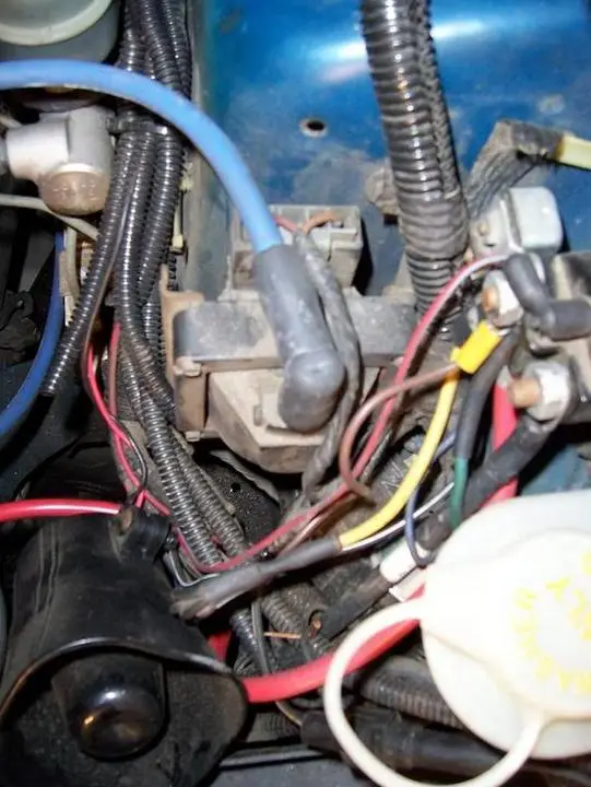

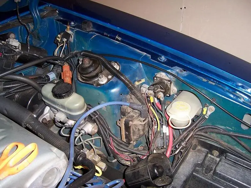

Everything except the starter cable goes on the firewall side. If you have the mini-starter with two wires, the smaller one goes on the front clip side. I will see if I have a pic on my computer.
Here are some pictures:
