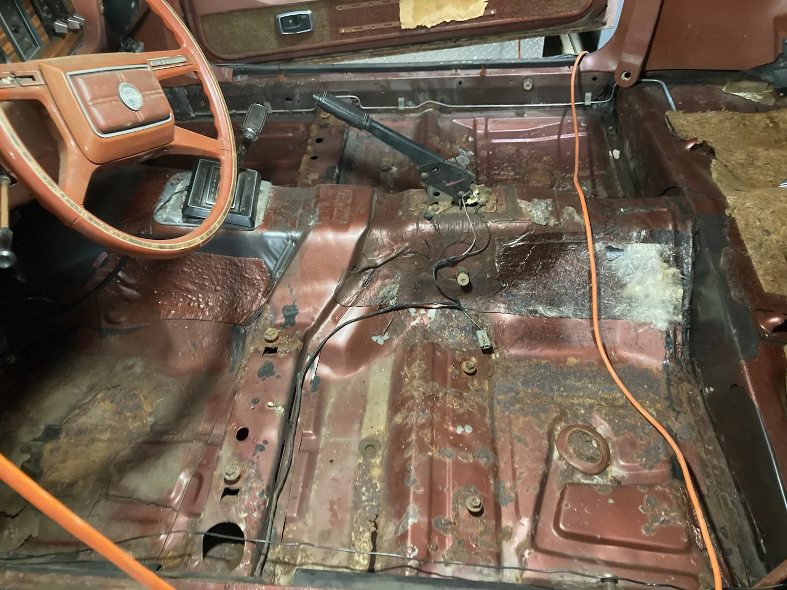

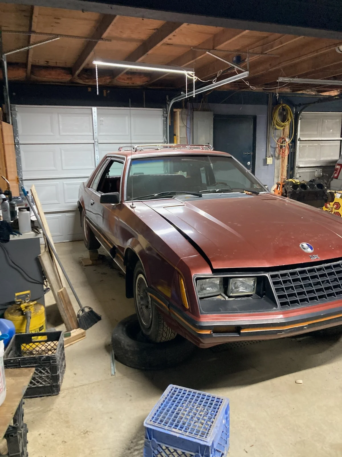

Anyways I've had aspirations of building a 393/408W stroker for quite some time so I've acquired a couple early 70's blocks. I've recently "rescued" a relatively solid 1979 notch that I stumbled across that has been sitting since 1990/1991. Last state inspection expired 3/91. It had been sitting in a garage since then basically untouched that is the PERFECT candidate. 200 I6 with a C4. Despite sitting for most of its life, it's not so perfect that I feel bad for not leaving it stock, but it's a very solid car. Next to no rust except the floor pans and some surface rust here and there. My first plans include replacing the floor pans, subframe connectors & acquiring an 8.8 somewhere. I am unsure of whether to tackle floor pans first or do subframe connectors. Opinions? I want this thing to be straight and square, so I want to follow the correct order. I am very mechanically inclined; I can do just about anything but oddly I have next to no welding experience. I plan on at least doing the floor pans myself. Any pointers from those who have done it before? I am looking at the pan replacements from LMR.
Attached some photos. One of the car, the other of the floor after ripping out the carpet

I would do the floor pans first. You don't need anything extra in the way in the case that they intersect.
Once everything is solid, level the car on the suspension and put the connectors in.
The ones I have bolted in to secure them in place for welding. It was simple.
Agree with Noobz. Get full length subframe connectors like the Maximum Motorsports units or the Global West units. I have drilled small holes in the flanges on them and then ran self tapping screws through the hole and into the subframes on the car to get them under the car and held in place to weld. Have also had to use a couple of floor jacks to get them tight on one or two but if you do this you cannot lift the car whatsoever as the suspension has to be fully loaded when these get welded in.
Difference between the Maximum Motorsports units and the Global West units is where they physically sit under the car. The MM's go under the factory subframes and the Global West's mount to the side so they provide a little more ground clearance. I run the GW's on both my cars but its all personal preference as both do a great job and both offer seat supports for the rear of the front seats.
Nice find, I also had no welding experience before doing my floor pan (only the rear driver's side patch) and the SFC's (I did the MM units). I'm pretty sure I have pics and details of my experience in my build thread linked below, I did that work back in October of 2017 if that helps to find the right pages.
I did my SFC install first so that the car would be "straight" when I did the install (LOL, I learned later there was nothing straight about my car), and I also used my welder to install cats into my ORH pipe as I was tired of the smell from the exhaust. Get some scrap metal to learn to weld with and start burning stuff together.
Thanks for the replies all. I'll definitely do the pans first. I'll order the pan replacement pans as soon as LMR has them in stock again. They are out of stock for both sides. LMR seems to be the go-to for replacement stuff for these cars so I'll stick to them unless you guys have other recommendations. Fortunately my 91 has zero rust as it started life as a southern car, so I haven't had to deal with this before.

I had no hopes of this thing even having brakes when I bought it, but much to my surprise, I found the brakes worked when we were unloading it from the rollback. Just tinkering around, I tossed a battery in it within an hour of getting it home to see what worked. I hit the key and it began turning over. I removed the fuel line from the carb and it shot stinky, old, pine sap smelling gas out, so I hooked it back up and shot some ether down in the carb and it actually ran & idled on 30+ year old gas. I was blown away. It pulled into my garage under it's own power. Obviously I need to go over everything and drain that junk out of the tank, but I look forward to running this old girl on occasion.
Anyways, I don't know if anyone is in the market for a 200 I6 & a C4, but it's for sale if anyone wants it. I really hate to scrap it.

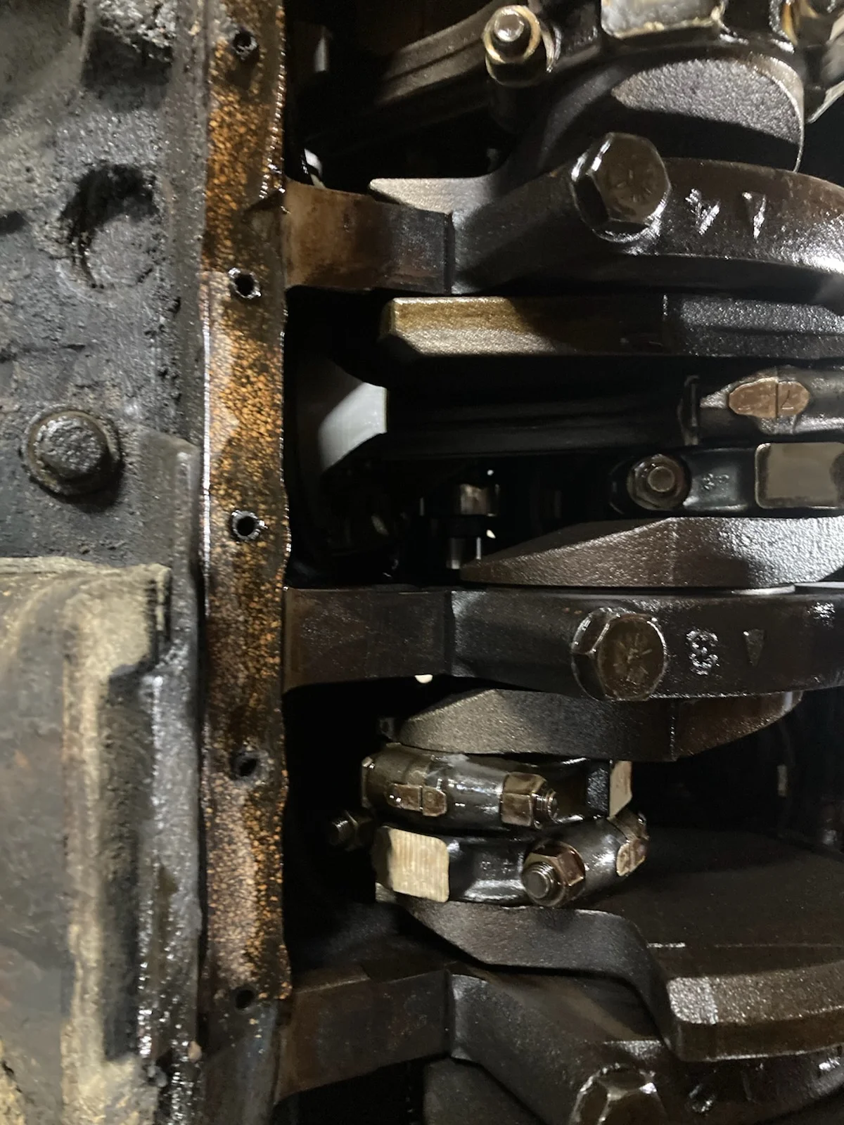

It seems like there is a lot of ambiguous information out there regarding which 351W's are the "heavier" blocks, so I thought it would be worth sharing what I have run across in hopes of it potentially helping someone else:
The picture below is of my 71 block (D1AE casting with a casting date of June 2, 1971) Notice how the webs have a machined surface and if you were to compare it to a later block, you'll notice that the webbing is noticeably thicker. I have a D4AE down to the short block in my garage, but don't have a second engine stand to take comparison pics.
The C9 block used in 69 and 70 were the same way, but had a shorter deck height. The deck height was increased in 71 with the D1AE casting. In my experience, I have not seen the thicker webbing with D2AE or D4AE blocks. The reason I say this is because the claim is that 69-74 blocks are all cast with thicker mains. I do understand though that a D1AE COULD have been cast...say.. in 1973. I have no insight on that though.
I plan to get this thing off to a machine shop when the weather breaks here. Still scouring marketplace for parts as I go.
