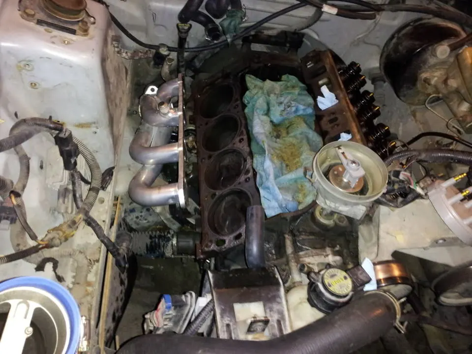

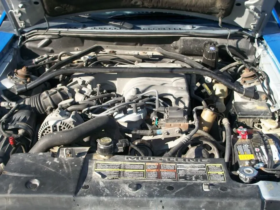

Alright well things have been pretty slow, here are some pics
This is day one when i got the mustang
here it is as it sits in the garage right now
on a side note what is the best way to get the gasket material off of the block? Ive seen everything from using a razor blade and brake cleaner to buying these plastic wheels you can attach to your drill and buzz it off.
2nd There are some smaller particles in the bores and was wanting to know the best way to get that stuff out? there isint much but I would like to know if this would effect anything?
3rd what the hell is up with the power steering bracket? lol didin't know i had to buy a puller for the thing, wanted to pull the head but guess not. Sorry about the picture quality if its bad, they were taken with my phone so I will try and get better pics later
I generally use a gasket scraper, and a razor scraper to get gasket material off. To get small crap out of the cylinder bores, I use foamy engine bright to foam it up, then suck it out with a shop vac.
You don't need to buy the pulley puller, Autozone and Advance rent it.
Kurt
