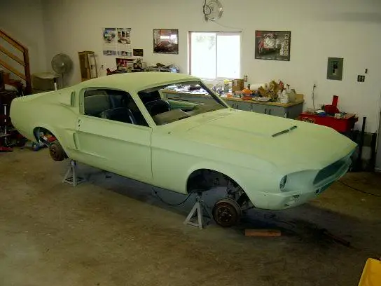

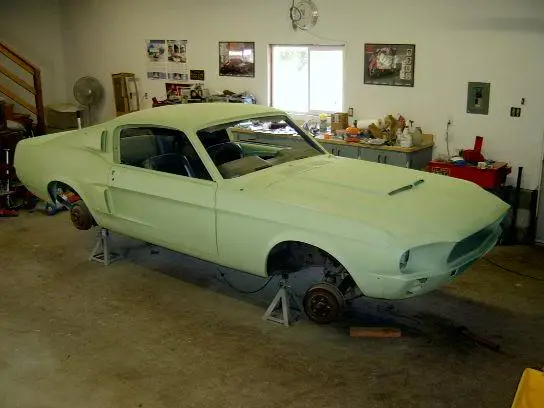

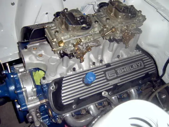

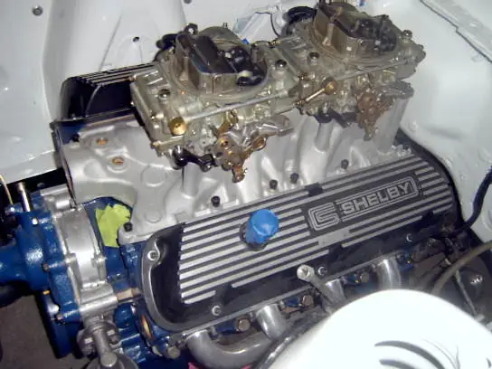

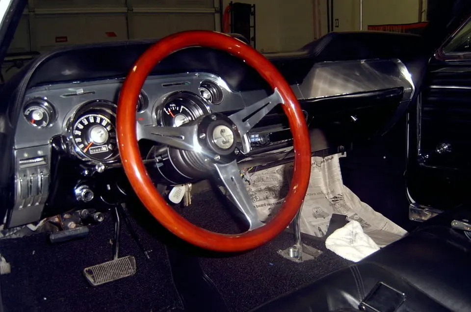

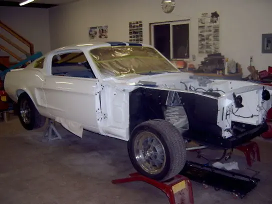

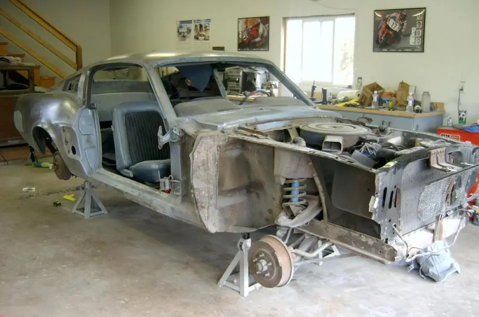

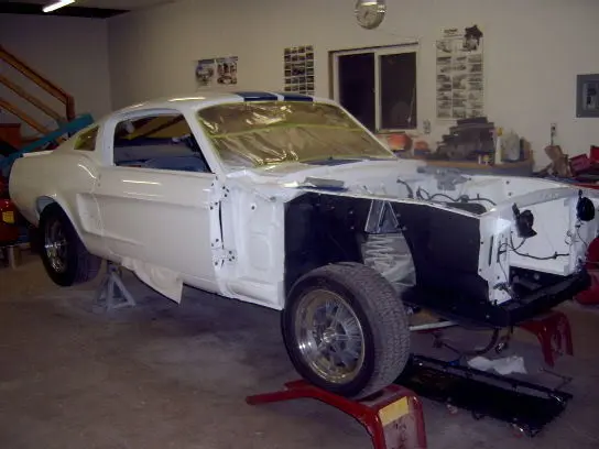

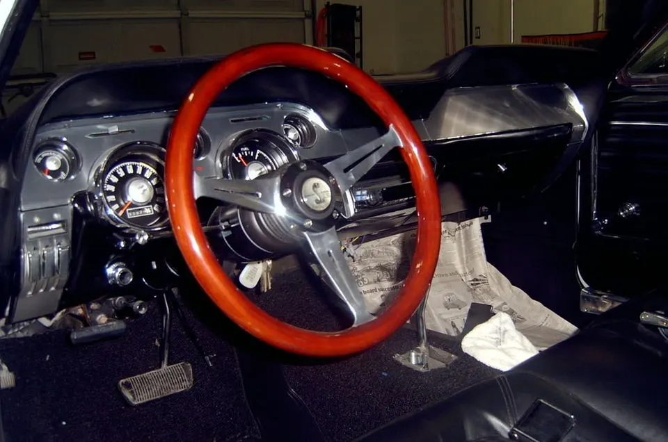

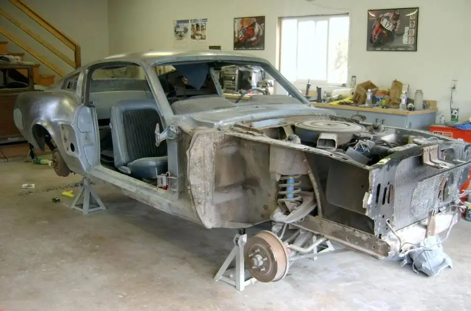

First you need to determine what you want out of your car once it's finished. What's it going to be used for? Car shows, everyday driver, a bit of both? If you want the car to look new and perfect, you need to do things so that one part will not affect the others. For example, I did paint and bodywork first, otherwise you'll get overspray alll over everything else. My method is paint, mechanicals, wiring, interior. But then again, my car was down for and extended time and I didn't need to get it back together in time to drive it to work on Monday. If your Mustang is your primary car, then make it safe first, and try to seperate the jobs into smaller parts to avoid longer downtime. Mine was down for 6 long years, here's the progression:
Doing it this way takes lots of time and money, and the car never made it outside before it was done, which makes it hard to stay excited about a 6 year project, so be warned going in: save twice as much money as you think you'll need and set aside three times as much time. Be prepared for the worst, because there will be times you just want to part out the whole thing and forget about it, but in the end it's all worth it.

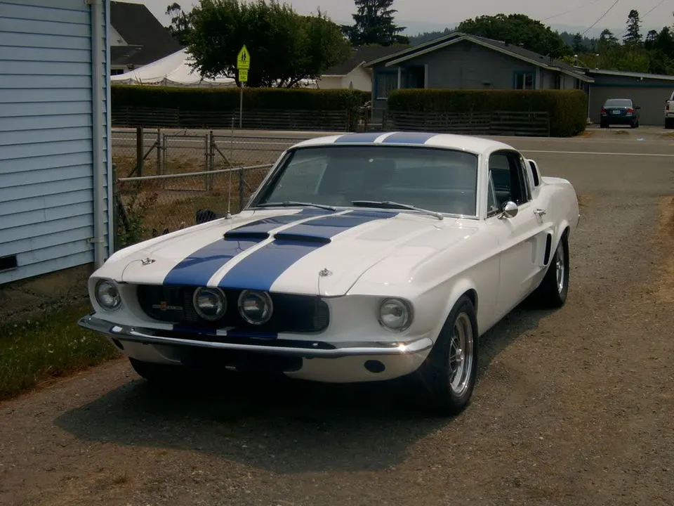

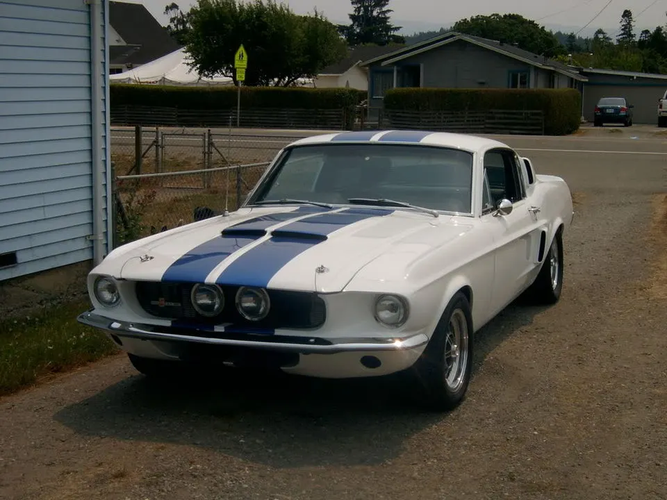

My freind jlangholzj noticed there was no "after" shot of my son in my photos. I realize it actually would help illustrate just how long it took to do the restoration. So here it is:
Mind you, the first pic was taken about three weeks before I took the car apart on Nov 24, 2002 and my son , Chase was about 15 months old. This last pic was taken right before the car's first test drive, the first week of July, 2008 on the same day as the picture in my driveway. Notice no turn signals yet and no rocker stripes, which were put on that weekend. I like how in the first pic, my son isn't quite as tall as the door handle, while in the last pic, he's taller even though he's kneeling down. My how time flies...

I just did cowls on my '68 a couple of months ago. If I had a chance to work non stop on it, probably a week of long days. Not including paint. I'm not a pro and was my first time tearing one down. I also had patching to do on about every part that touched the cowl. Took advantage and drilled about 8 more holes, removed and media blasted the back of the dash, and por 15 it to keep it in good shape. One thing you can count on is more wrong than you think. Also a good time to check firewall and floors. Much easier to repair with the dash out of the car. Really easy to replace wiring or any of those under dash goodies.
I went the patch panel way for three reasons.
1. I'm cheeeeep.
2. I used the style weld cutter that cuts a ring, so I would be able to use them as guides to get the car back the same as it was.
3. I have not found any replacement parts that fit as good as the original parts.
I still found the need for jacking and creative ratchet straps to get all the holes to line up. It is a big job but can be accomplished by anyone that has patience and desire.
