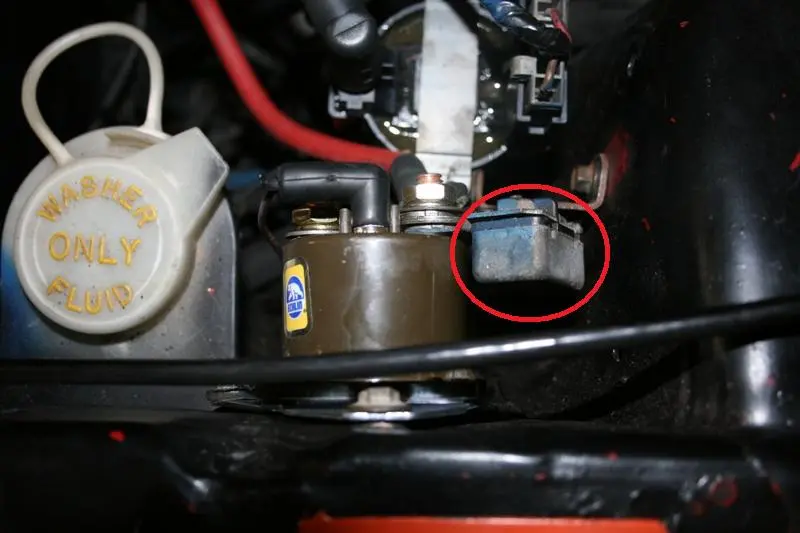

what is this thing on the starter solenoid. its circled in the pic

It is the circuit breaker for the power windows and door locks. See the diagram I posted for more information.

and what wire goes to the part i circled in yellow. does it come from the starter??
