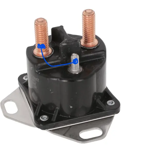

Take a jumper wire and jump the small upper terminal to the post with the batter connections and see if the car will crank doing that, vs bridging the two main terminals.
What i mean by that is touch your screwdriver from here to here and see if it cranks healthily. If it does, this may be an ignition switch issue

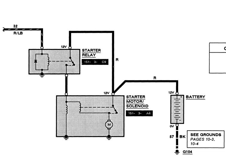

Just for reference the wiring diagram. The above relay would be labeled "starter relay"
I did just that. Jumped from the small stud to batt stud, w/key on and it fired right up. Ignition switch is a new Standard Products unit and all wiring is new.
