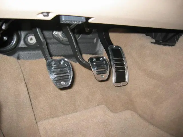

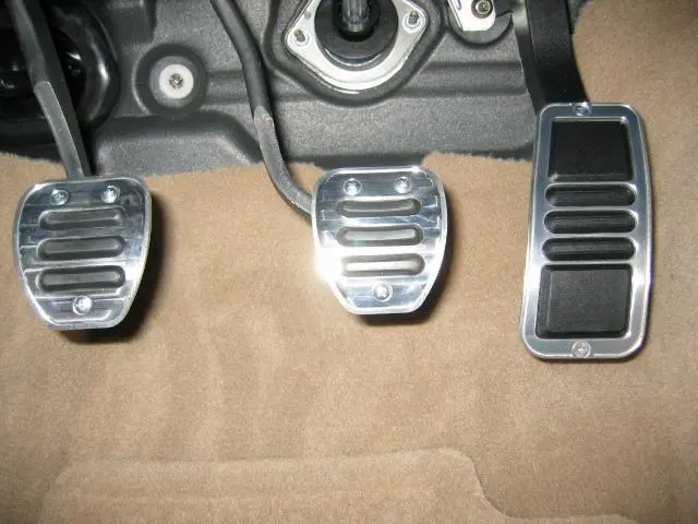

Is it me, or does the carpet not come up high enough?
lol, well looking at your pictures it appears so. I was thinking about pedal covers cause I hate when it rains and my shoes are wet, I feel like im slipping on and off the clutch and it makes a sqeaking noise like walking through a hallway with wet shoes makin all that noise. Do these stop that? since I think its from the rubber on rubber, so maybe these help? thanks
