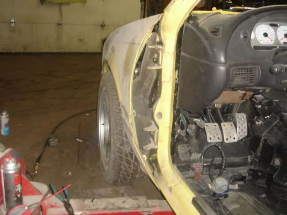

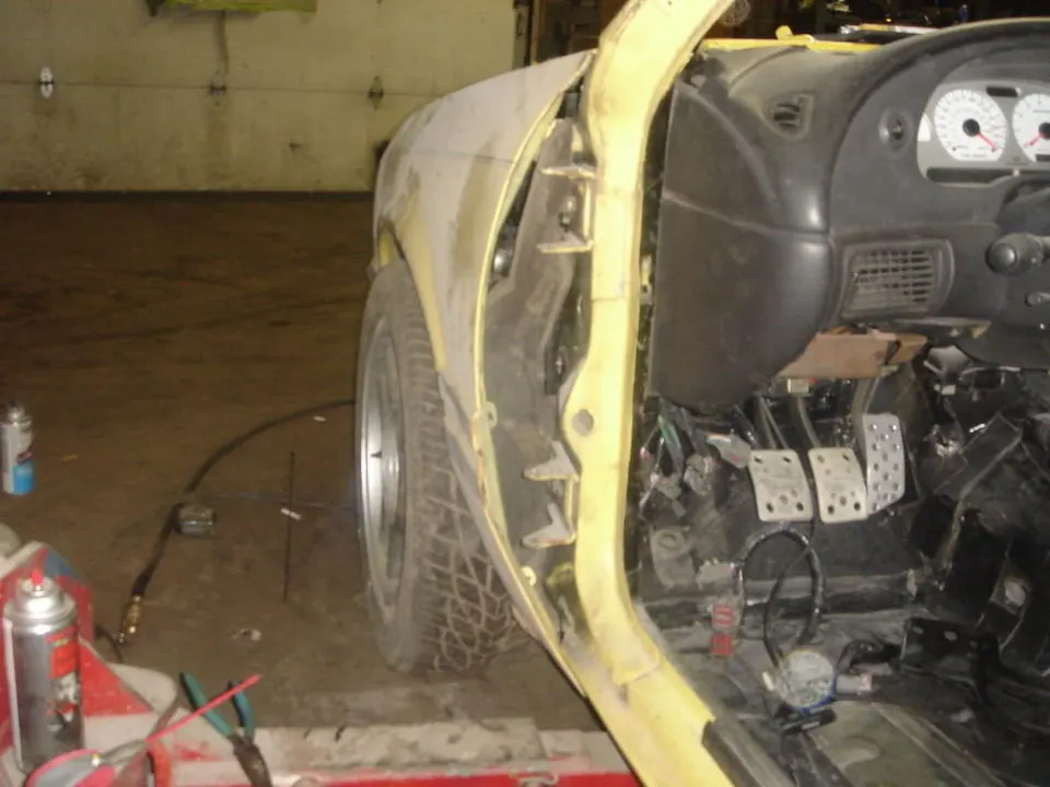

My car isn't finished, and it is a coupe, but still a fox body. KEEP IN MIND THE CAR IS NOT FULL WEIGHT.....I lack doors, interior, hood, bumper, and it is a 2001 2V engine, not a 302. These are Steeda Sport Springs. I have 96-04 front spindles, with stock fox body LCA's and struts.

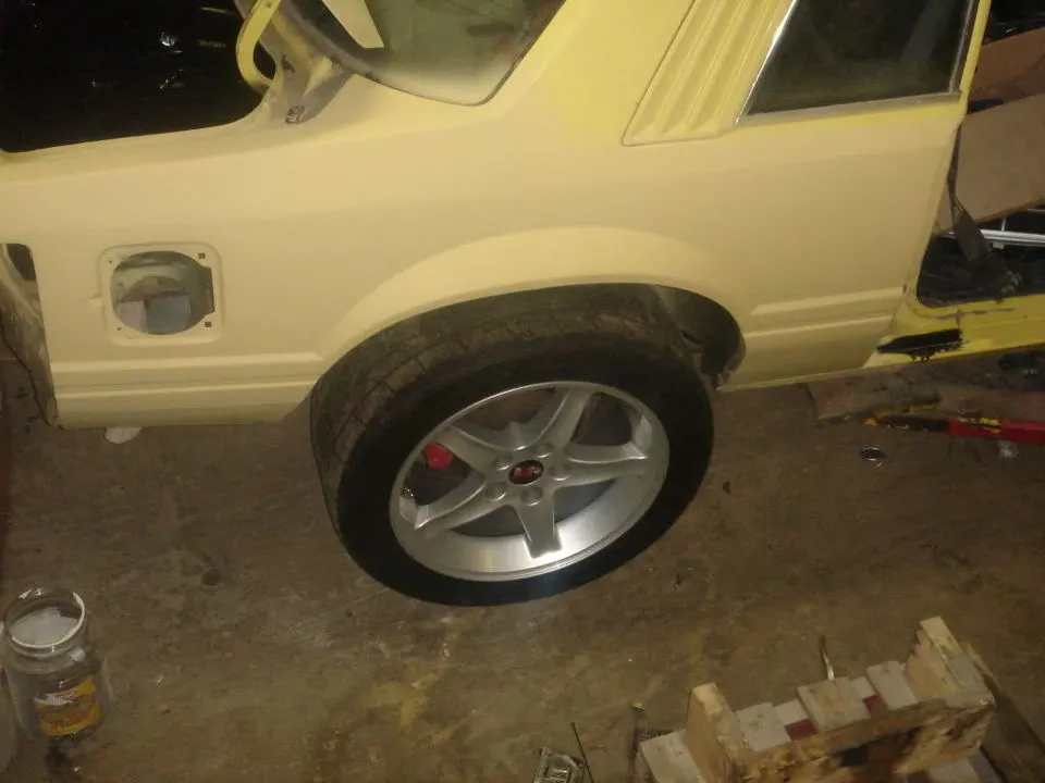

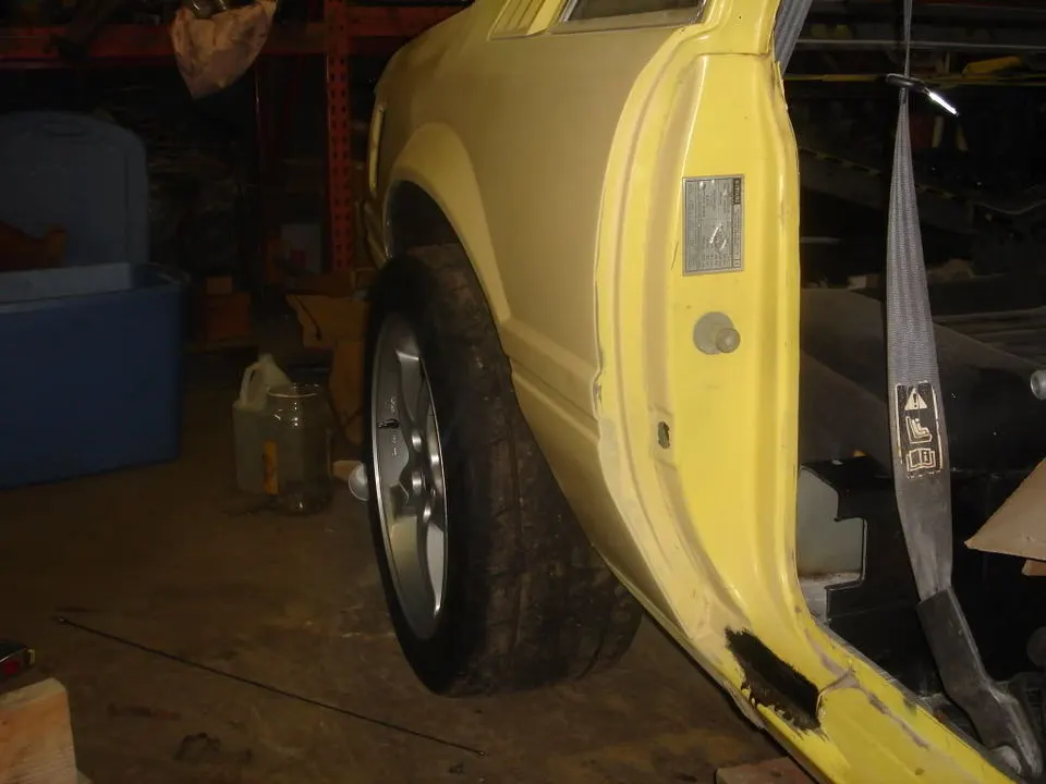

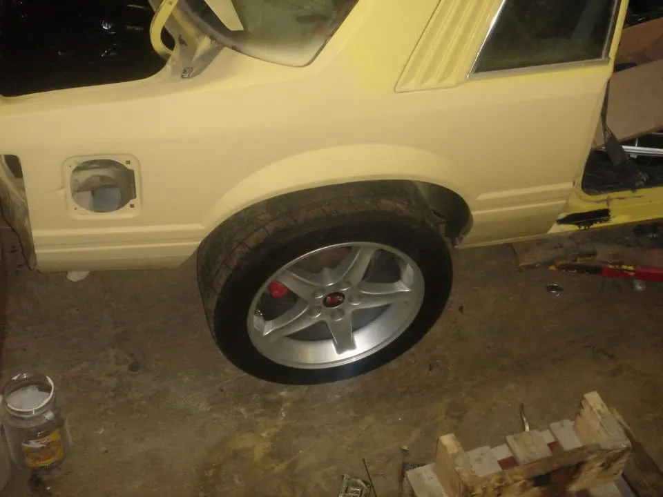

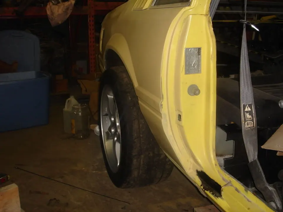

The rear is not low at all. It is the 2001 axle, Steeda Sport Springs, and HPM Mega Bite Jrs LCA's. I have both spacers under the spring that HPM provides. I am going to take both of them out and use a stock rubber or poly isolator. The bottom part of the quarter panel is 29 inches off the ground. With spacers removed it will go down to 28-1/2" KEEP IN MIND THE CAR IS NOT FULL WEIGHT.....I lack doors, interior, fuel in the tank spare, jack, tail lights. I want to get it down to at least 27-1/2". My other notch sits at that height and I like it.
