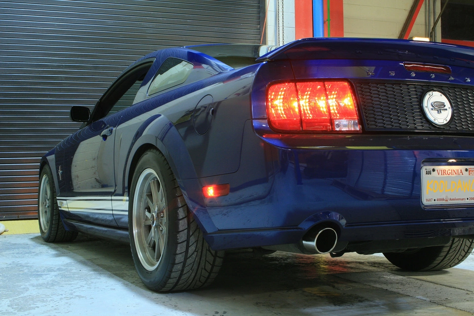

I have the 295/45-18s on on 18x10 at the rear with about 1.25" of drop and it's close, but not TOO close. Another .7" of drop could make a lot of difference however. Perhaps get taller bump stops to prevent the tire and fender from meeting.
You may have seen it, but here is a recent pic of the rear after being lowered.

That's weird. Did you buy the car used? I would not go with anything lower than 1.5" in the rear. You're talking almost an inch more than Kool is lowered and look at that back tire. I would stay where you're at, or get something like the pro kit.
