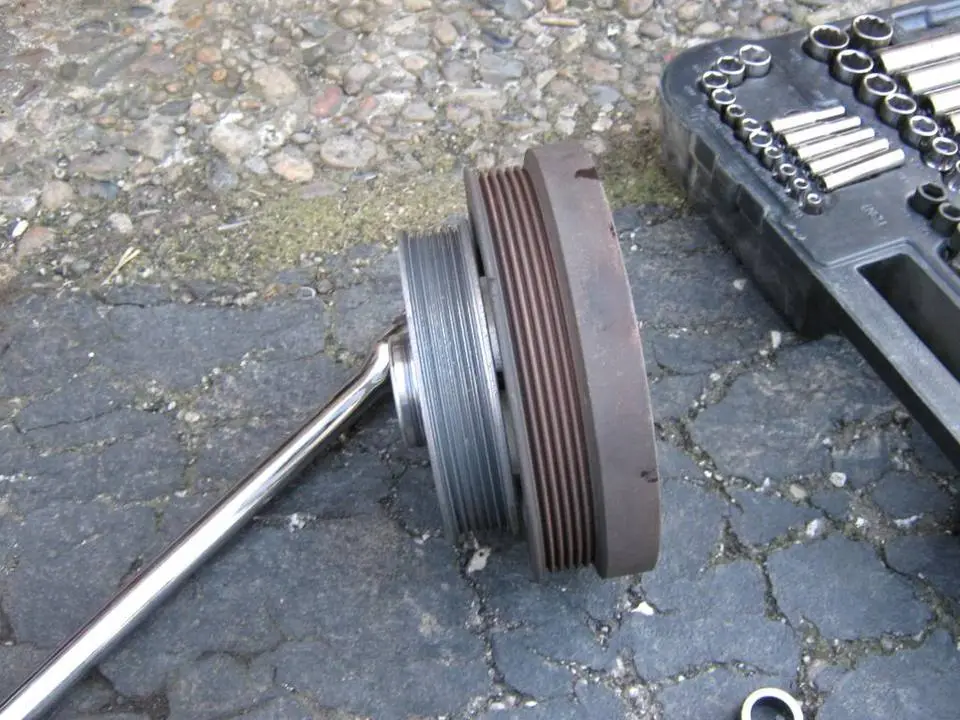

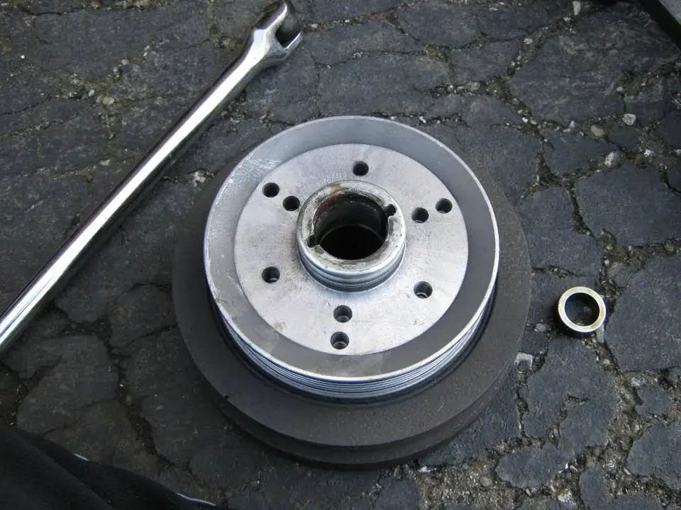

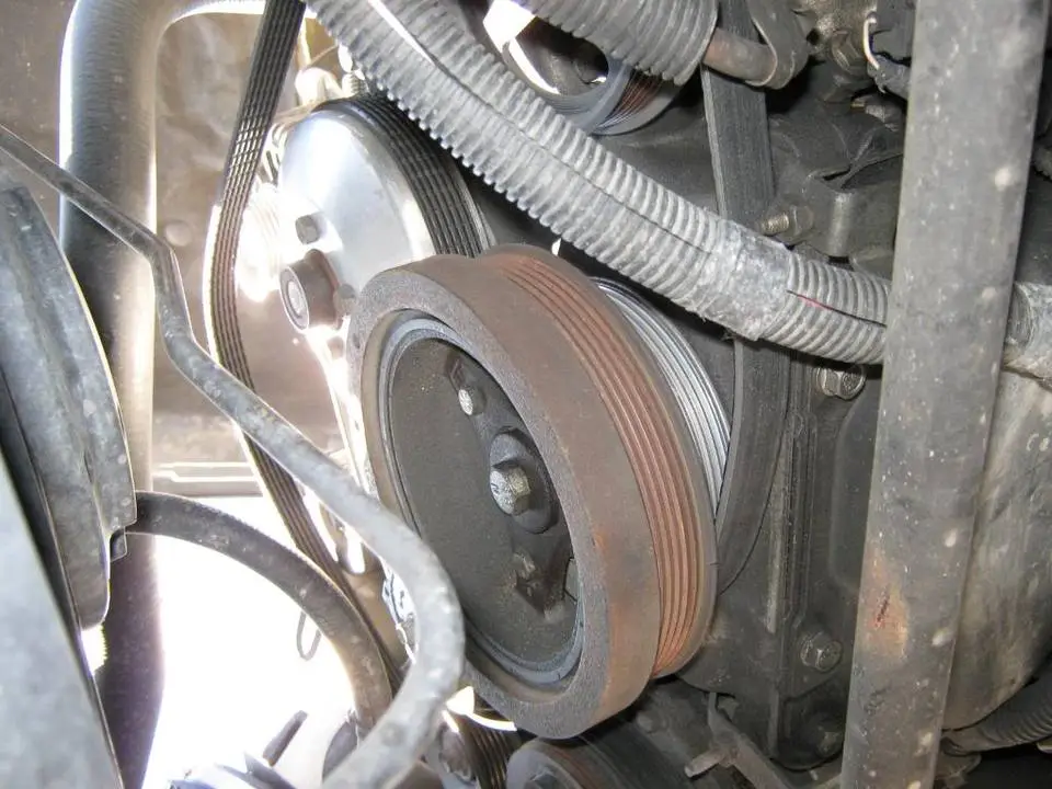

Steeda. Here are some pics of the BBK's I had on there

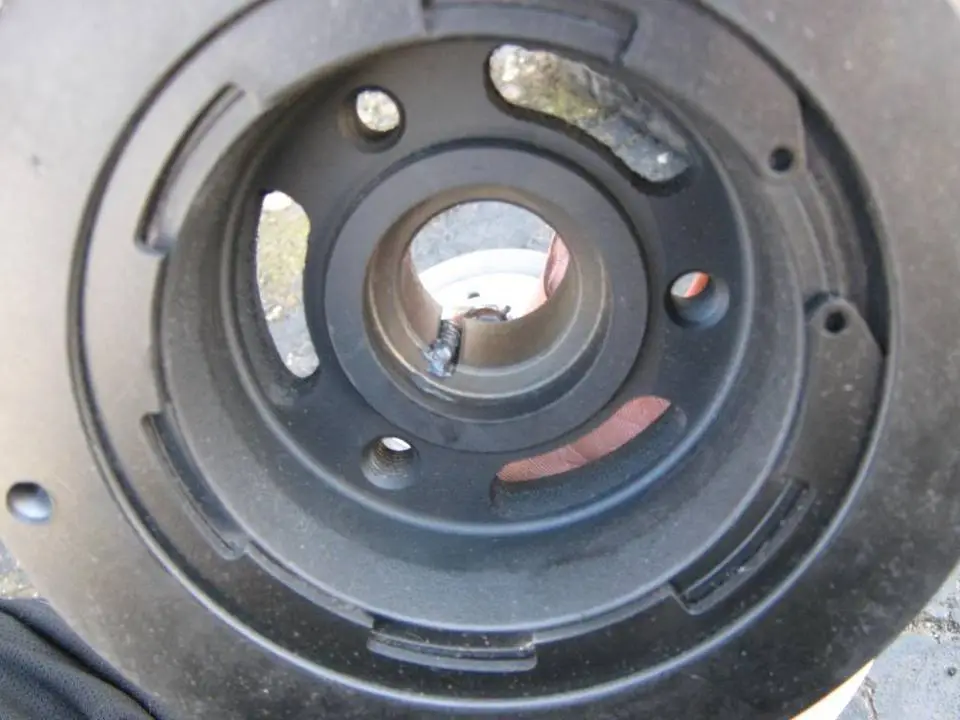

Here is the only one of the Steeda I took, but you can still tell how much more quality they are
