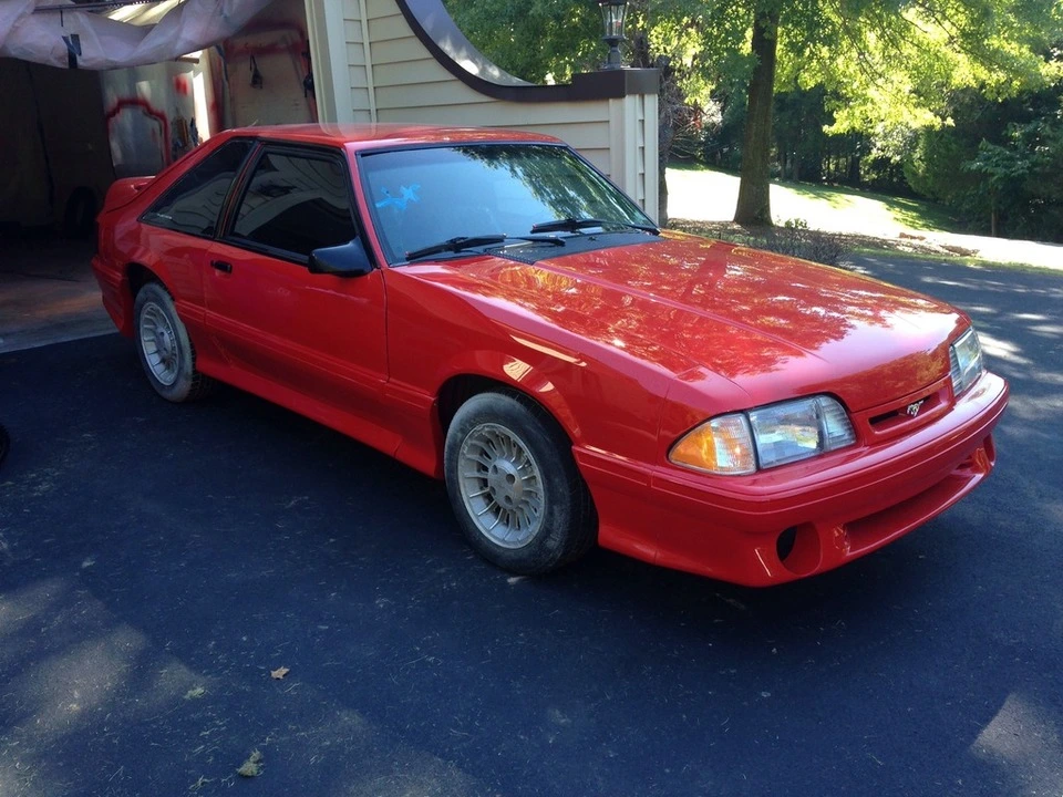

If you aren't opposed to fiberglass, you can get an HO Fibertrends...
http://www.hofibertrends.com/1987-1993stockfiberglasshood.aspx
Here is a pic of it on my car...
