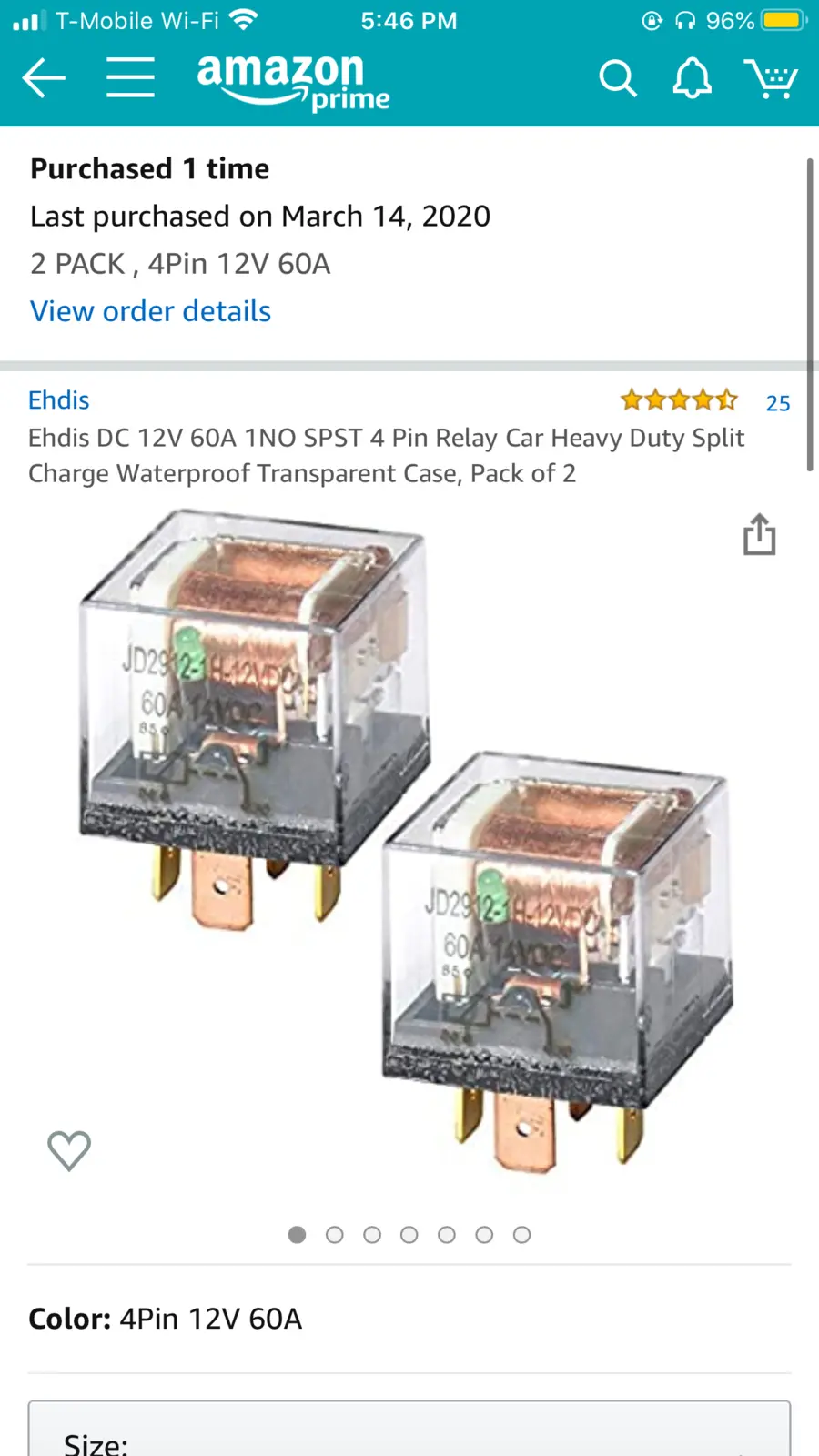

Any idea what type/size relay you used ?
That’s the relay I use. I’d just say screw it and run a 60a with a 60a maxi fuse. Do it once and be done with it.

I want to say mine is setup to provide 12v to trigger the relay. I’m not sure though as I’ve slept since wiring it, but I’m fairly sure it provides power to trigger.
The sn95 fan is what I have it on, which is a 2 speed fan. My 150a alternator helps soften the blow, but it still needs to see a 100rpm increase to keep up. Never seen anything under 14.6 volts on the gauge with the fan running though.
You can’t have a relay that’s too big. A good 40a will most likely do it, but a 60a is the same cost to run (at least it’s damn close)
You can actually find the factory Bosch relays on rock auto. I believe they’re yellow in color. I’ll try and find the link.
