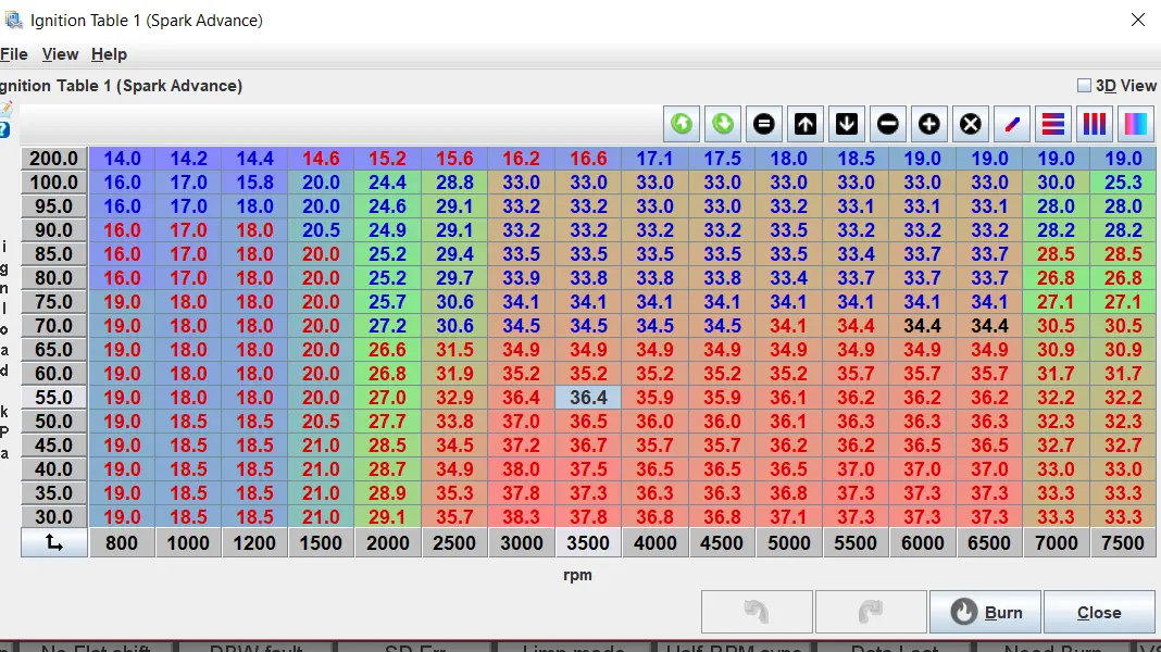

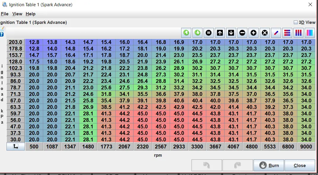

well it looks to me like the fuel table is still in need of some work, and the timing table needs love as well. The timing is most likely going to help the most, you need to adjust the timing up in the lower KPA and RPM areas. You can run as much as 35* at 1400 RPM in the low KPA range.
this lugging [surging] is due to the weak spark you have, and some slightly off settings attempting to turn on CL idle. The CL idle thing is harder to pin down without first addressing the other concerns.
If you like i can send you a picture or a copy of a more suitable timing table I use in My base tunes.

Looking at revised tune and I don't see any changes in timing table.
Could you post that picture your base tune timing table so I can compare to mine?
a91what

This is the table you have been using, its not bad but has alot of room for improvement.
This is the table i loaded into your tune file, I use this timing table in 90% of my MS3 based tunes.
