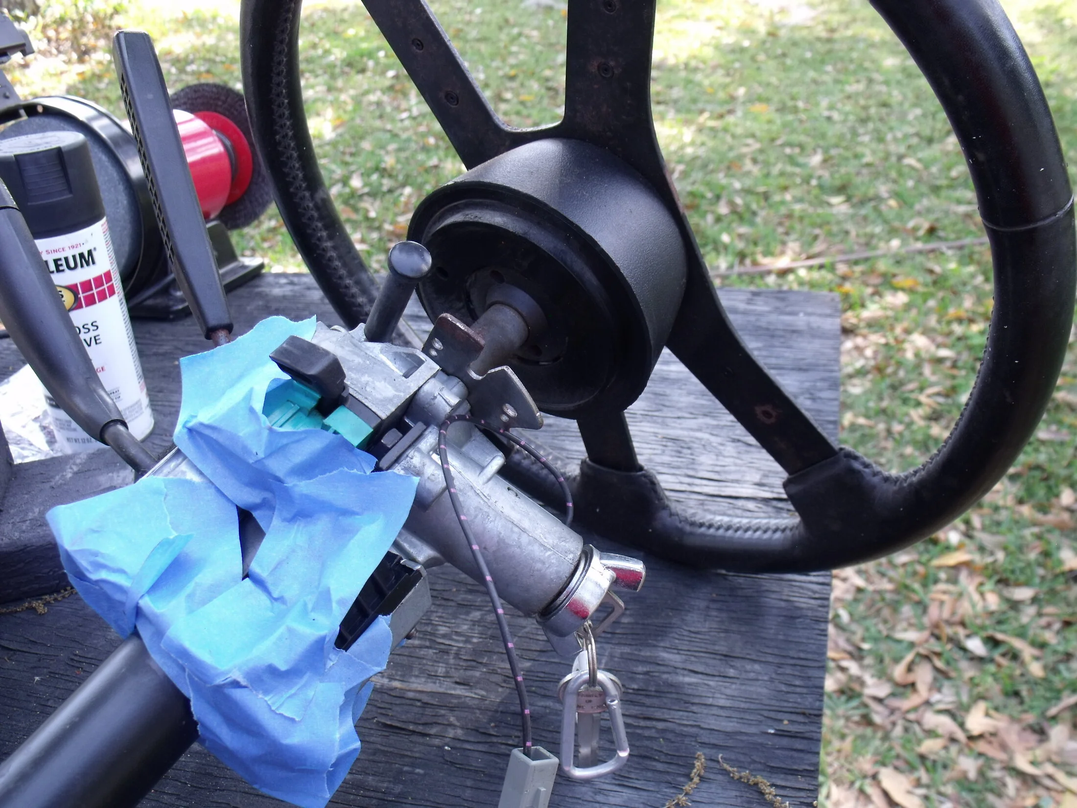

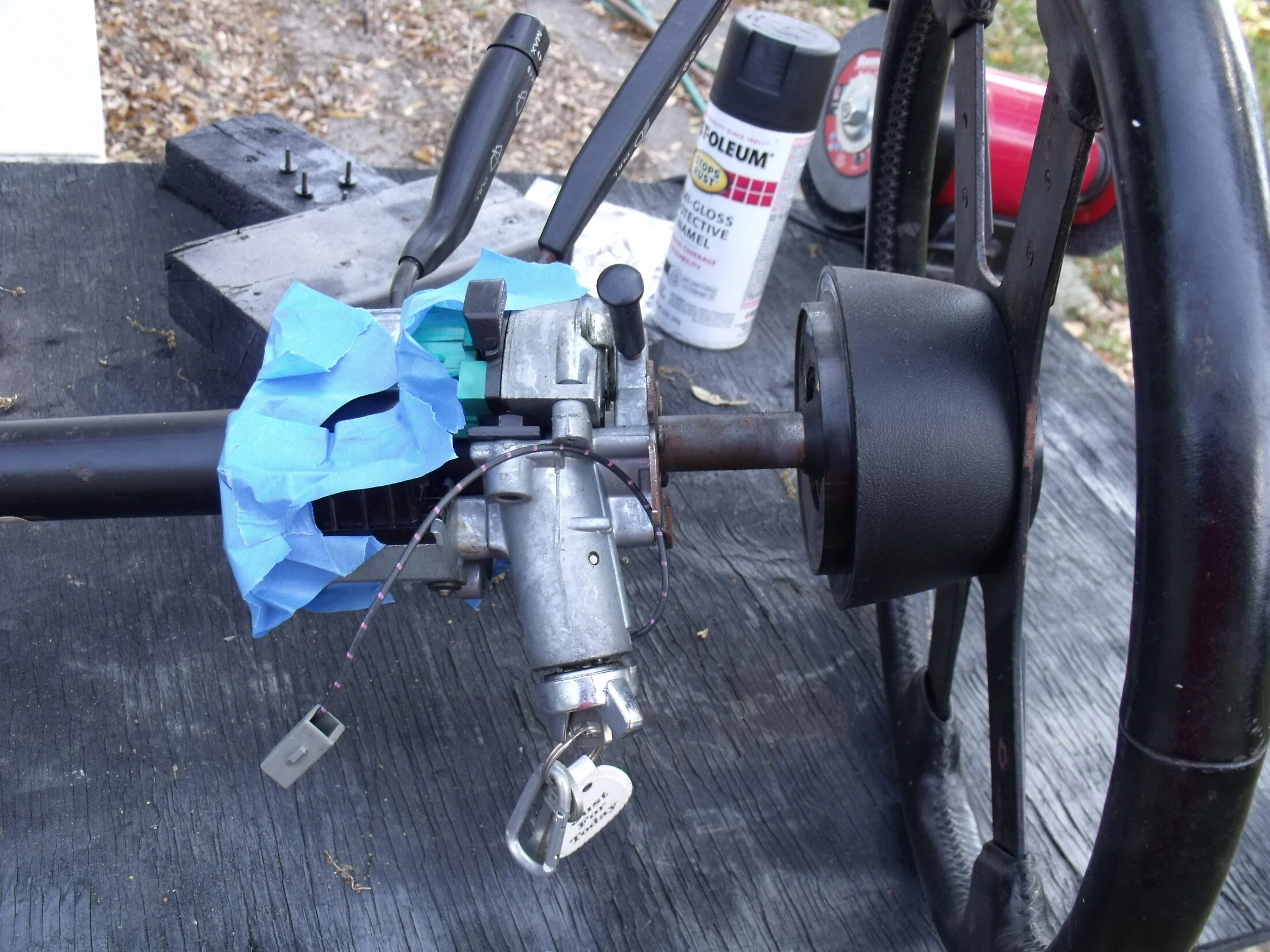

Just wondering if my 83 GLX steering column has a clock spring in it?? Doing my best not to let it spin as I prep it for paint, but I wonder if I have to be?? ... I understand most on here have new foxes....
I believe all of it including the steering wheel is factory OEM.....
Are you asking if you could damage the clock spring by letting the steering wheel turn?
It's not like a 'clock spring' that would be on a clock. You really can't 'unwind' it.
Is that what you mean?
General not sure what I mean because I have no experience with steering clock springs....
My understanding is its a way for the wiring to keep electrical contact without having actual wires to get wound up
I " thought" I had read somewhere that if you crank the steering wheel too many times in one direction or the other you can damage or break the " clock spring" ..... ?? Help me please.......
No, those have contact plates like the 89 below cars. Clock springs came out with air bags and use a ribbon cable on a spool for the electrical connection to the air bags in the steering wheel that needs to be centered when installed . its just like you center a rack because it only has so much range of motion.
