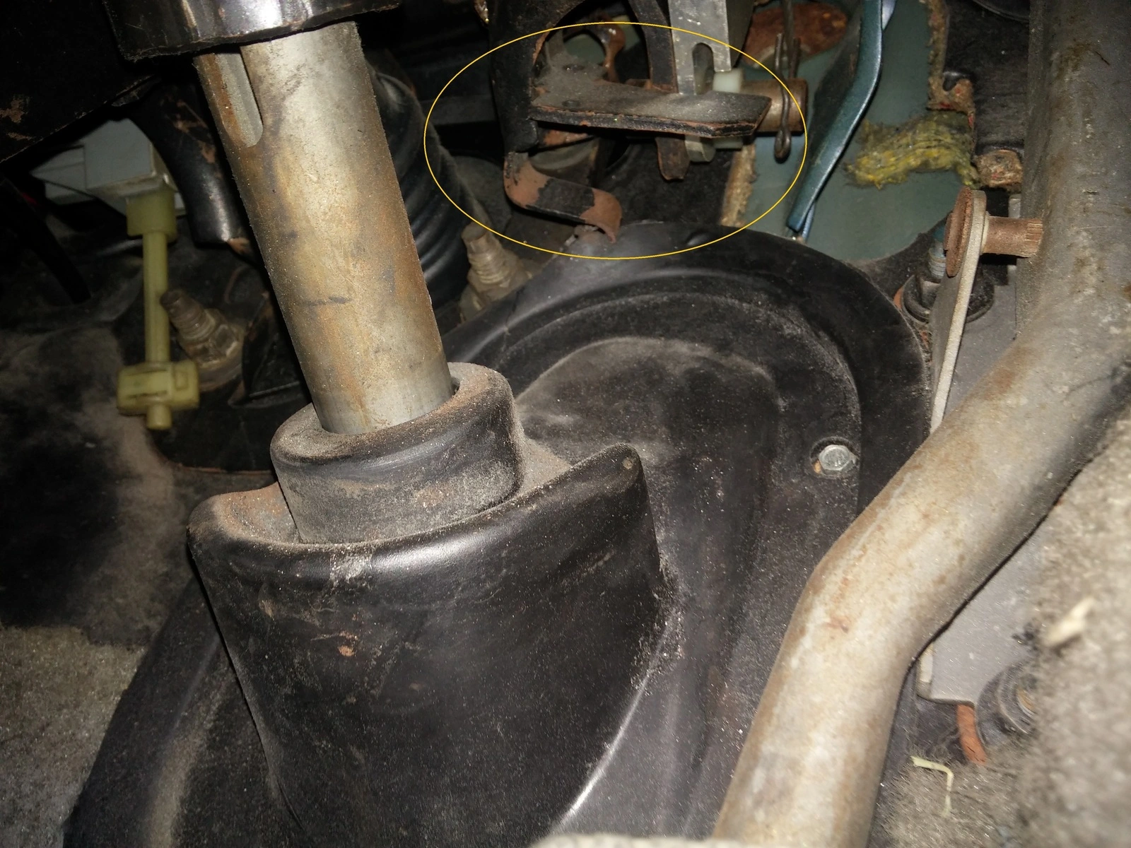

After further inspection i found a bracket up and to the left of where the steering column enters the firewall. this bracket looks like it was bent until it broke in half. I uploaded a picture. its the best i can do until i can get the drivers seat out. im 6'5" 300 lbs haha. hard to get in there.
Does this sound like the culperate behind my issue? Thank you so much in advance just for taking the time to read this wall of text!
