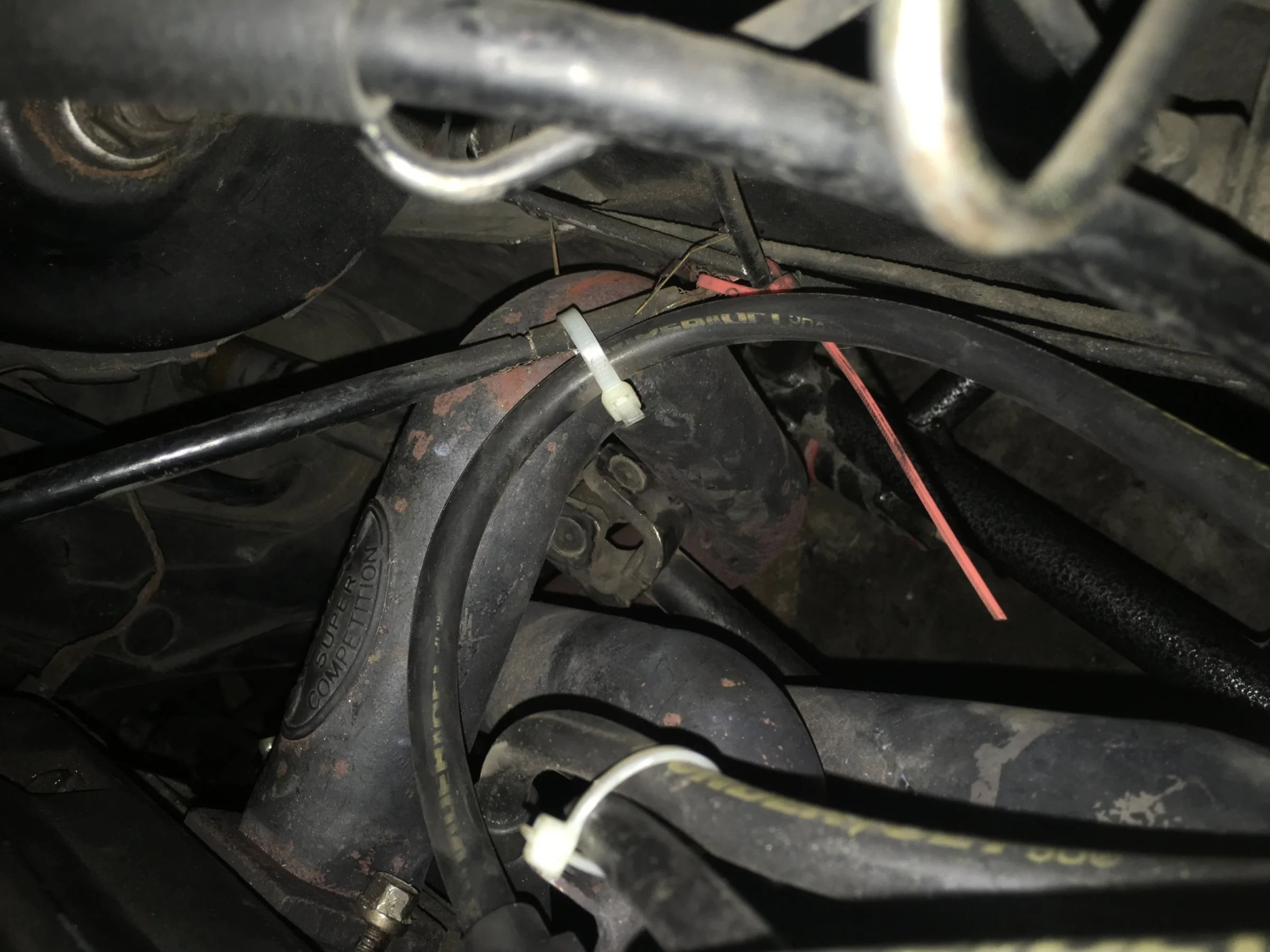

Steering/header Clearance
87hatchirv
Jan 4, 2017
So I just installed my Team z k member, and I'm running into a issue with my steering u joint hitting my ,hooker long tube header. I already tried adjusting my offset steering rack bushings but that was no help, I ordered and installed MM solid motor mounts and didn't that help either. Is there anything else I should try before hammering my header?
You can try and loosen the steering column at the firewall and shove over to gain some clearance. My hookers did the same thing. But they were shorties. I gave them away and went with BBK Longtubes and they fit great. I did use a flaming river steering shaft as well.
