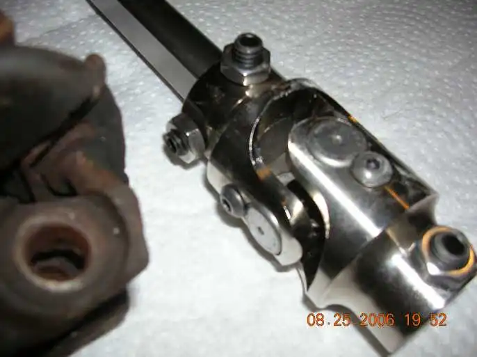

Here is how much I did the counter-sink for the screws. You can see the difference in height in the set-screws fro the side and the flat.

Like I said, that's *too close* to the massive heat from the headers for the red lock-tite to still be "safe". Also, the set-screws get dynamically changing forces since the bar will be "moving" (back and forth) as the steering is turned. The dimple by the drill size they suggest does NOT even grab the full tapered bottom of the set-screw.
To get the accuracy needed to counter sink the set-screws, I found that I *had* to use a drill press and a vise. I also had to elongate some holes a little. IMHO, if you have to elongate a hole more than 20%, DO A BETTER JOB with the first counter-sink hole!
Add ALL of the problems together, and I can see how a steering assembly can come apart even though it was assembled 100% to the spec of the manufacture!

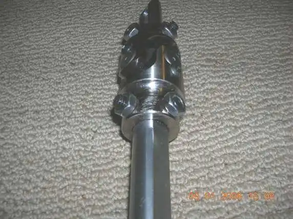

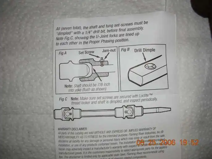

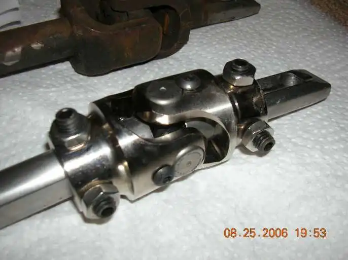

If you showed just the two following images to any Mechanical Engineering student and they couldn't immediately see many problems with the design, then I think that any University would be fully justified flunking them out of school! And, I say that as a former engineering teacher! :) Uhm, ignore the length of the bar stock. It's the depth of the screws and the flat locking nuts "locking against" the round body. Plus, the moronic very shallow depth that flaming river suggests for a counter sink. For one thing, WHY so shallow? Geez, do they know anything at that company?
Close up of the Flaming River rod and joint assembled:
Another close up of the Flaming River rod and joint assembled:
Flaming River shaft instructions:

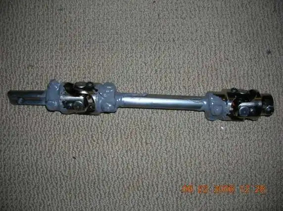

My solution to the POS Flaming River design. Compare the counter sink amount to the pictures above. Also, the JB Weld I used was has a very high temp rating (the shaft is next to the headers).
The JB-Weld job isn't pretty, but MY steering assembly is never coming apart!
IMHO, the MM design is tons better!
I think I would have just used loctite instead of that hack job you did..... :eek:
