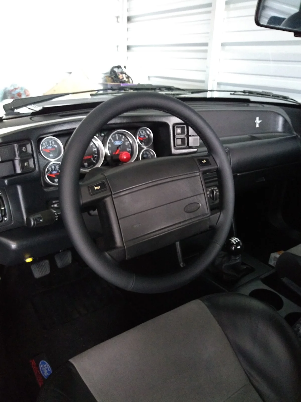

Just took the car for it's first drive since putting it away last October. I replaced the steering wheel over the winter. Now when driving straight the wheel is crooked, at about the 1 o'clock position.
Last summer I replaced the outer tie rods. I don't recall the old steering wheel being this far off.

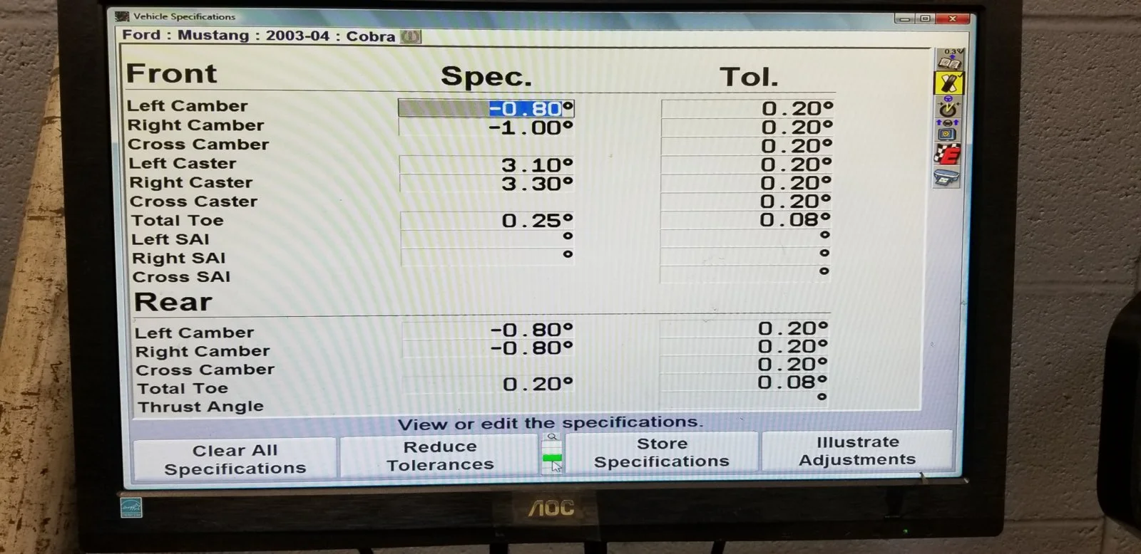

I also have a 03 cobra that's had some suspension mods. I still have the print out of that alignment. The thing handles pretty good. I wonder if I can try to have them get close to those specs?
My fox also has 03 cobra struts, shocks, and rear cobra coupe springs. But has 01 bullitt springs up front.
When I get my IRS foxes aligned I always use 04 cobra alignment specs. Depending on tire size and rim combo you may need a touch more camber in the rear.
Thanks for the help. I found an old alignment sheet that came with the car from one of the previous owners. Looks like they did a 90 mustang front alignment and a 04 cobra rear alignment. Debating on having it all to 04 cobra specs.
