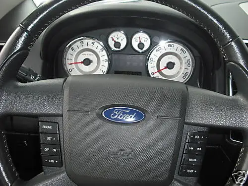

I was thinking of swapping out my steering wheel to something that looks like the mustang wheel but newer.. I like the new ford edge wheel.. Not sure it would swap out that easy? IT would look and feel awesome. Any advice here would be appriciated.

Not sure what the column post looks like on the newer '05+ models VS the SN95 wheels, but I know the distance from the wheel to turn signal lever should be about the same, since they're both airbag wheels - it's when you go from airbag to non-airbag or vice-versa that it becomes an issue. You could pretty much look at the shape of the '90-'93 wheel's steering shaft and then if you can get a pic of a newer '05+ wheel with the airbag off, you could pretty much tell at a glance whether or not it'll fit onto the shaft.
