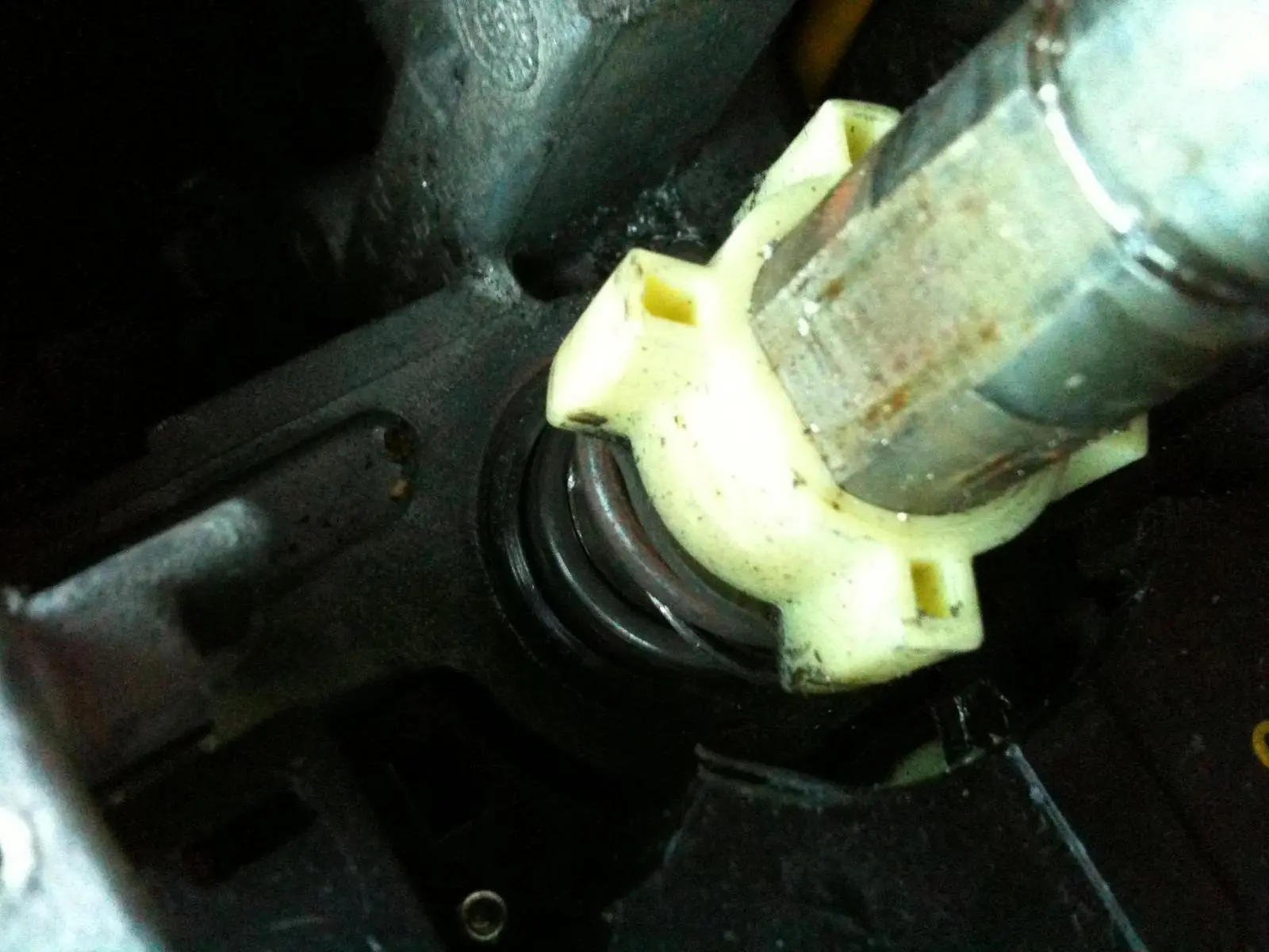

I removed the Steering Wheel and behind the Clockspring looks like there is a compression spring that is broken. Has anyone had this problem?
