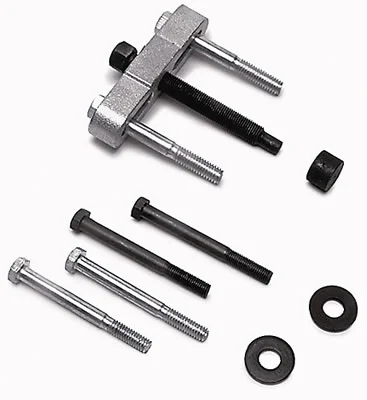

What is the easiest way to removal a steering wheel. I took off the nut. I have read where you can pop it off by hand. I tried that no help.. Ther are two threaded holes that I believe are to unseat the wheel. If these holes are to unseat the wheel, does anyone know what size bolt I should use to do this???:bang:
The holes are 5/16"-24 thread.
I didn't have to use a puller on mine, but I think a steering wheel puller would attach to these holes in order to crank down on the center shaft.
