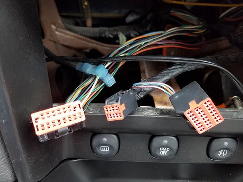

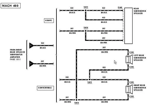

I searched for quite a while and I didn't turn up an answer. I saw a ton about the Mach 460, but it didn't answer my questions.
What year Mach 460 are these 3 plugs for? What is each plug for? My car came with an a/m stereo that wasn't hooked up right and now I'm re-wiring it. I have the harness adapter that fits the factory harness so I can hook up the new stereo, but I don't know what part number it is. I need to get the wiring chart and I want to make sure I get the right year.

looks a lot like my 2000 setup. it had main unit with tape deck (1st big plug on left) and then a cd player under it. (3rd plug on right)

Excellent. Thanks. My car is an '00, but there's so many things, besides my drivetrain, that are from an '02 on my car that I'm not sure of a lot.

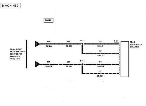

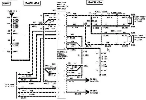

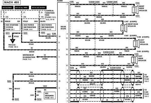

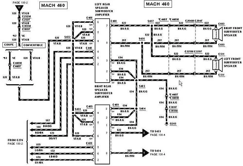

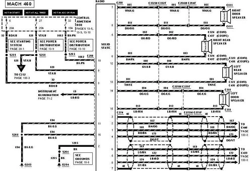

For anyone that comes across this, Here's the schematic I was looking for. There were a bunch out there, but for some reason I was having trouble find the ones for the Mach 460 with two amps in the rear. 130-2, 130-3 & 130-4

I adjusted these to remove the vert info. These should be a little easier to read for the coupe guys.
