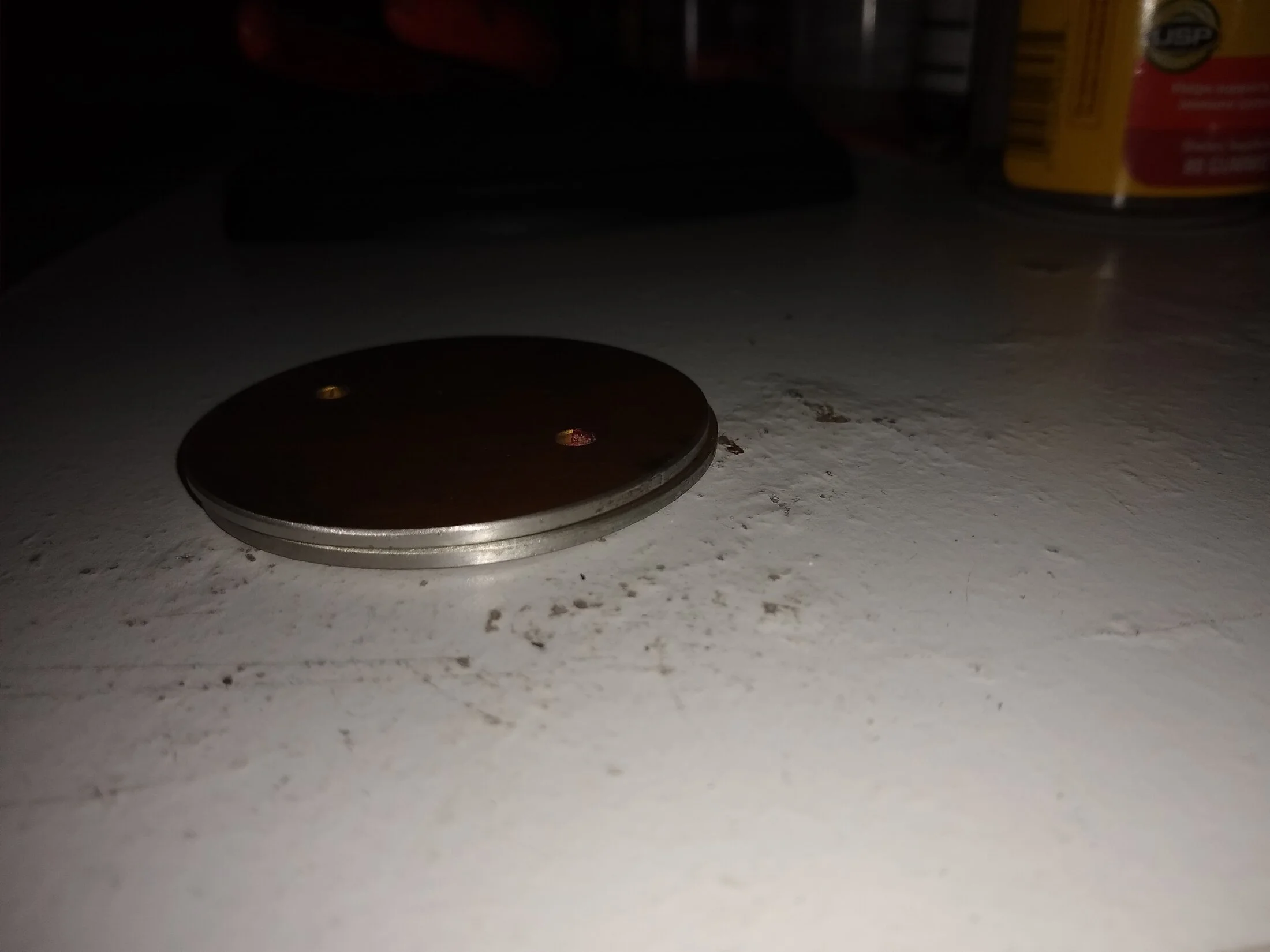

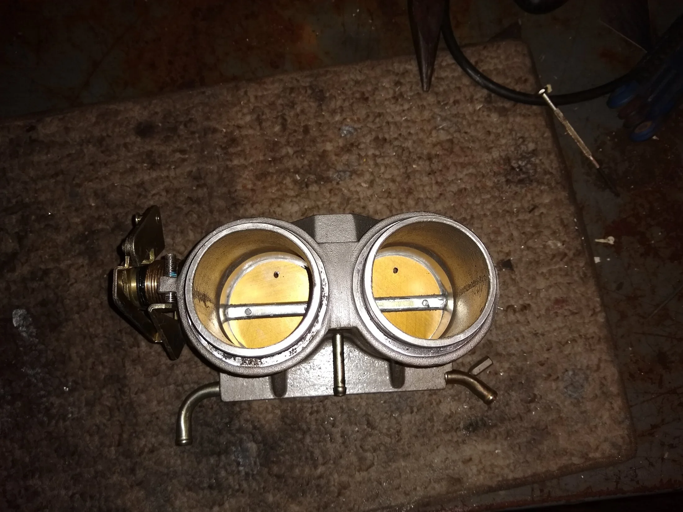

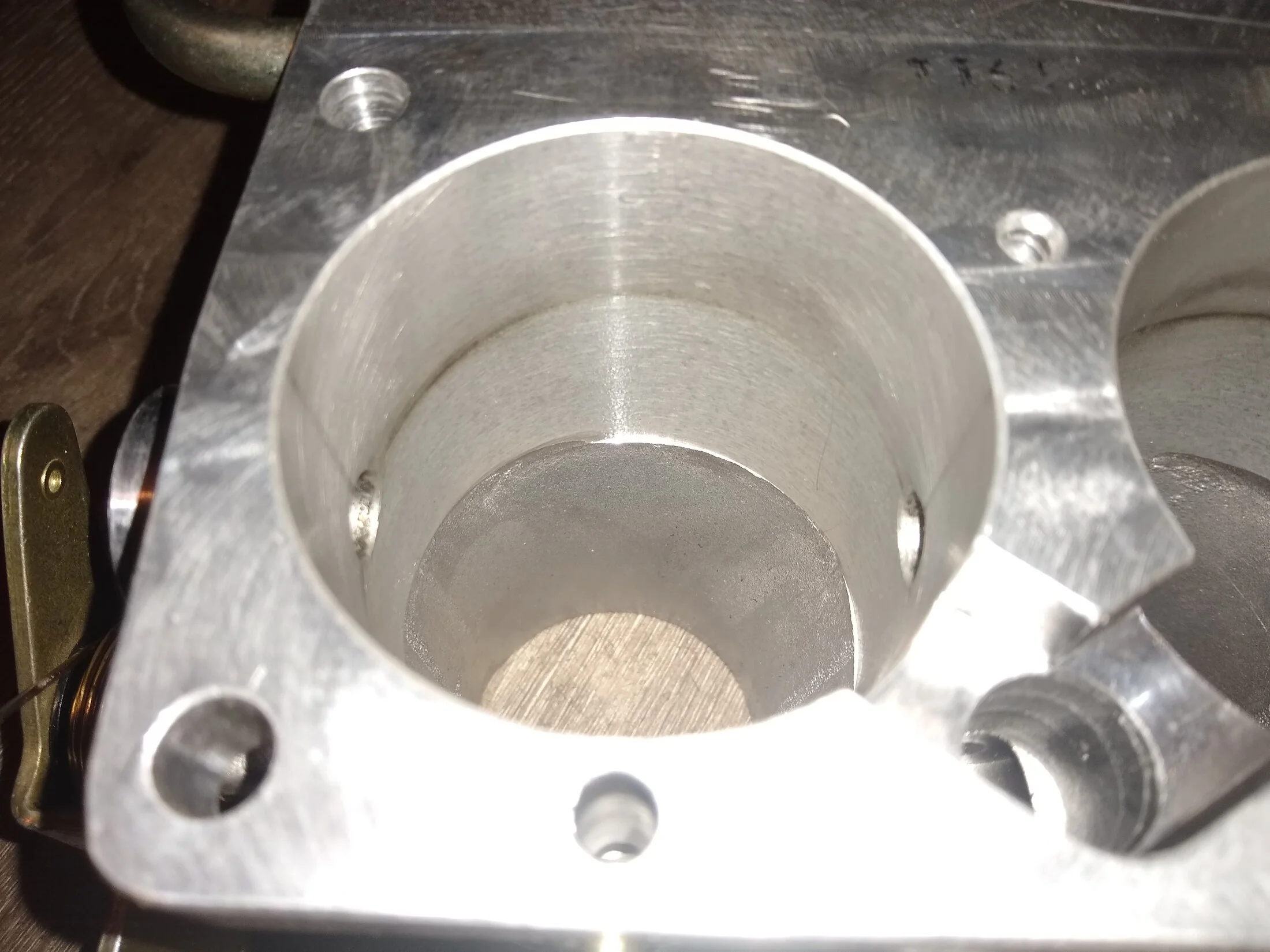

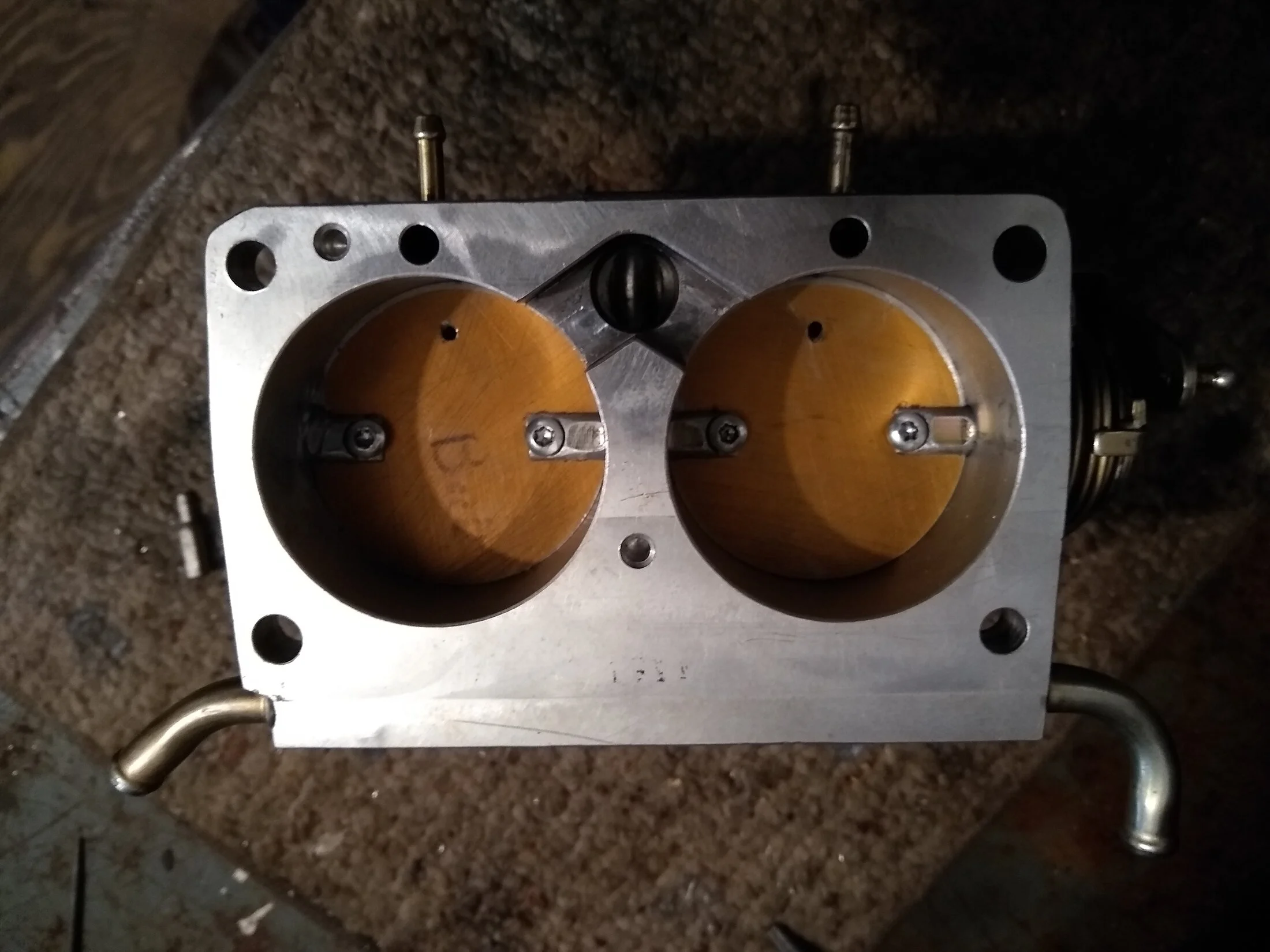

On the TB's theres a lil sticker thats says not to use carb cleaner etc to clean the TB. as theres some sort of Teflon coating inside them so I bench mine and reapply the Teflon coating with some liquid teflon and an airbrsh kit..

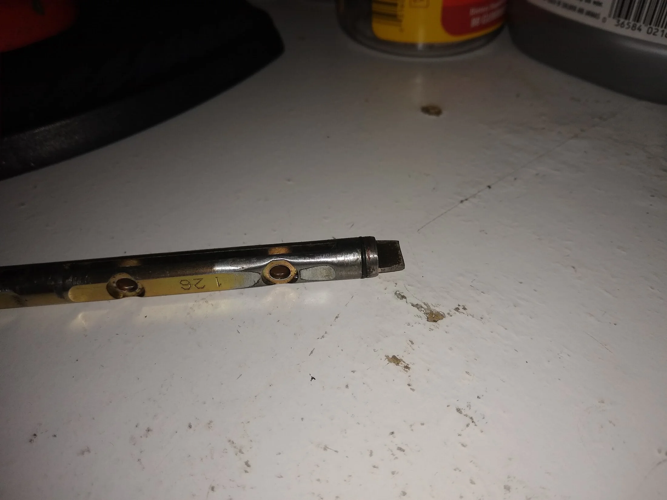

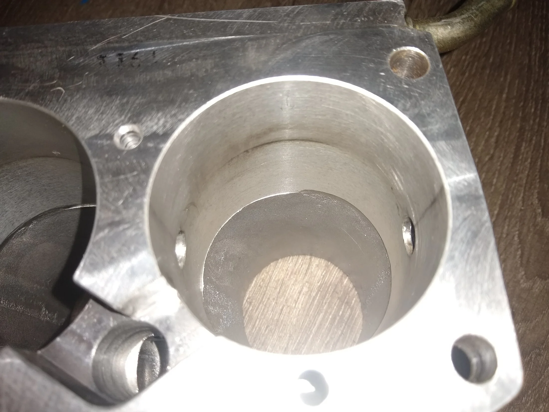

I had to do it to my BBK twin 61mm TB plus had to modify the rod that was sticking inside the body due to the discs being too thick for the slots... ..........
This TB had maybe 500 miles of some rough driving before reakizing the TB out of the box was junk and the manufacturer unwilling to take responsibility for their shoddy product they sold me .....

When my stock TB's stick is after I take them apart and thats because the discs are shaped in a certain way to work smoothly with the angle they sit at.
What I do is I hold the TB up to the light to see how much the disc is off with the TS screw all the way out and If I see lots of light around the flap or flaps I bench the TB then I slightly loosen the screws holding the flap or flaps then using the back of a screwdriver I tap the TB blade to realign it to the TB bore/s better then I rotate the throttle to see if its still sticking and if its not I tighten the screws and retry....

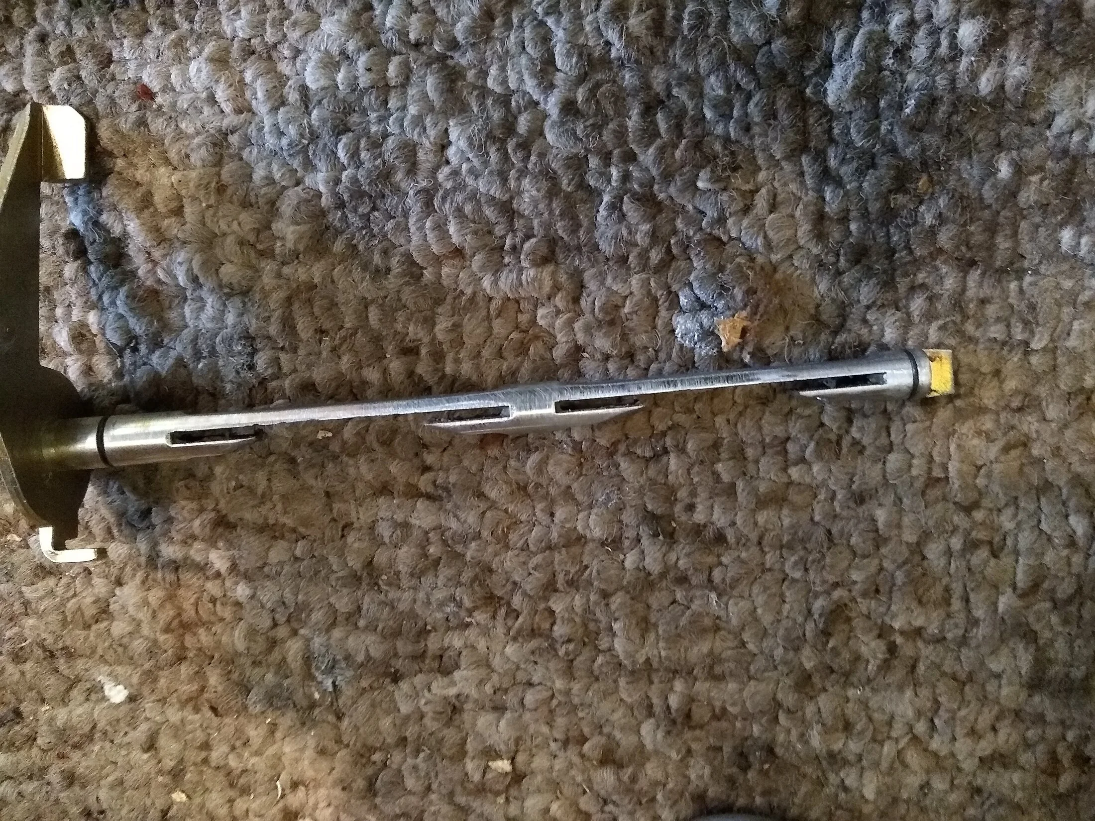

I even had to take apart my new BBK to make it work right//. They put anodize on the throttle blade rod and it added so much it added to the throttle sticking so I removed the anodize plus sprayed it with Teflon. I also softened up the edges of the discs and sprayed them too.
Its been 4yrs since and not a single issue.................LOL
