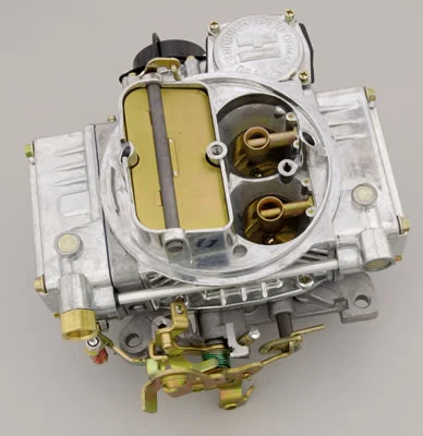

My 600 is doing the same thing on my 66. It never did it before I got it tuned and after I got the car home from the dyno (only revved it to 5000) I took it on a quick trip to the store and it sputtered and died. Took a little to get it started again. Limped it home and watched fuel pour out of the hole shown in this picture:
Called the dyno shop and he said it was a float sticking and to tap the side of the carb with the wooden handle of a hammer. He said it's normal for a new carb (mine's rebuilt) and it takes some breaking in but it'll stop. So I tap on it and sure enough it runs like a champ and away we went. My wife was not happy about taking it. She was right, it happened three more times before we got it back. I about beat the ***** out of it the last time.
Should I try to fix it myself or get another carb? I've swapped engines, transmissions, rewired the car, so I could probably do it but I have to wonder if it's worth it. I bought it rebuilt but who knows how good it is.
D Hearne makes a good point. It may just be a dirty needle/seat which is very common. Get a Holley book. This is pretty easy to clean/repair.
Are you sure the shop just didn't adjust your float (floats) too high? Before I tore it apart, I'd adjust it (them) down and see if the fuel stops coming out the top. This adjustment should be in most any manual.
Whichever side is pouring gas, loosen the nut (I think its 5/8") with the large screw in the center that sits on top of the float bowl. You might measure how high the screw is off the float body and write that number down before you go adjusting. Anyway, loosen the nut and turn the big screw clockwise and see if the fuel stops pouring. Do this all while its running by the way. If it stops, you'll need to do a more precise float adjustment that's covered in the repair manual. I don't have time now to explain, but try adjusting the float before you tear it all apart. Also, depending on how much fuel you've dumped into the carb, you might want to change the oil and filter. That gas has been pouring straight into your oil pan.
oh. never seen one of these in real life before. You shouldn't need a regulator on a mechanical fuel pump system. Do you have an electric pump? Try popping the bowls off and see if you don't see debri in there. Look at the needle and seat and see if these is anything in there. If anyone used teflon tape in your fuel line, you'll probably find it in your needle and seat. Just loosen those four little bolts on each side and peak in. Worst case, you'll have to buy a couple bowl gaskets. Advanced, Autozone and Pep Boys all sell them.
